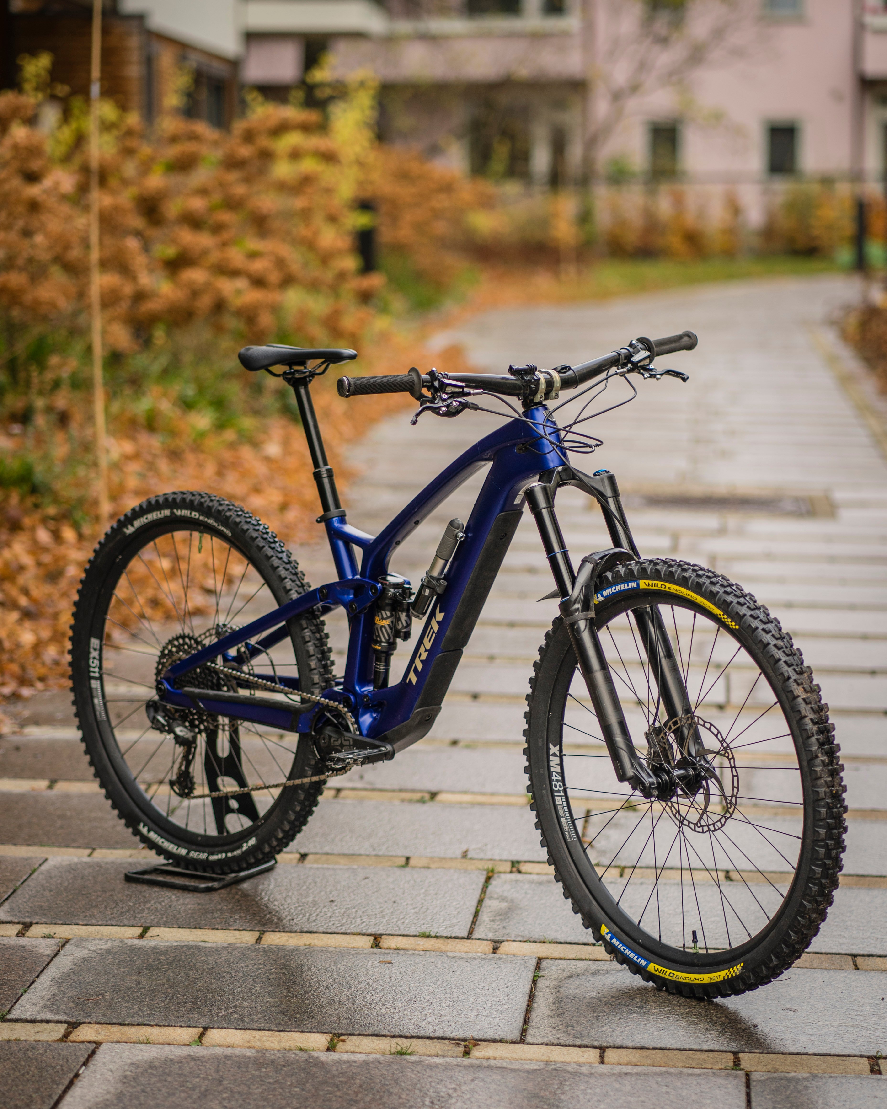

Just put in an order for a 9.5 as I got it for dirt cheap I wanted black, but only blue was available and for that price I couldn't let it slide. Can't wait to get on it and back into shape.
Will be swapping over all the parts from my meat-bike (Revel Rascal) so I'll be running the following:
Matte Invisiframe on order
  • Öhlins RX36 m.2 150mm, but will bump it up to 160mm
  • Rental Apex stem
  • Bontrager Line Pro Carbon bars
  • Sensus Swayze lockon grips
  • Hope E4 brakes
  • Hope Pro4/DT Champ/DT EX511 wheels
  • Michelin Enduro tires
  • CushCore inserts
  • SRAM GX drivetrain
  • OneUp V1 dropper
Actively looking for a shock upgrade on the used market here in Norway. Considering bumping up to a 205x62,5 shock.
