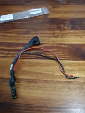

The list is very long and I don’t feel it’s a reliable option if people want their bikes to last and also the claims against someone who supplies a cable then you connect wrongly and cook motor or batteries.
please see attached image of a so called option. Clearly this lead has suffered high temperatures by the condition of the leads. D923B643-60C2-4862-A822-F026994E53C3.jpeg
Does this extender kit break the guarantee?
Invisible to the bike electronics and should be removed in case of inspection etc
