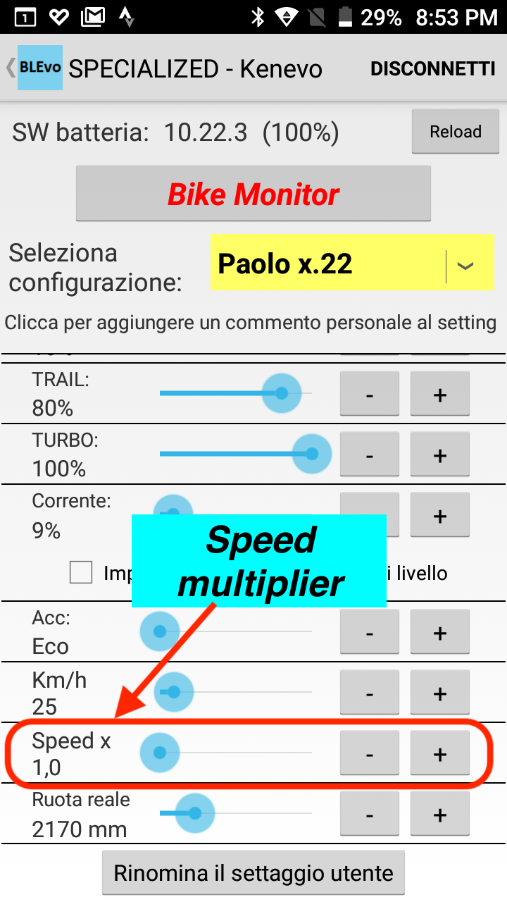

- Added the Speed Multiplier parameter to be able to use the bike sensor with a speed reduction system (see attached image)

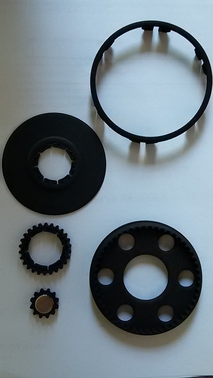

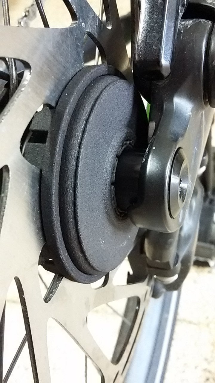

I am using the LSS planetary gear magnet system to give 1 magnet revolution for each 1.5 wheel revolutions. Will this speed multiplier correct the speed and distance from the bike ? Right now I just set Blevo to always use GPS data. Thanks 20190619_140958.jpg20190619_183054.jpg

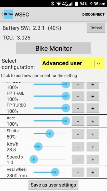

Thanks for the great app, the data collected is very useful for evaluating rider effort, etc. I am having difficulty when changing user settings when switching between saved sets, for example user 1 and user 2. Often it takes 3 attempts of choosing a set from the drop-down menu for the settings to be correct instead of being partially correct and showing "advance user" in the menu window. Also it seems that the speed multiplier effects all sets of settings and cannot be different for different saved sets. I am using the android version on a Samsung Galaxy s5 mini. The bike is a 2019 Turbo Levo Expert, TCU 3.025. Thanks in advance for any help on this.
The speed multiplier is a unique setting.
For user settings, it depends how many changes there are between one setting and the new one.. Some time not all the parameters are written at the first time...

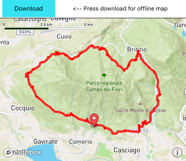

I'm happy to notify the new version 3.5.0 of BLEvo for iOS.
Offline maps are now available!!! You can find it in the GPX menu.
These are the news:
- Added MapBox offline maps
