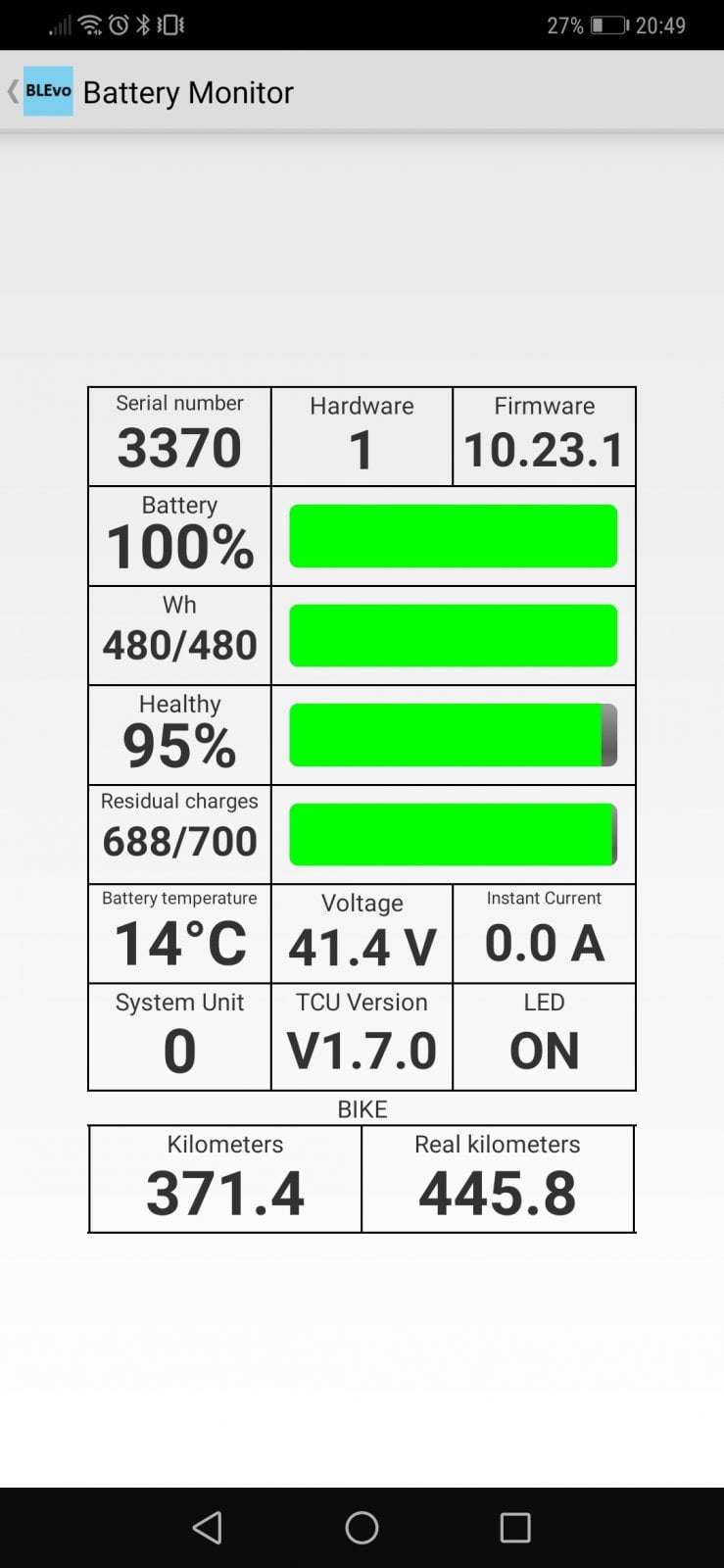

I recently purchased BLEvo to use with my 2019 Kenevo Expert. What a difference it made using smart power mode. I did however burn through battery at a higher rate so I might need to tweak the settings slightly.
I have a question that you might be able to help me with. BLEvo offers me much more insight that Mission Control. The battery monitor is showing the battery capacity at 480wh and 95% healthy with only 12 charge cycles. Is that correct / expected to drop 5% health after only 12 charges? Mission control shows 100% health.
Mission Control says always 100%.. I don't know why...
The Wh are not 504 due to the health of the battery..
