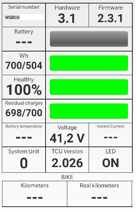

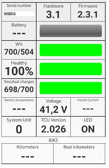

The firmware version is on the bike, but if you read all the parameters yesterday, the Android version permits to see the previuos value.. Enter in the bike setup and send the screenshot..
Hi,
here is a screenshot with blevo connected:
The Bikes de restricted with this version.

Just for you to know. Content of Battery status page is loading very slow. And I can't get all the information to page. Every time some of the items are not loaded. I asked earlier about battery capacity, Now it shows 700/504. But I don't mind this battery status page. Bike monitoring is working without any problems. Great app!
Hi Paolo!
I will check about the slow and wrong value..

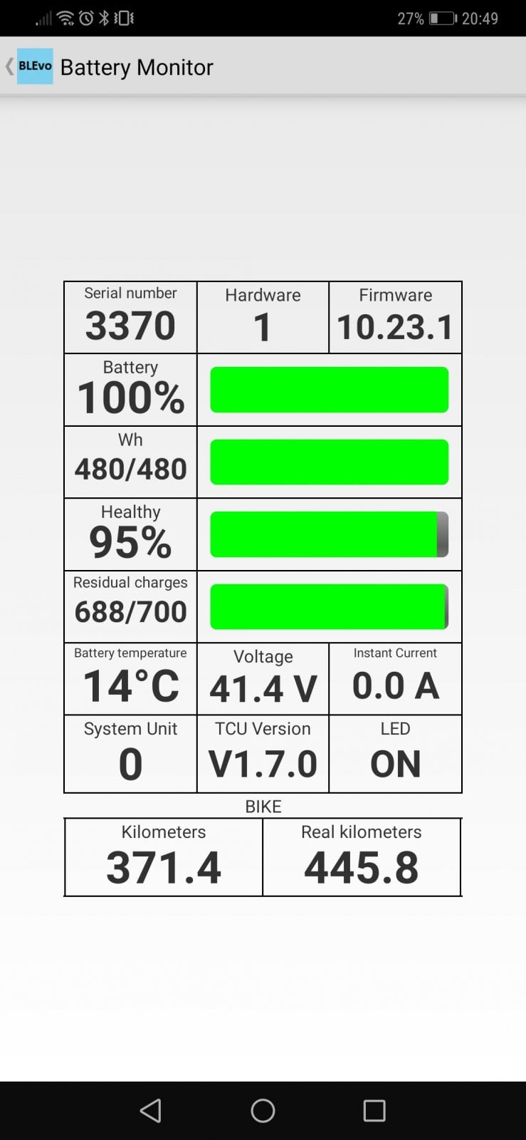

I recently purchased BLEvo to use with my 2019 Kenevo Expert. What a difference it made using smart power mode. I did however burn through battery at a higher rate so I might need to tweak the settings slightly.
I have a question that you might be able to help me with. BLEvo offers me much more insight that Mission Control. The battery monitor is showing the battery capacity at 480wh and 95% healthy with only 12 charge cycles. Is that correct / expected to drop 5% health after only 12 charges? Mission control shows 100% health.
