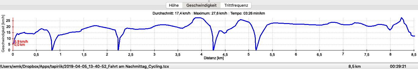

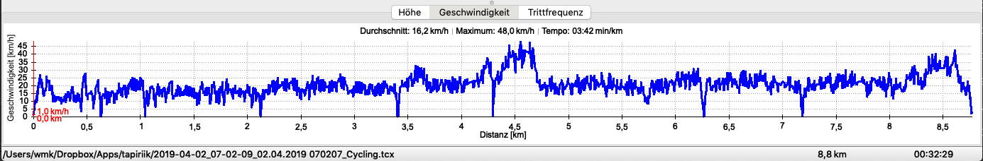

The tcx-files from BLevo are 5-6 times bigger then the one of my Garmin Edge. (See the pictures). The first is from my Garmin, the second from BLevo. Both show the speed-diagramm of the same track. It seems, that BLevo measures speed and other datas much more often than my Edge. If so, it would be fine, BLevo has a function to reduce the amount of saved data. The two examples have a size of 144kb (Garmin) and 1,1 Mb (BLevo).
Hi.. in the next version I will reduce the data saved on TCX.. but why you want to reduce the quality of the saved data? For small size or something else?

Looks like the garmin one is much smoother, perhaps some averaging is going on.
The Garmin is smoother because there is an average filter on the speed... Ok I can add the filter, but I prefer to use the real data.. the filter should be done by the visualizer, not the recorder..
