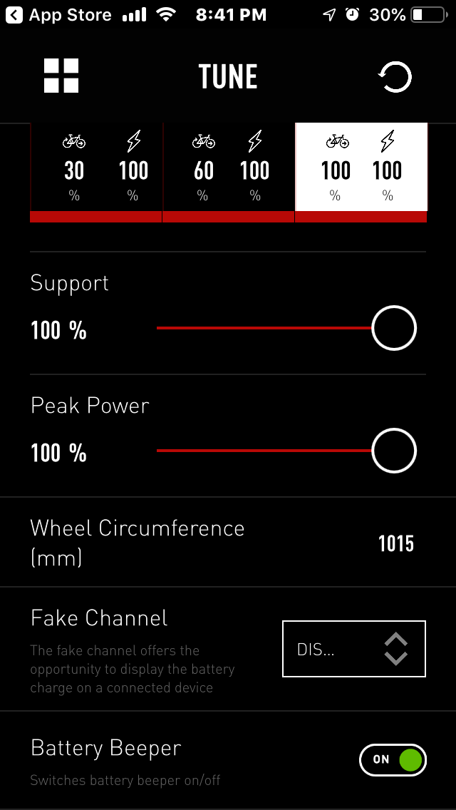

aloha fellow BLEvo’ers! i am taking my bike in for service soon. i want to take the precaution of restoring my factory settings. should i use mission control? is there a manual reset? it’s a 2017 levo. any help would be great. i have read this entire thread, and i remember it being discussed, but i don’t know what to search nor do i recall the preferred method?‍♂️??
for 17/18 levos there should be a reset to factory settings button in MC
Yes it's a circle arrow in the upper right side of the setting's screen. It doesn't change the wheel size so my advice is to set the wheel size in BLEvo to something like 2250mm or 2300mm (depending on the value you had befor moving to BLEvo) and then connect MC and do the reset.
You are right. But in BLEvo shouldn’t you set up correct (manufactutre) speed limit as well (in Poland 25 km:h)? Because otherwise if you have speed limit set to for example to 40 km/h in BLEvo and you set correct wheel size in BLEvo to for example 2250 mm, BLEvo will set up diffrent wheel size in Levo’s hardware.
So in my opinion to reset levo you should:
In BLEvo:
- set up correct wheel size - in my bike 2250mm
- set up correct speed limit - in my bike 25 km/h
In MC:
- reset bike.
Am I correct?
In BLEvo:
In MC:
- reset bike.
Am I correct?
Yes, you are correct!
in my experience just doing the factory reset in MC will also reset the wheelsize to what spesh think it should be.
Have you tried doing the reset and see what happens?
@RobertK Yes you right !
@ccrdave Tried it last saturday with latest version of MC. No it doesn't... The value was 2300mm in MC, I switched to BLEvo and set it to 2175mm. Then moved to MC and reset the value was still at 2175mm. Then got back to BLEvo, set 2300mm, moved to MC, reset and everything was on the screen like after my update in the LBS one week ago. Hope that make sense... It was just to check if I can go back to the initial settings.
Thats ok as long as the setting in MC is more than 2000 its allowed by spesh in MC
From where MC „knows” wheel size to which it should be set up? Your solution will work if you didnt change wheel size in BLEvo. Otherwise I have no idea how MC guesses wheel size of your bike. Am I right or wrong?
Ok. There may be default settings in MC. But in my bike it didnt work. I had to change to correct wheel size and speed limit in BLEvo and than reset in MC. You have to remember that only one app can work not two aps parelly.
I think you are wrong, i had 2017 levo and 2018 levo and when I used blevo or another app to set the wheel size below 2000 it always came back when i reset to factory.
that was with old MC the new app may be different,
does the new MC allow you to change wheelsize down to 2000? factory reset should set the wheelsize to 2250 if I remember.
you can try this
set the cut off speed in bleveo to say 40kph
look in MC and note the wheel size, should be 900 or something
now do factory reset in mc, wheel should now be 2250 or near
if not then set cut off in belevo to 25kph and do mc reset again
now all parameters will be legal in MC
I hope :)))
i forgot to say im sure you know but when you do a factory reset you must turn the battery off then on for the changes to take effect
you can try this
I hope :)))
In BLEvo:
In MC:
- reset bike.
Am I correct?
In BLEvo:
In MC:
- reset bike.
Am I correct?
yes that should work

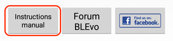

I updated the user manual of BLEvo for Android to the latest version with the explanation of all the new features added.
Many thank to my friend Erik for his patience in reviewing the manual and for helping with the English translation.
Remember that the manual is always accessible from the button in the main menu, as shown in the screenshot.
Here are the links to download them.
Manual in Italian:
English user manual:
Enjoy your ride with BLEvo.
