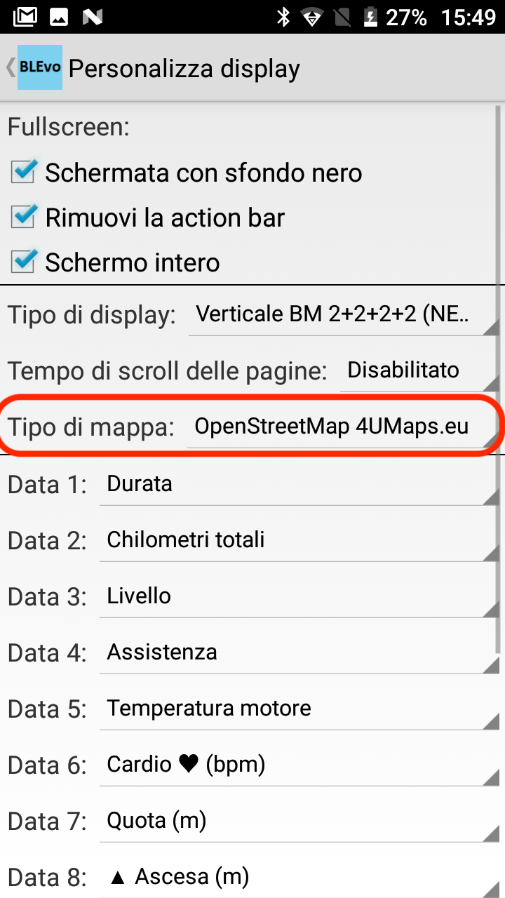

Can I use open cycle maps with blevo? Cheers
For now no, because I saw that they are not for free.. I'm trying to add the OpenStreetMap. The 4umaps.eu map seems to be good for mtb.
Thanks. Just asking as they show, at least for New Zealand, the available trails making planing a day easy, especially if I get off track.

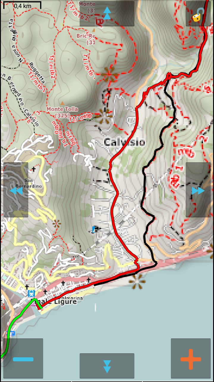

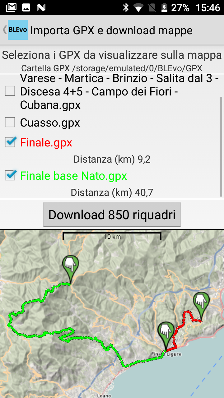

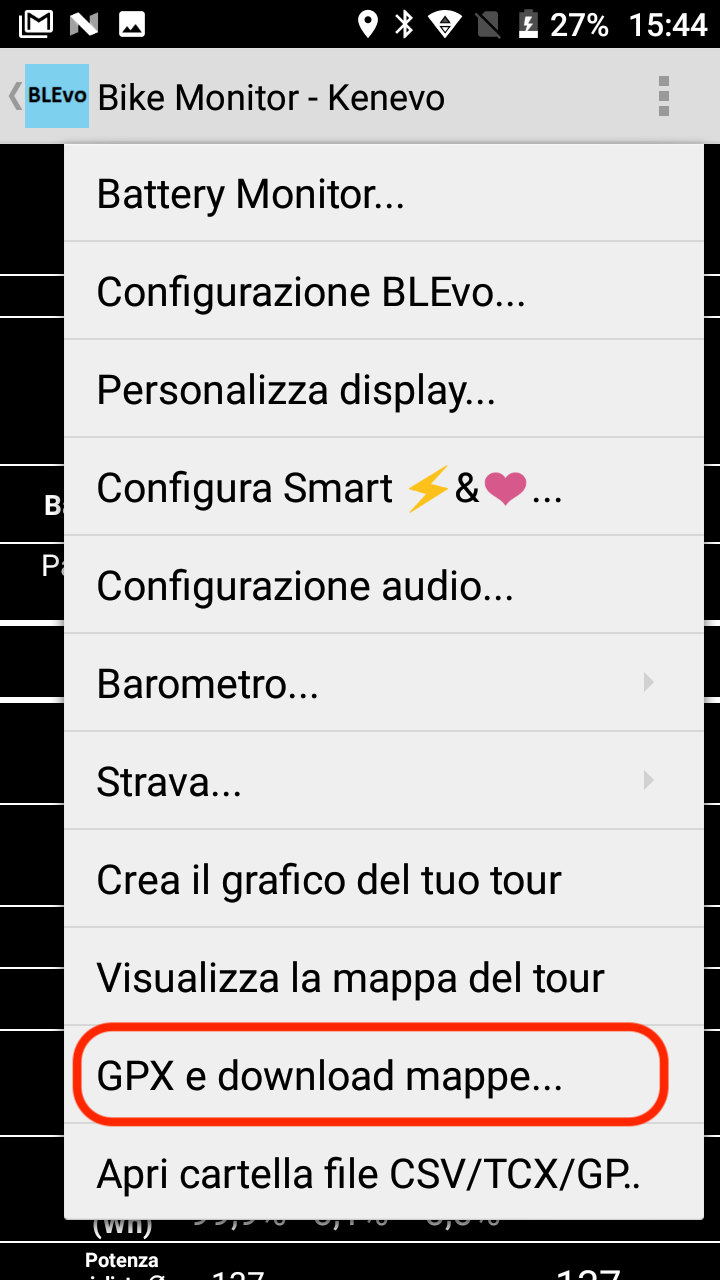

The new version 3.3.0 of BLEvo for Android will soon be available online with the new map functionality. I will soon make a video to explain in detail all the added features. For the moment, play a bit and let me know what you think.
Here is the complete list of news:
- Added maps in the bike monitor
- Added the ability to add more GPX on the map
- Adding offline map management
- Bugfix: Restore the connection status in the bike monitor
I remind you that the maps can be imported with the following ways:
- saving the GPX in the BLEvo / GPX folder
- connecting the phone to the computer and putting the GPX in the BLEvo / GPX folder
- from an attachment of an email choosing BLEvo as an application for the GPX
I am attaching a bit 'of screenshots.

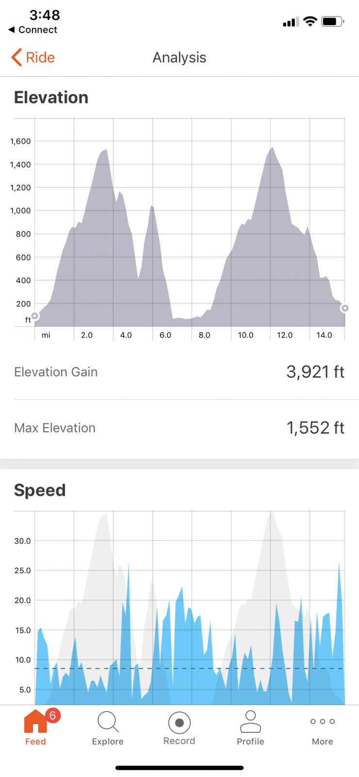

So I’ve had my brand new 2019 Turbo Levo out for 2 rides now. 1st ride, no Blevo, 2nd ride Blevoed! Best 9 dollars I’ve ever spent.
I have a couple of questions about getting the most out of my motor though. We were climbing very steep single track, at close to the limit of what I think will be possible. My friend has 2019 Giant with 27.5 wheels. Clearly the Levo is 29. He seemed to be able to climb steeps much easier with his bike. When it was a more moderate grade we were about even. On flats my bike was clearly faster. On non ebikes we are about equal.
1. Are there settings we can change that will improve the climbing power of the motor? Do you think it is a function of wheel size? I think with practice I can improve my technique, but the difference in the bikes “potential” to climb was clear.
Also, I noticed it was much easier to get started again on steep grades on his Giant bike. Several times I just couldn’t on the Levo, and had to hike up to get to a flatter section before I could get going again. These were very steep sections of trail but again the difference here was clear. His motor seemed to have more immediate support and less tendency to abruptly shut off when the pedaling slowed.
2. Can we tune how quickly the motor gives support and provide a more gradual taper off of that support?
It’s not all bad news for the Levo owners though. The 700Whr battery was the clear winner at the end of the day as I could have managed another full climb and his battery was dead.
The very steep section I’m talking about was the shorter 2nd peak.
