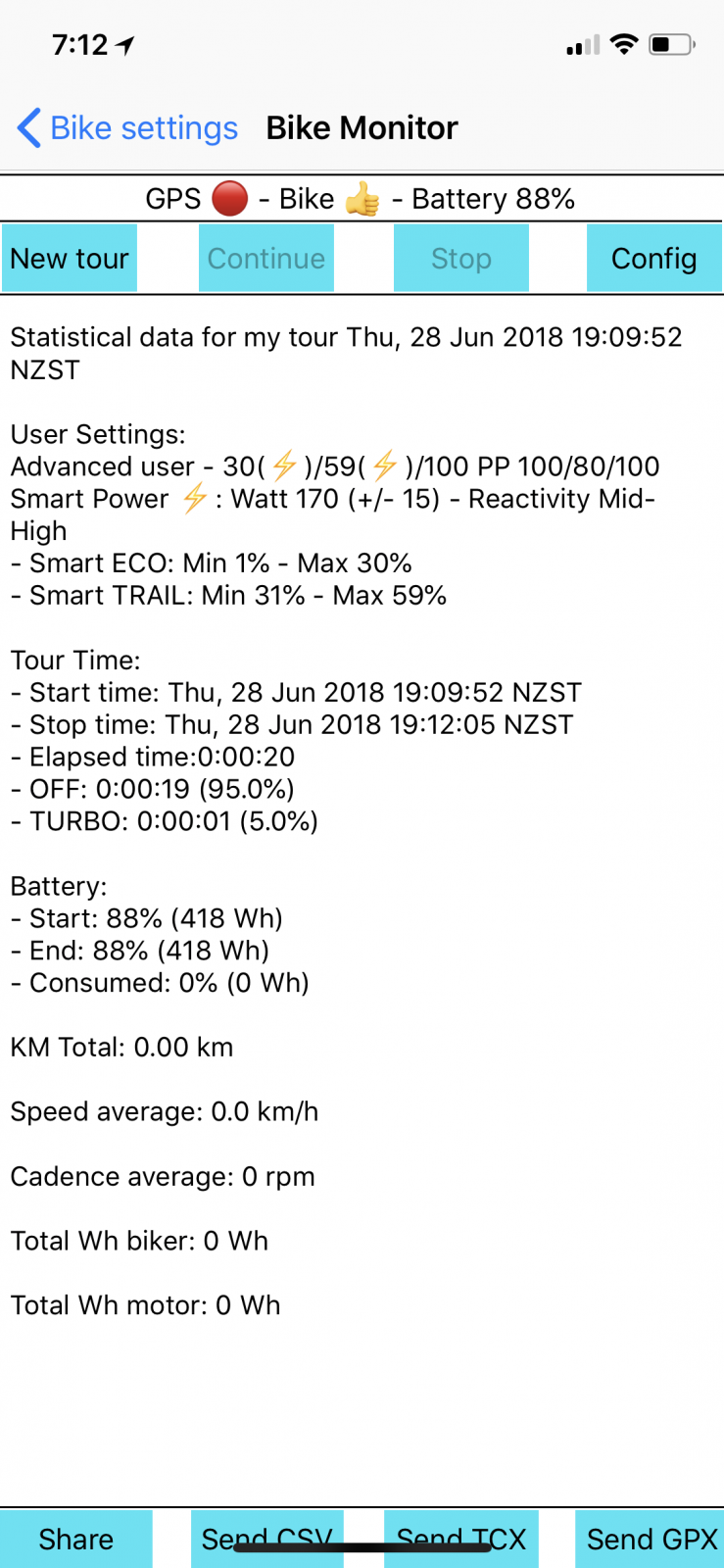

If I am on the "Bike Monitor" and press either the "Send CSV", "Send TCX" or "Send GPX" buttons then I get a black screen, the application exits, and I'm returned to the home screen.
I've checked in the "Files" application and I can not see any files created by BLEvo.
Where can I access the files after they are created?

Just tried another short tour after reinstalling the app and connecting to the bike. Same thing. The app crashes when I try and send files
Sorry but I think there are no data in the file..
20 seconds without GPS coverage...
Could you try to do a real tour? At least 5 minutes..
In any case I will check your crash.
