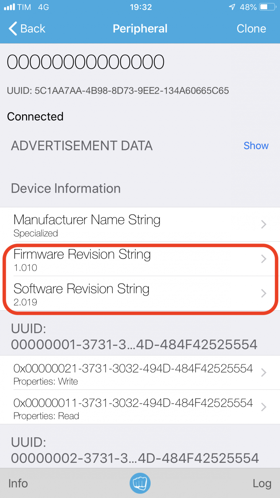

How do you find out the TCU? Looked on light blue and can't see anything that matches that.
I'm releasing a new version of BLEvo in order to check quickly the TCU version.

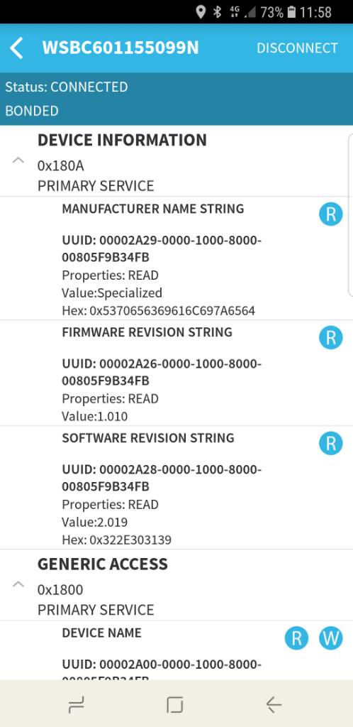

You can connect with loghtblue and check the firmware version

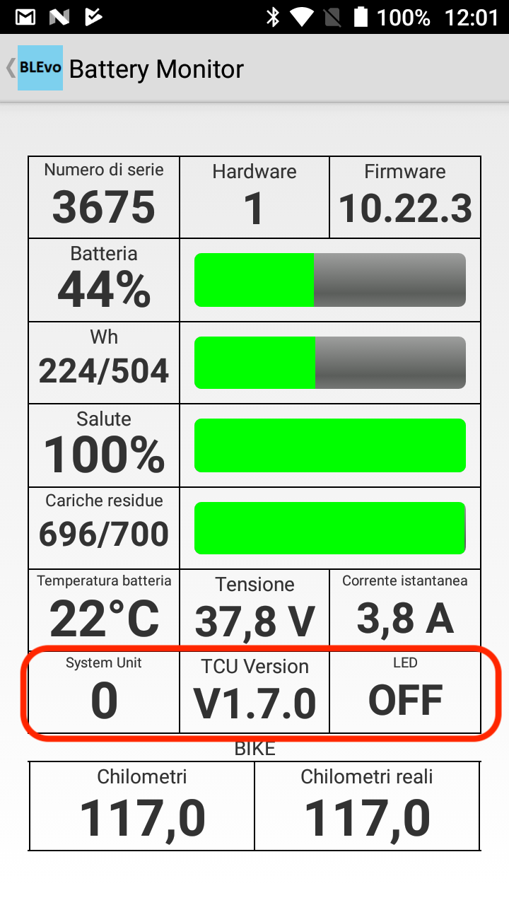

I just released version 3.0.4 of BLEvo for Android.
The version of the TCU can now be checked in the battery monitor. From the various tests done, it seems that if the version of the TCU is 2.019 (for the Levo 2019) the wheel circumference is modifiable. Instead if the version is 2.025, the wheel circumference is NOT changeable. The "old" Levo / Kenevo will present the TCU version V1.7.0.

I can't find TCU under any of the options in light blue.
its the software version, I would say your bike is modifiable

My 2019 Levo is:
Motor 6.1.0
Firmware revision 1.011
Software revision 2.025
The speed adjust slider works but when bike is reset, returns to it original position so does not work.
You mentioned wheel size which defaults at 2255 (I’m on iOS)
I understand that the speed adjust will not work at this time.
Are you saying that the wheel size can still be changed to ultimately over ride the speed restriction i.e. pretend the wheels are smaller?
