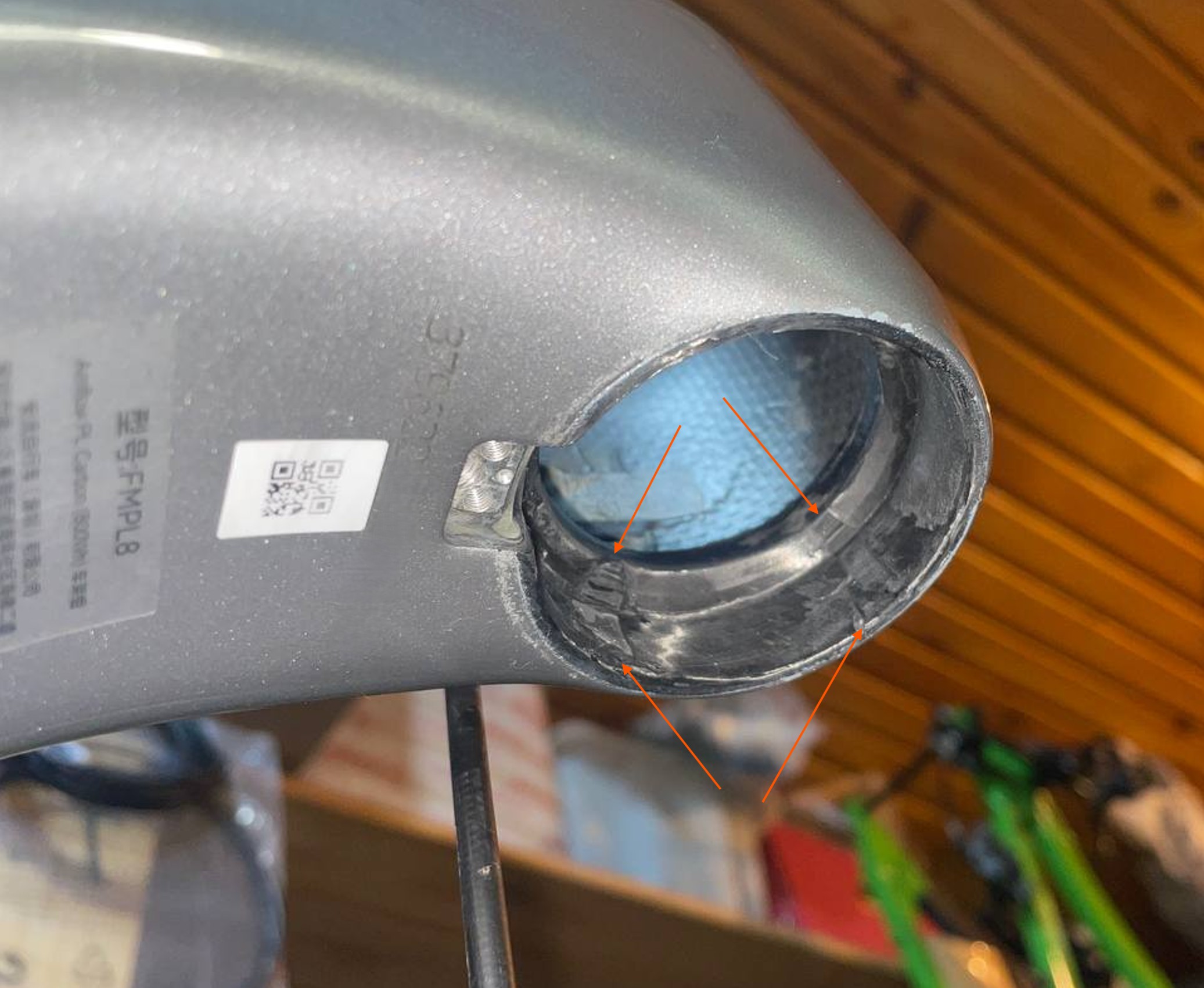

after Jam changed forks, and admitted to a loose headset, cracks developed. Case closed right there. Period.
Factually it does not matter how or why the cracks developed because the loose headset "could have" caused them.

Even worse then, an integrated headset where the bearing isn’t supported 360 degrees is asking for trouble. See the other headset pics with random carbon layup.

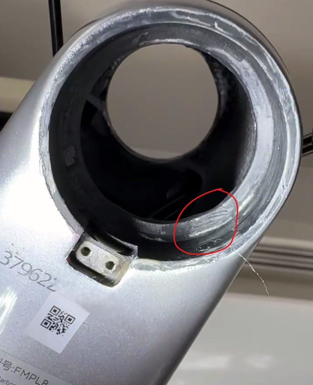

Not that I want to get in the middle of your love fest with Winford but yes, the only 2 pictures I've ever seen of their headtube show terrible QC and can certainly cause the issue, but AMflow has an out because the OP messed with it prior to contacting Amflow. Whoever did the fork swap should have stopped as soon as they saw that terrible craftsmanship and reached out to Amflow.
If I had their bike I'd take a look at my cups today and if they looked like the 2 I've seen I'd ask for a replacement or acknowledgement from Amflow to support any warranty claim in the future.

This frame was factually abused so bad, the stem cap was dented. I see chips in the CF that would be alarming if no work had been done to said bike. It looks like someone used a screwdriver to pry the bearing race out. Probably not the case, because it also looks like a hammer was used to reseat the race.
Now we have stated from the beginning the crack need to be investigated further, it could be paint and filler, and or CF. None of us know and at this point it does not matter.

Your honestly comes into question, because you did not tell anyone about the backlash in your OP. We had to drag that out of you. And that is some serious hiding of details on your part. It does not make you look good. And a few people that dislike me chiming in, wont help you with a bogus claim against Amflow
I told amflow support about the fork replacement right away. They themselves wrote that a fork with 170mm travel is allowed.

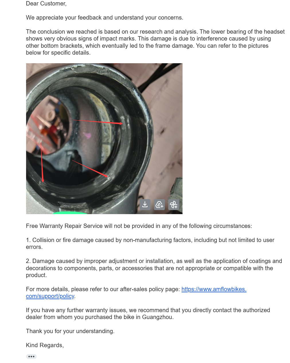

My complaint with amflow is that they pointed out some damage in the bearing area that is not damage. These marks are there even on a new bike and I was surprised that their engineers don't know about it.
That remains unsubstantiated. Had you started this thread with pictures of yours and pictures of another bike with similar marks would have been a better way to start your thread.

My communication with support was long and fruitless.
First, I spoke with support, then I was transferred to customer service.
But the result is the same: it's my own fault that cracks appeared on my frame.
No matter what I write or suggest to them, they insist that their engineers are 100% certain that these marks on the frame are the result of replacing the fork!

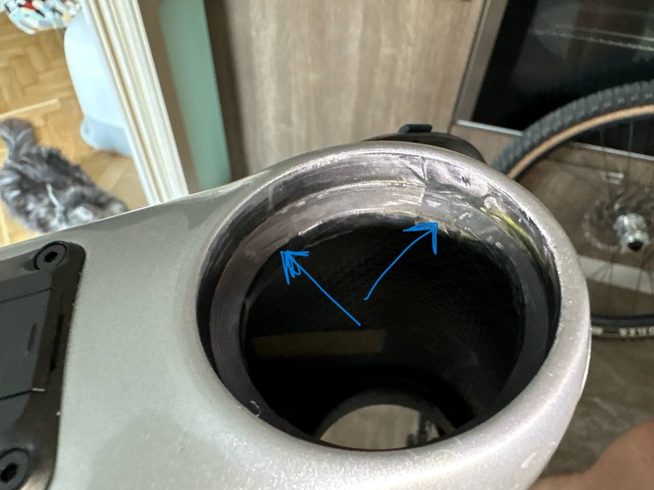

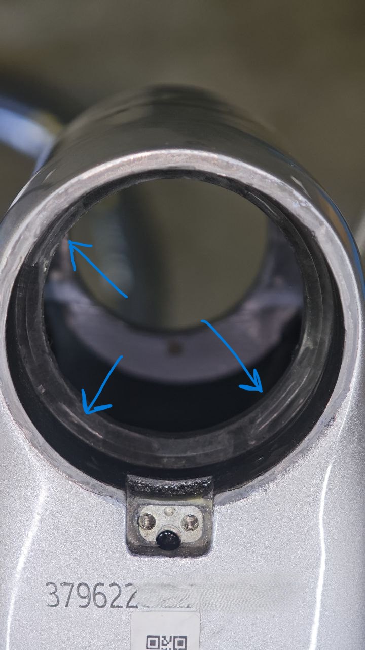

I sent photos of five more bikes with exactly the same marks to customer support, but they didn't care. They found a reason to deny the warranty and couldn't care less about the customer.
Conclusion: if something happens to your bike, don't tell the whole truth to support! They will find any reason, even the most absurd one, to deny you the warranty. The number of defects is so small that it will not damage their reputation on the large global market.
I continue to ride my bike, these two cracks haven't affected anything. In winter, I'll take the bike apart and give the frame to a carbon specialist to have it inspected and the cracks repaired.

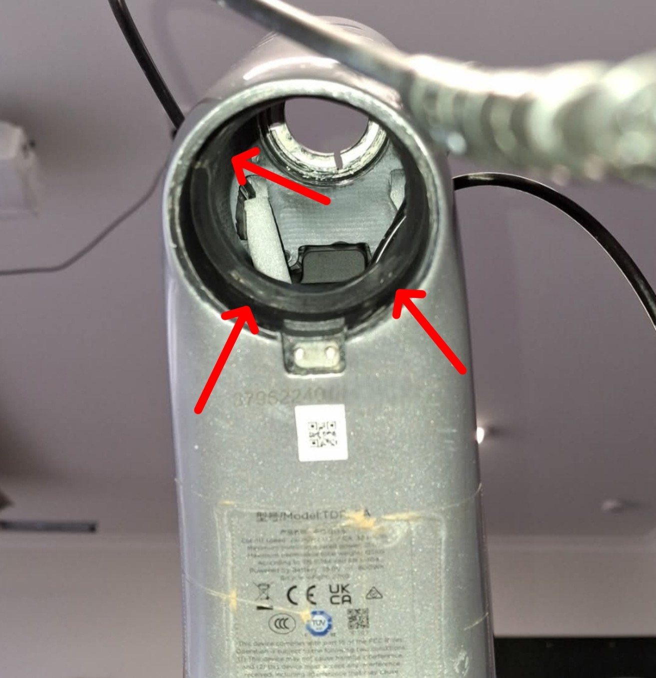

Below, I will attach photos of other bicycles that my friends sent me, which have exactly the same marks on both the top and bottom. 5.jpg 4.jpg 3.jpg 2.jpg 1.jpg

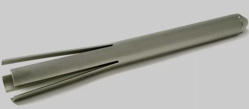

It could be the overzealous use of one of these headset removal tools if there's been a headset replacement at some point in the life of the frame. Looks curiously similar.....
The races are carbon and molded as part of the frame, the tool above would just damage them from the other side, and anybody trying to use that tool to remove moulded races needs to be re-trained…
The other pics show similar marks to the OPs frame, probably tooling or mould marks from frame construction.

If some yuts just put the tool in and hammered without looking that is exactly what those marks would look like........
There are stupid people in the world that blindly do this sort of thing.....
He sent photos of five different bikes with the same tracks. Do you think they got together, took the tool you sent, and started mutilating their bikes?😂😂😂
