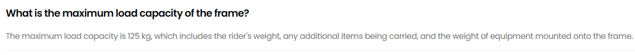

Amflow can take 125kg (including rider)according to specs so you were over limit anyway.
We have guys and 120+ kg on amflow riding with intend forks. Nothing wrong with their bikes.

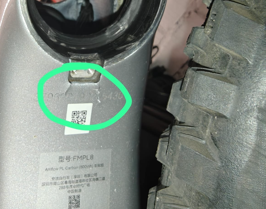

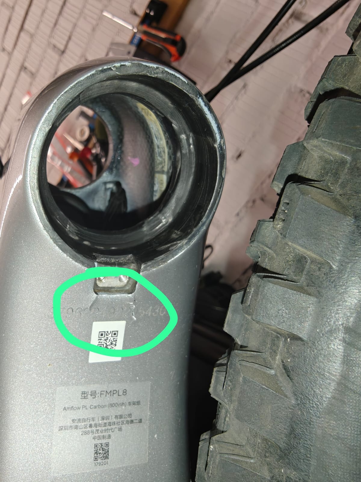

This is the area of concern. Those look like more that paint cracking. It looks like cracks forming from the block assembly.
I would sand off the paint in that area and inspect for deeper cracking. Also going a push test, any softness of crunchy sounds means its delaminating.

You are over weight for the bike. There is no warrantee as you exceed the load capacity of the bike.
You purchased a bike that was too light weight for you. That's not Amflow's fault.

I didn't want to make this post until the last moment, but amflow's attitude towards my problem really angered me.
The frame of my amflow has developed cracks! Crunching and grinding sounds gradually started coming out of the headset. Several times I reassembled everything, cleaned, lubricated, but the problem became more and more serious.

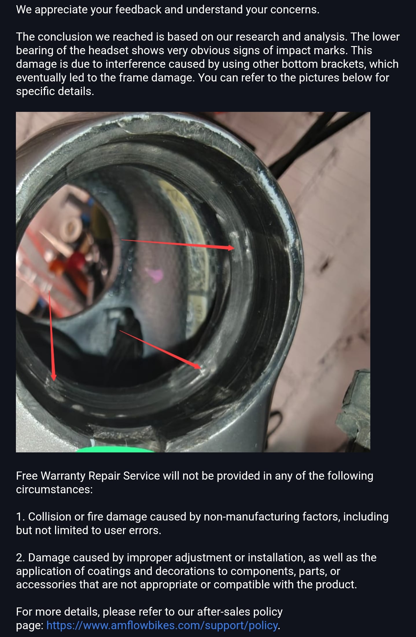

I contacted support, described the problem, sent photos and video. Their verdict was that it was my own fault, as I had replaced the stock fork on my bike with a different fork (fox 38 factory), and allegedly the fork had been replaced poorly.
The marks on the frame indicated by the support have occurred during use, as the headset backslides and a grinding sound appears.

He changed forks, the headset got loose afterwards, and he said the noise went away. And he admits this. Who know what crack he has heard or when. He had to take it to a shop to change forks. I trust nothing about this thread.
My own opinion is he damaged the frame himself and wants amflow on the hook for the shops or his mistake. I may be wrong and nothing personal jam, its just how I would call it if i was amflow

Due to oversizing which theoretically is ok from Amflo but it still comes down to there specific weight limited that Amflo state
First thing I'm looking at when purchasing bike Is the combined bike and rider/ baggage
I'm normally looking at the bike being able to take at least 15 kg more than my combined weight which is normally around 100kg

He has admitted publicly that after they changed his forks then he developed play between stem and bearing races, and Amflow pointed out wear marks on the carbon from floating bearing races. He also stated the cracking and popping noise went away after tightening the stem and bearings. Imagine that!
Its a big case of, I messed up, and wanted someone else to pay for it. Someone else already said no

Unless he lies about is weight and fraudulently requests warranty, there is no warranty. He exceeds the maximum recommended load rating of the bike design.
