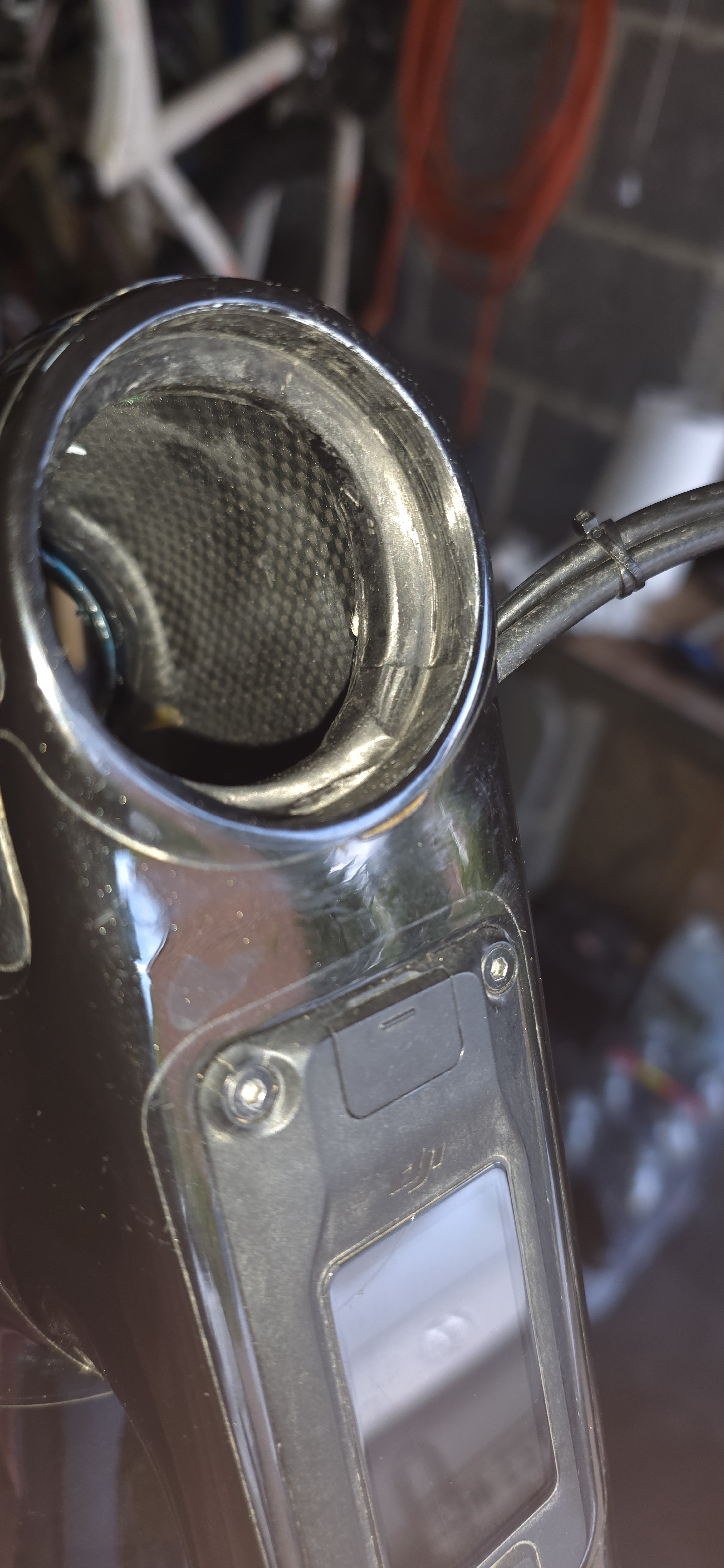

, I replaced the topcap, nothing crunches, squeaks, no play,
Then it may only be paint cracked from the backlash, they did not look like structural damage
the original cracking nose was probably from backlash too

Just trying to add a bit of sense to this: no one here can remote diagnose the crack. If it's a paint defect or deeper crack or whatever is impossible to know without seeing it first hand, by someone who knows what to look for. Ill leave it to the ill informed and quick-to-judge to do that, but don't belive it. Belive someone who can actually make a real diagnose.
Contact a proper carbon repair shop if amflow turns your claim down.
I'm not being evasive, I don't know what to answer you.
I have no idea what could have left those marks. They don't feel with your fingers, nothing is pressed in, it's smooth and even, it's the glare from the flash on the camera. I'll take better photos and video today. I also asked the guys from our club to check if they have similar marks.

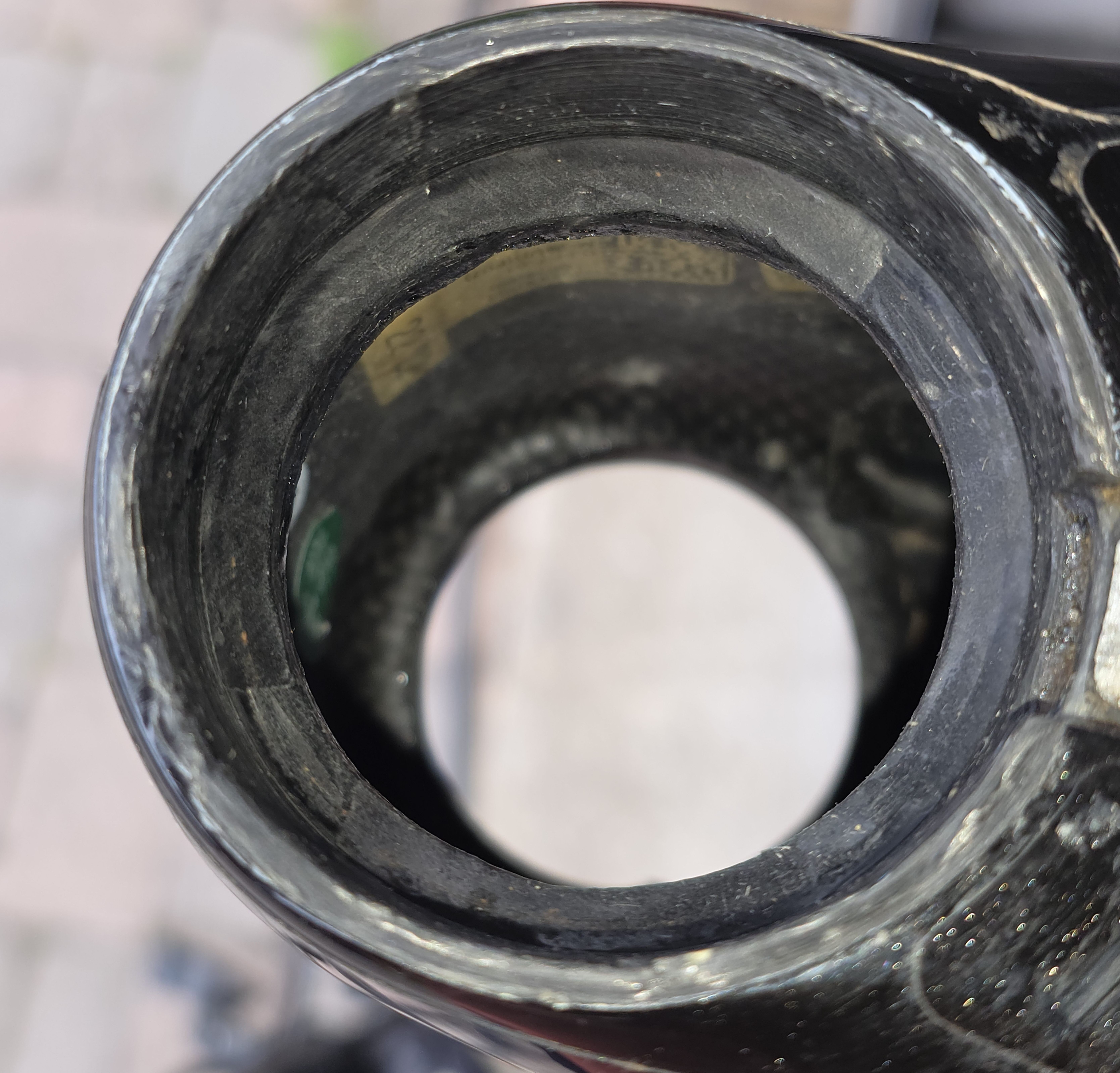

I regreased my headset bearings, during routine maintenance, at the weekend and noticed the cups in my frame have a lot of filler and are pretty uneven. They also show obvious signs of reworking/ manual dressing. They look similar to yours except without the cracks as far as I can see.
This is the first time my headset has been disassembled and the forks are standard and have never shown any sign of slop or movement in the headset.

I have no cracks in the bearing fit area.

Having seen Volta picture now, I would keep pressing the warranty claim with Amflow.
Worst case scenario, they ultimately say no, but your frame can still be repaired by a competent carbon repair shop so you won’t have lost everything.

Have you sent this to Amflow? That finish is awful
Yes, I was referring to the cracks from the corners of the knock-block slot.
The point I was trying to make is that the areas highlighted by Amflow look like the areas of hi/lo and or filler which you can see on my pictures.
This is why I steer (pun) clear of frames with integrated headset cups. Not that it helps to say. The fit and finish on both of these frames is terrible in a place where tolerances have to be spot on.
At first I was leaning to the side of Amflow, but seeing a second pic I would keep pushing for a resolution.

That shouldn't pass QC in any way. I would note that in a communication to Amflow today. You have to think those imperfections are going to lead to high pressure areas and cracks at some point, like the OP.
