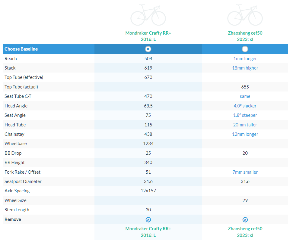

Well, I guess Sizing is almost spot on to my Mondraker Crafty RR built as a 29er.
IMO the effective TopTube is even a bit shorter. I think they switched it up in this chart.
Taller headtube makes a bit higher stack.
Should be good in XL. Unfortunately, there is no data for size L. Maybe I'll import it.
The TT of the Crafty is much longer then CEF50, even if the reach value is the same. This is due to the steeper seat angle of the CEF50.

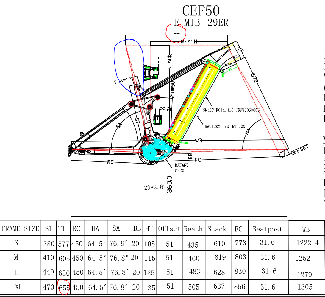

I THINK they made a mistake here...
This (red) would be the effective TT, which is shorter than the 670 of the Crafty.
Or do you mean that it is not the effective TT, because the scale (blue) is not perpendicular? Then you would be right, but the values of the Crafty and the CEF50 would not be comparable...
All correct- like written above. The effective TT of the CEF50 is 15mm shorter, due to the steeper seat angle. Imagine the seat angle is getting steeper, then the TT is getting shorter without any effect on the reach value..

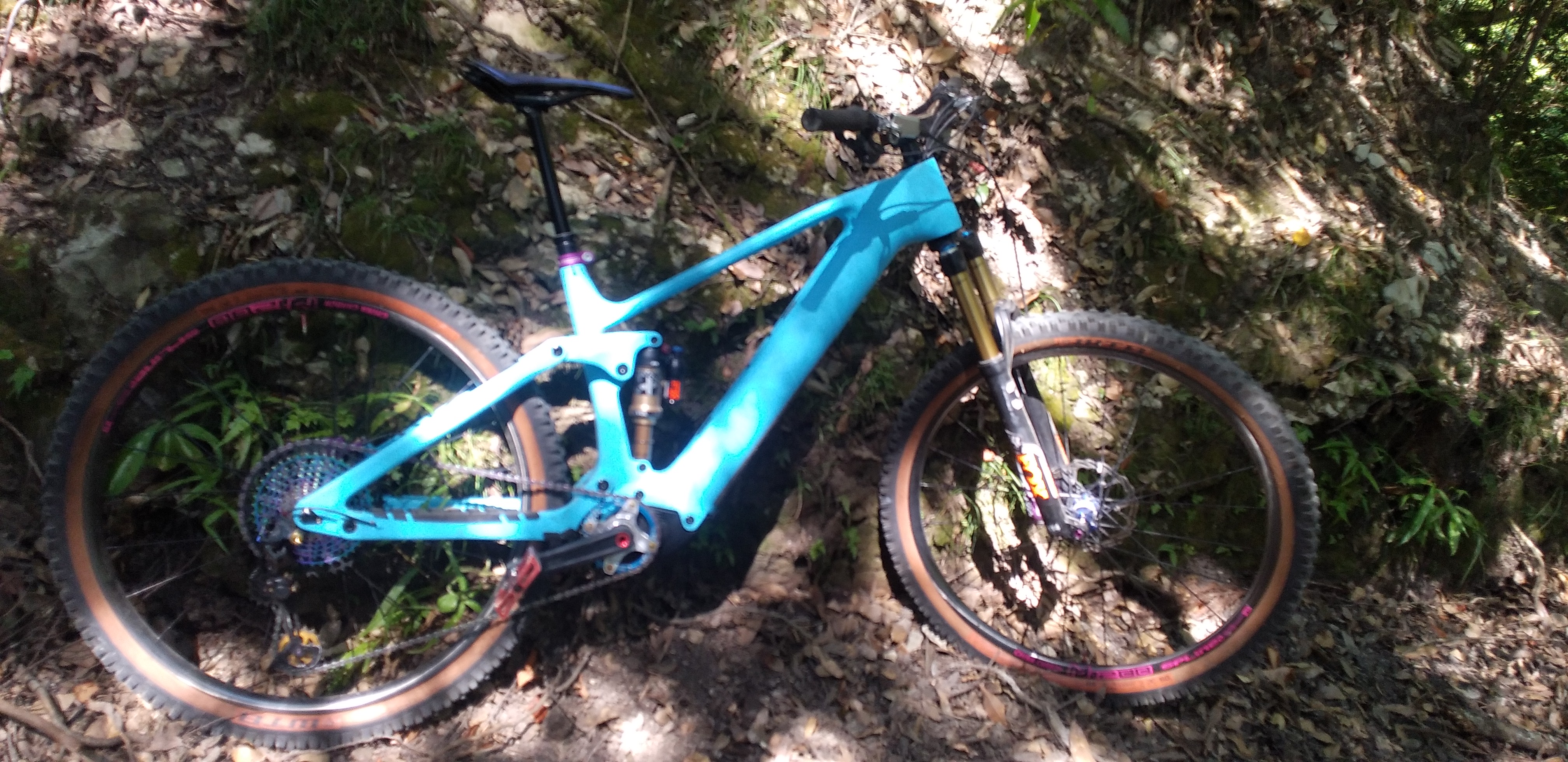

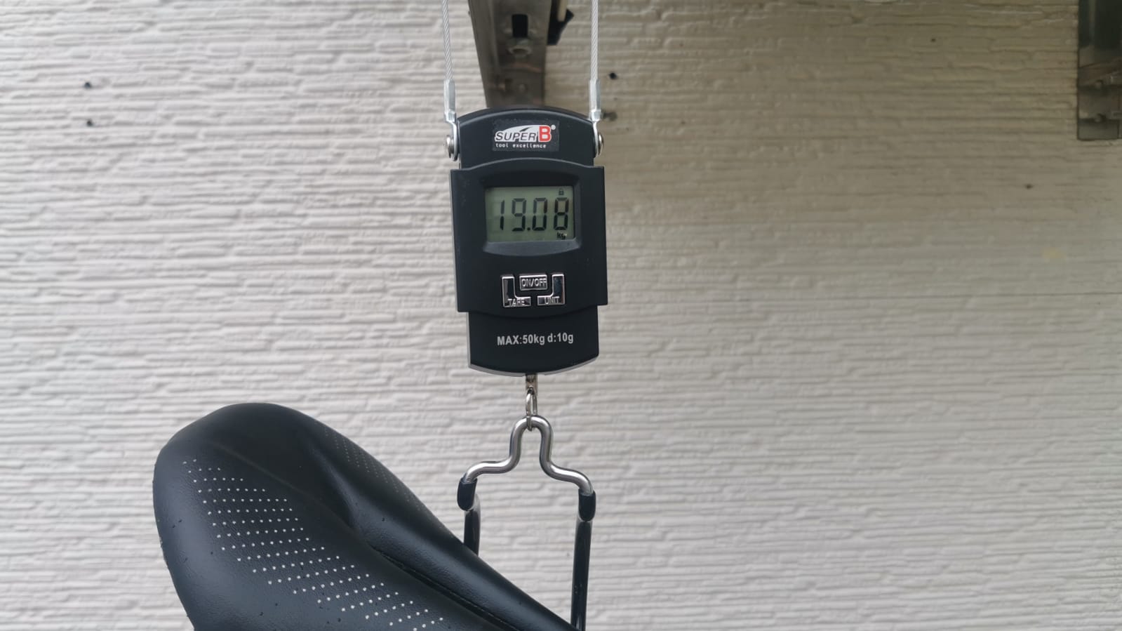

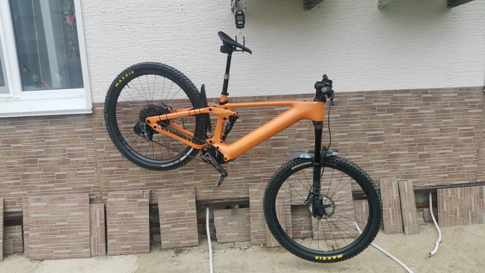

I finally finished installing the 720W internal battery without the case. The weight of the bike is 19 kg. A lot of mounting foam will warm the battery in winter. Size M
View attachment 120870 View attachment 120871
honestly, not much of a weight score! on e10 xl size, if I fold the 720wh battery, put lighter components, lighter tires, lighter fork, wheels...... I believe the weight could be under 22kg. and much more power. and in m size even lighter.
How tall are you?
Hello. I'm 173cm tall and prefer big frames. My custom hardtail has a reach of 538 with a seat angle of 80 and a stem length of 20mm. I want the reach of the CEF50 to be about 20mm longer.

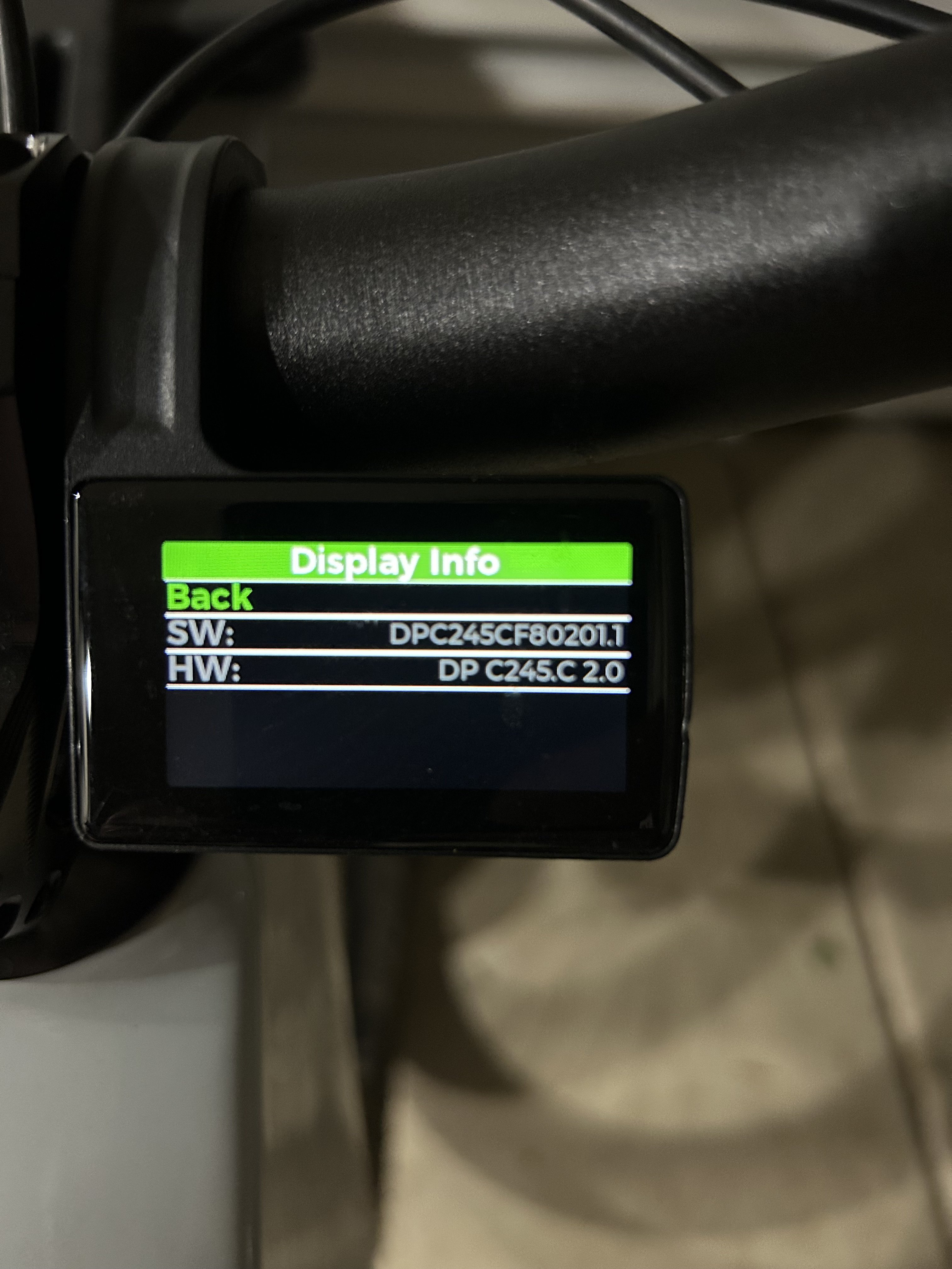

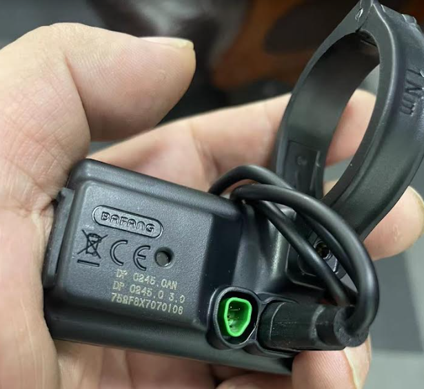

I have a question: On the DP C245.CAN I tried connecting into Go+, which I wasn't expecting it to work at all. However, my phone found the DP C245.CAN right away and paired with it. Then it seems like it disconnects and throws up in the middle of the phone screen a connecting message that doesn't seem to go away.
Have you guys figured out the fix for this?
The general consensus is that there is a third version of the unit and only it works. Part number listed as XXX.V3
I would try a different phone if you have access. Note the version of Android on each to see if it makes a difference. Same with Bluetooth. Good Luck
Thank you for this information!

Thanks guys. I will carry it because it is lightly finished. Work hard. I used to ride the E10 L size, but the CEF50 is small. I may exchange it for an XL size. It is very good that the seat angle is happening
CEF50 reach is 483, E10 size L reach is 485 - almost same. The difference is the toptube length, 630 vs. 658 for the E10. This is related to the steeper seat angle of the CEF50, so I assume the seated position feels short for You. May be You try to move the saddle backwards as much as possible, or look for a dropper with more setback…
Easy to calculate, CEF50 vs. E10:
- frame is appr. 1,5 kg lighter
- battery is only 0,5 kg lighter
- engine is 0,6 kg lighter
Summing up to weight saving potential of appr. 2.6 kg. If You use a lighter battery (LAnton) You’ll save another 0,7 kg.

Linda tells me that she can't get the 3.0 version and she is getting no info as to when they might be available. But there are a few out in the wild shown in a thread here on EMTB.
Haha, I’ll take my KFC gift certificate. Yea I found the thread where this was being discussed and it looks like at the earliest it theoretically be August. Huge miss on the part of Bafan.
When did she tell you this?
Just a couple of hours ago she told me:
and we can give the DPC245(3.0)version which can use “go+” app.( fyi attached picture), thank you very much.
