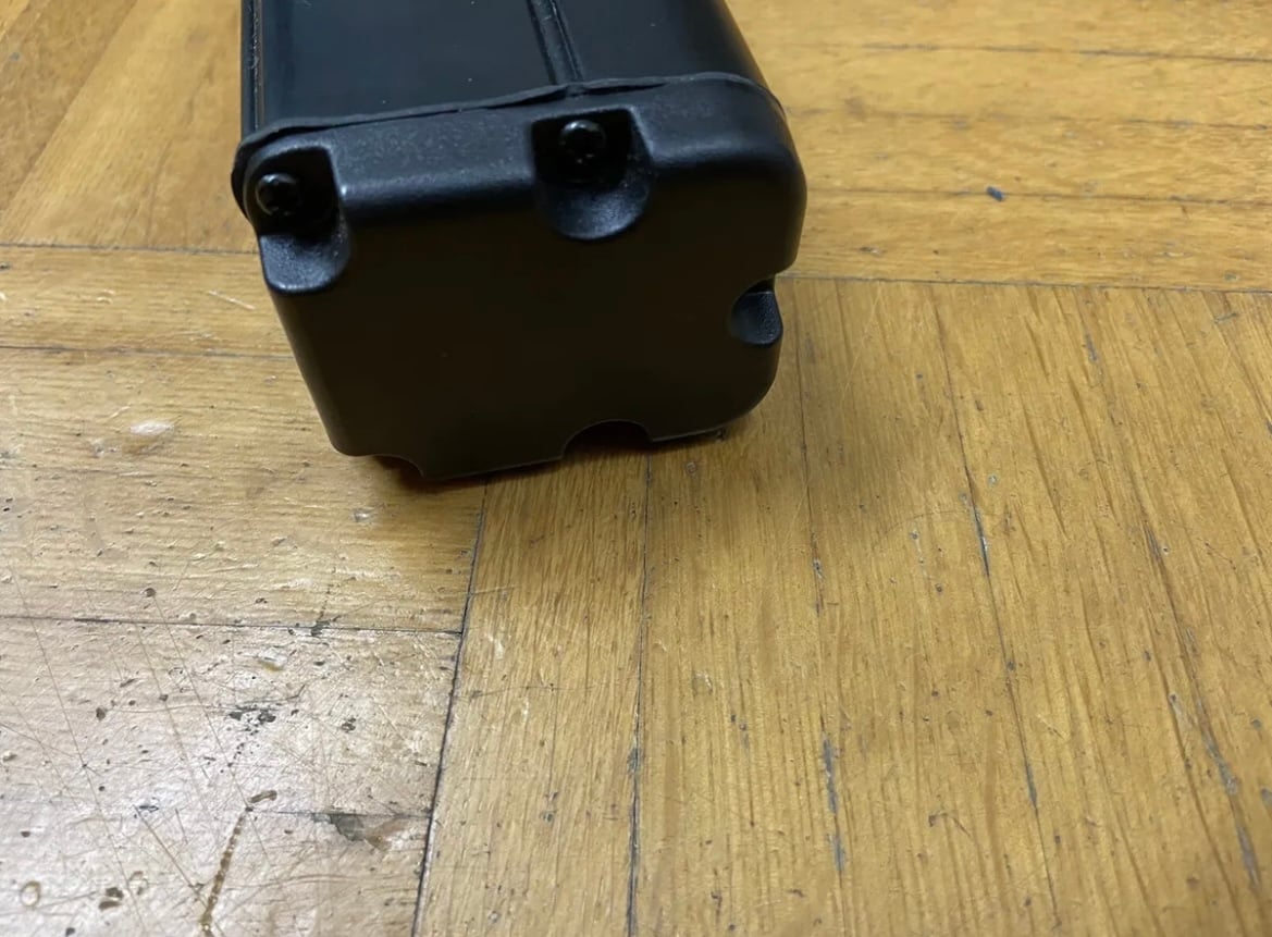

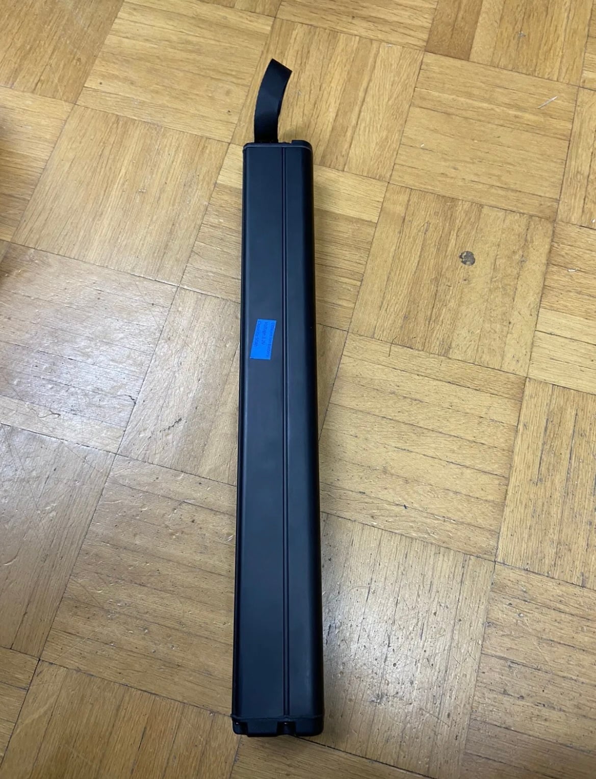

This is a picture of the 720 Wh battery. Completely different from the Bafang 410 Wh…

The 720 Wh is not a Bafang battery for my understanding. It’s a specific battery designed to fit into the CEF50 frame. The question is, if the battery supports CAN communication with the Bafang components. My E10 has a battery not supporting the CAN communication, so some details like charging cycles, battery health etc. cannot be read out. Not a big thing for me.

Nope, sorry see previous threads here. CEF50 manufacturer's is 720 Wh, in-house battery.
Also, one frame with two battery options Bafang 410, and the aforementioned that fit in the same downtube, using different cradle/hardware paired with each different battery.
I assume from the pics, the oversized downtube is likely really built for the larger in-house 720 Wh. But, for those wanting to shed another lb/kg, the 410 Wh. Probably a good option for lighter riders. This doesn't really appear to an issue/concern at this point. More will be revealed after Lunar New Year in early Feb.🤞

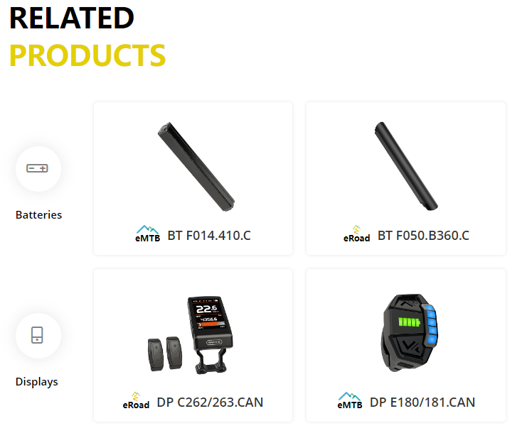

This is the Bafang BT F014 as claimed as alternative to the 720 Wh battery. Looks completely different.
View attachment 104900 View attachment 104901
The photo shows that the bafang battery is different from the battery made by the factory. The factory can make at 420 or 710W 36V to choose from. So I ordered a 36V motor. I think we won't notice a difference between 36 and 42M. Self-assembly of an electric bike is a fun adventure. I think it's better not to buy a bafang for this frame, buy it from the frame manufacturer.

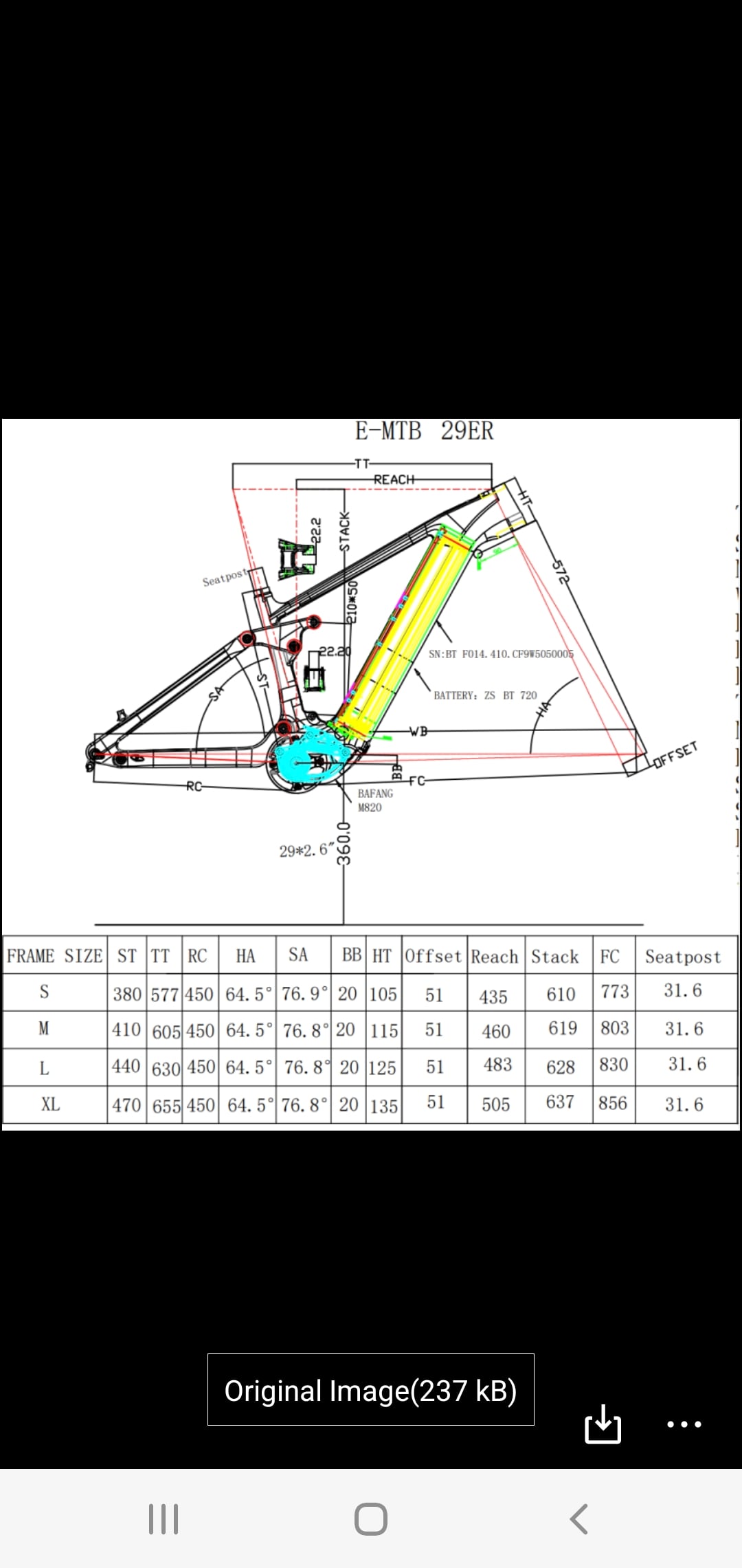

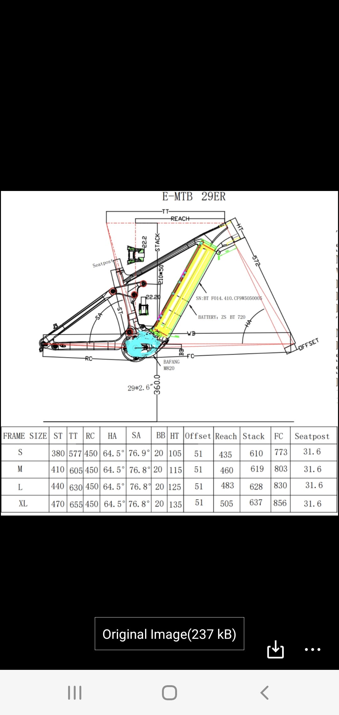

1) anyone gotten the weights of the 410 vs. the 720 battery? The ~ 20% protection factor, would rule out the 410. However the 720 places lots of weight high and forward and although it might be 2kgs/ 4.4#s, it might be very noticeable while riding.
2) The BB drop is listed as 20mm, I presume that's actually -20mm?
3) I like a steeper STA and the other changes that come along with it as well, any problem running say a 215/55 shock (not even sure that exists actually)?
4) Someone posted that FSA makes some compatible -1 headsets, that would be a key component with a longer shock.
5) Generally Progression is measured from the sag point, which should be 30%, to 95% travel (at which point bumpers and crazy air ramp up dramatically change things anyways). I'm getting 22% progression, while pretty good (basically identical to my SJ Evo with a Cascade link) is not high for a 150mm travel bike. My SJ Evo still requires a massive amount of air can volume reduction to work well at similar numbers. I'd call it a minimum workable number if you ride aggressive. 25-30% is really where you want to be for a 150mm travel bike imo.

720 Wh is 10S4P (40 pcs) of 21700 cells at 70g per cell. Means 2.8kg for the cells only. Plus appr. 500 g for the housing, BMS etc., so appr. 3,3 kg for the battery at minimum. The 410 Wh battery weight is given by Bafang, 2,6kg according to workbook 2023.
Just to highlight battery weight comparison.
✅3.3 kg big juice box (in-house)
✅2.6 kg small juice box (Bafang)
= 0.7 kg difference (+/- g) or 1.54 lbs💪

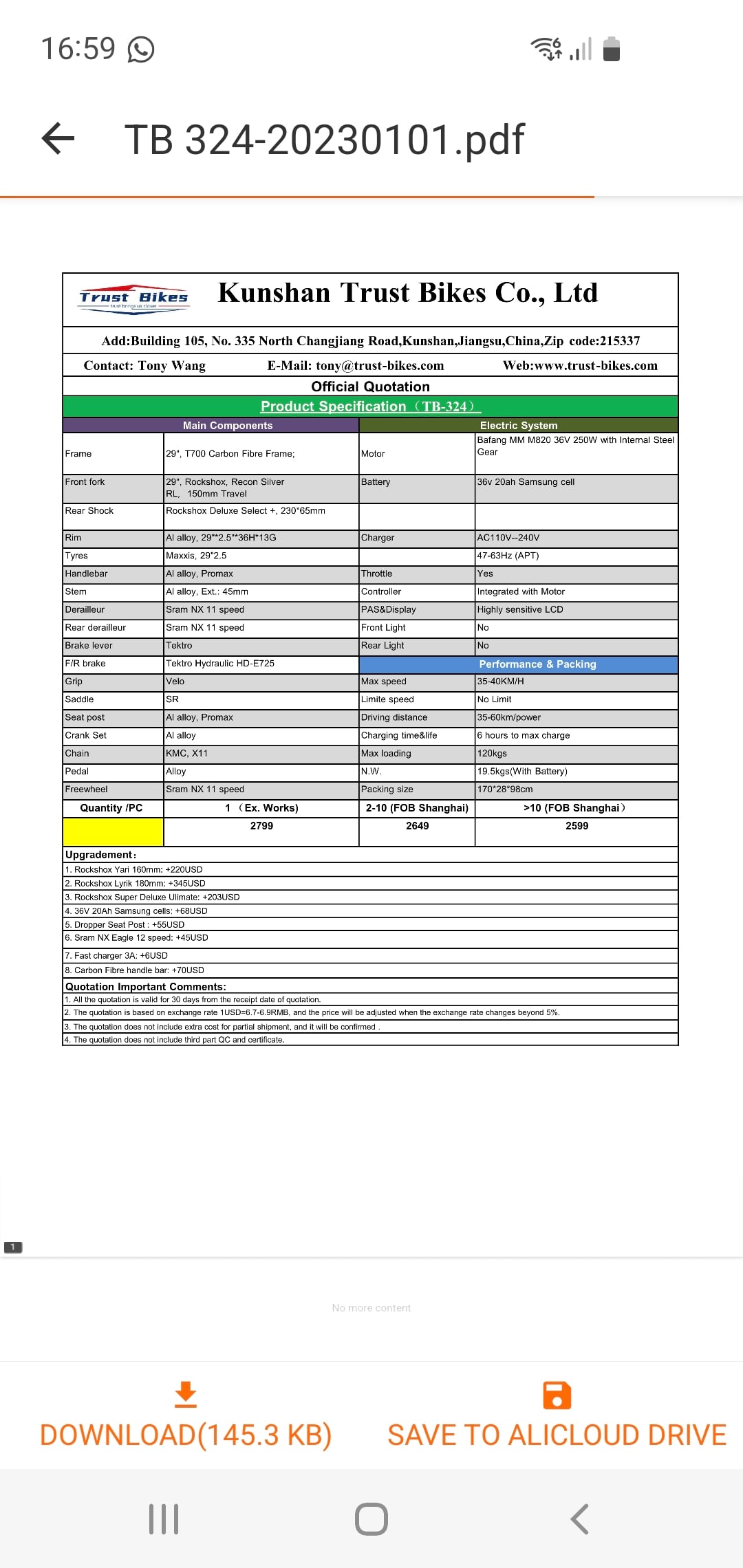

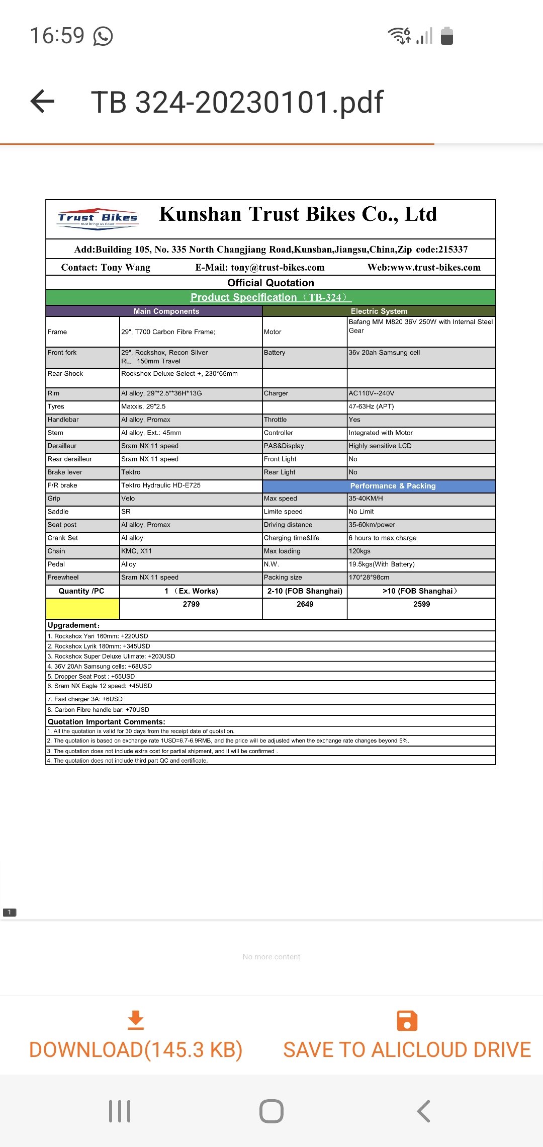

Hmmm. I googled www.trust-bike.com and nothing came up.🤔

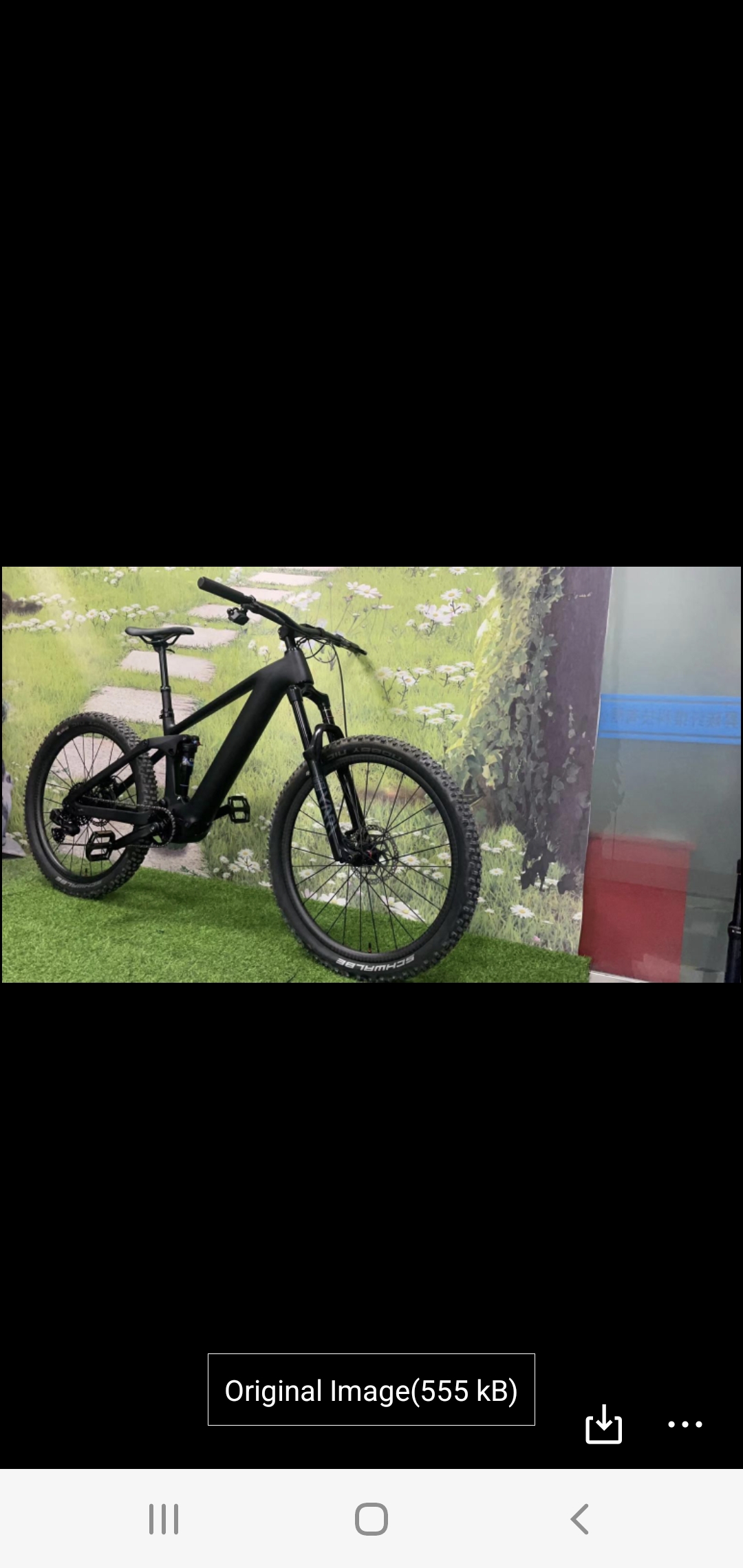

I don't know if that means anything but I'm sticking with the CEF50. Also, I noticed the shock size is bigger (230x65) on the trust as a few other build details like a traditional wired 12 spd transmission (so maybe it has frame cable ports...good idea IMO.).
H
Beware of chinese, they often write the wrong spec. Picture show rearshock 210 but they write 230 hahaahaha...
I can't tell from the photos, does the CEF50 use a Trunnion shock or no?
I'm curious if this frame can pull off a 230/ 57.5mm shock for a 15mm lower rear axle (enough for a Mullet) and 173mm rear travel.
Probably easier to just run some offset shock bushings, in reverse to lengthen the shock a few mm.
210 is standart. trunnion 205.
Shock size doesn't jive.
I've been burned by Alibaba before and am quite reluctant to buy anything that isn't from what of the major players.
You are absolutely right. I also made a lot of mistakes when buying. I advise you to buy only the frame motor and battery and nothing else. On Aliexpress, you can buy carbon parts separately from proven brands.

We had that discussion earlier in this thread. If You want to overstroke the frame, recommendation would be a 216x63 shock. You can go Mullet on the rear and / or use offset bushings to finetune the geo. If You can use the full 63 mm stoke, You will get appr. 180+ mm rear travel.
Who even makes that particular size shock?
RS doesn't seem to (my preferred brand).
Thanks.
They still have the Vivid air or coil. Cane Creek still makes them. But You are right, this is a somewhat outdated, non-metric size not really common any more. Fox I didn’t check…
