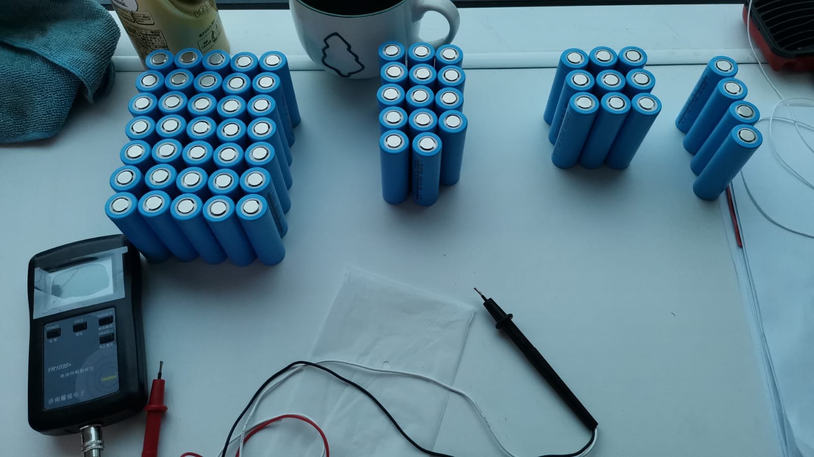

For the battery, I have some experience in the manufacture of the interior modules and the carbon shell, I don't see a problem in making one.
Perhaps the best option would be the 720 Wh model with a DIY battery of about 600 wh, that is, 12S 3p with 21700 cells and carbon casing.

According to the information provided, this battery is 42v, 12S 2P, 24 21700 cells of approx 4900 mAh that give those 410 Wh, very similar in section to the one my current trek fuel exe bike has.
Apparently the other battery is 36 v 10s 4P, 40 21700 cells of approx 4900 mAh = 710 Wh.

This is a picture of the 720 Wh battery. Completely different from the Bafang 410 Wh…
