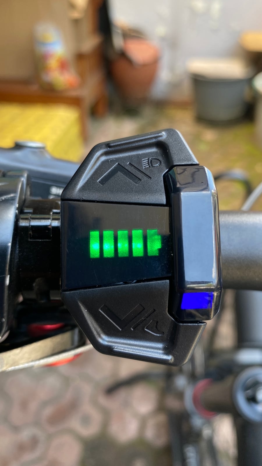

Can u send real time pic of the DP-181 please?Just curious...😁
Is the blue light the assist level? How many assist levels can be programed?
Thanks

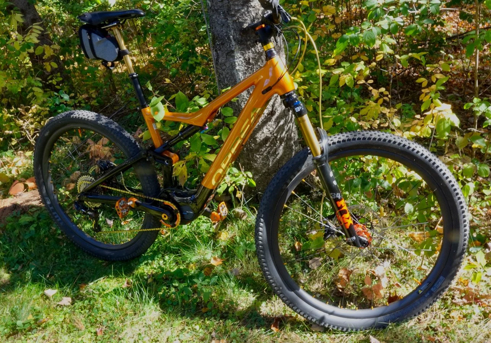

more pictures of your bike ?:)

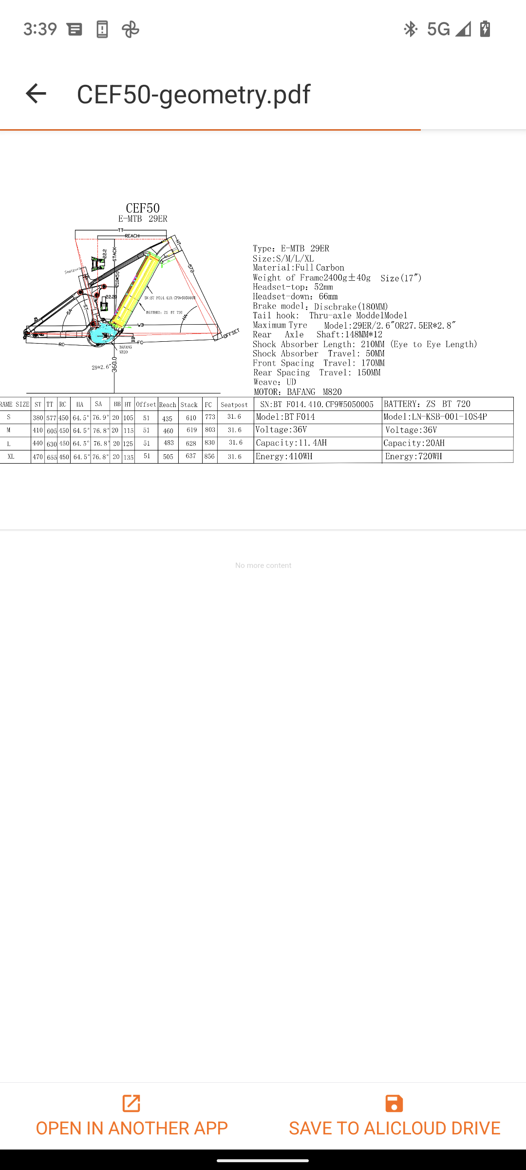

Interesting to see that the cef50 is given at 2.4kg whereas the lightcarbon is at 3.0kg and it fits only the small battery, there’s something wrong here :D

I like the CEF50 's 720Wh battery idea better. Bonus, the optional top tube hole for extra mounting options like the cell phone holder or "ash tray"!😁

Same here. If the CEF50 weight is true, its the way better option to spend the saved 600g for additional Wh! 😊

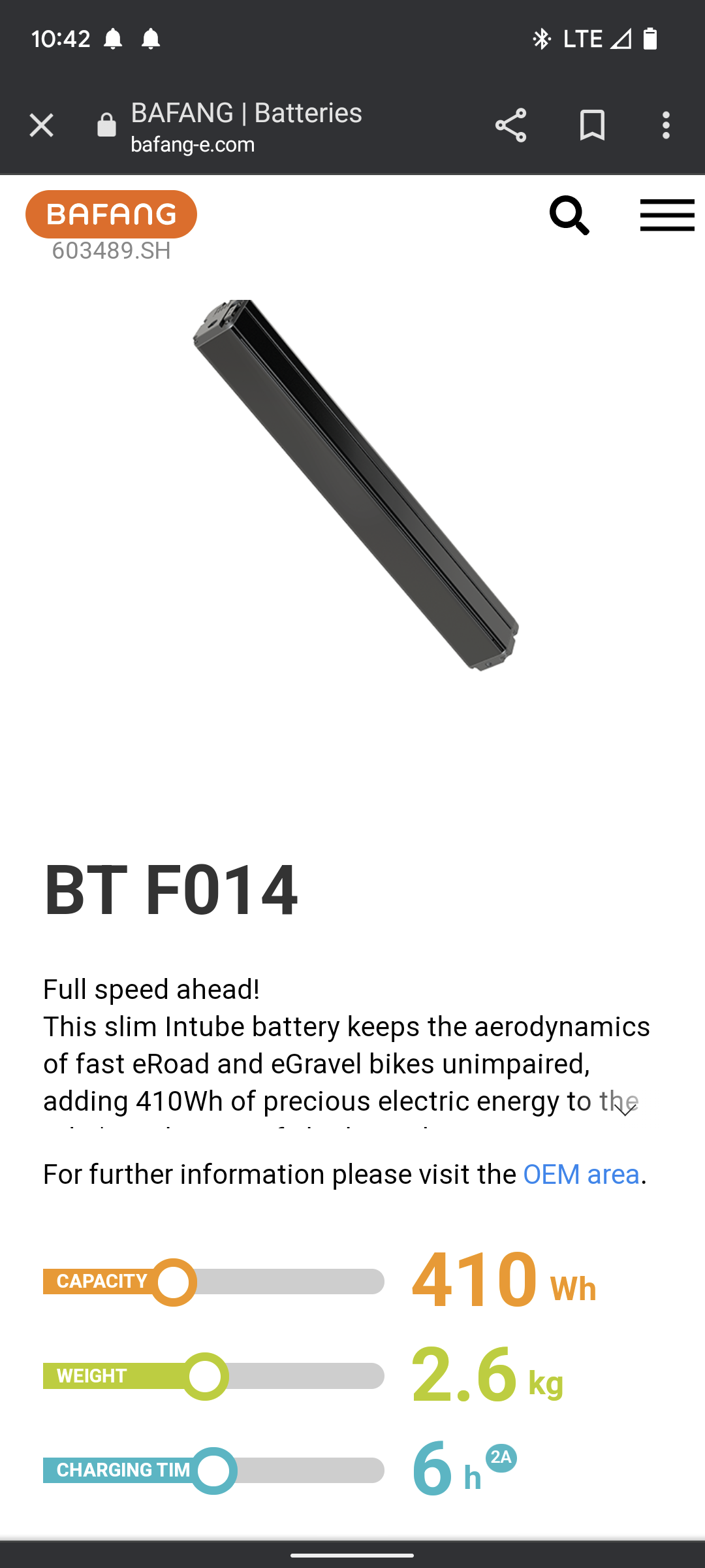

Potential Bafang 410Wh battery concern for me. I don't know if it translates to the Bafang 410 (BT-F014battery). However, one unpleasant battery issue about Bafang on my full-powered LCES04 M60043v motor kit. Luv the frame and mid-voltage motor, very smooth shifting, still plenty of turbo power. but hate the both 450/600 BT-F03/BTF-04 Wh batteries. The reserve cut off (to below) Eco mode is a whopping conservative 28%. Seems to be the case for using Bafang batteries with the M500/600 across the board...just an inherent flaw unfortunately.
In contrast, my DengFu M620 06 fat bike's two, in-house 600 Wh batteries that both goes into reserve at 7-8% eco mode to almost complete. it's a Bafang BMS issue to save battery health on Bafang 's part...but I probably get only 70-75% of a fully charge, new battery for both 450s and the bigger 600s.😜 So, it's not fixable unless the BMS firmware is altered...good luck to me!🤯
My solution was to build a 21700 cell 970 Wh battery (currently under DIY construction) for the LCES04. 💪
So the potential dilemma for the Bafang 410Wh may have a similar concern...just speculating if it transfers over to the M820/410 motor kit in general?
Some ride reviews on the M820 system are still forthcoming of course...but once I knew the 720Wh was a CEF50 in-house battery-build, I figured it wouldn't likely be an issue. Just my expectations, experience, and thoughts. If so, don't hate the messenger...I'm a Bafanger too! 🍻

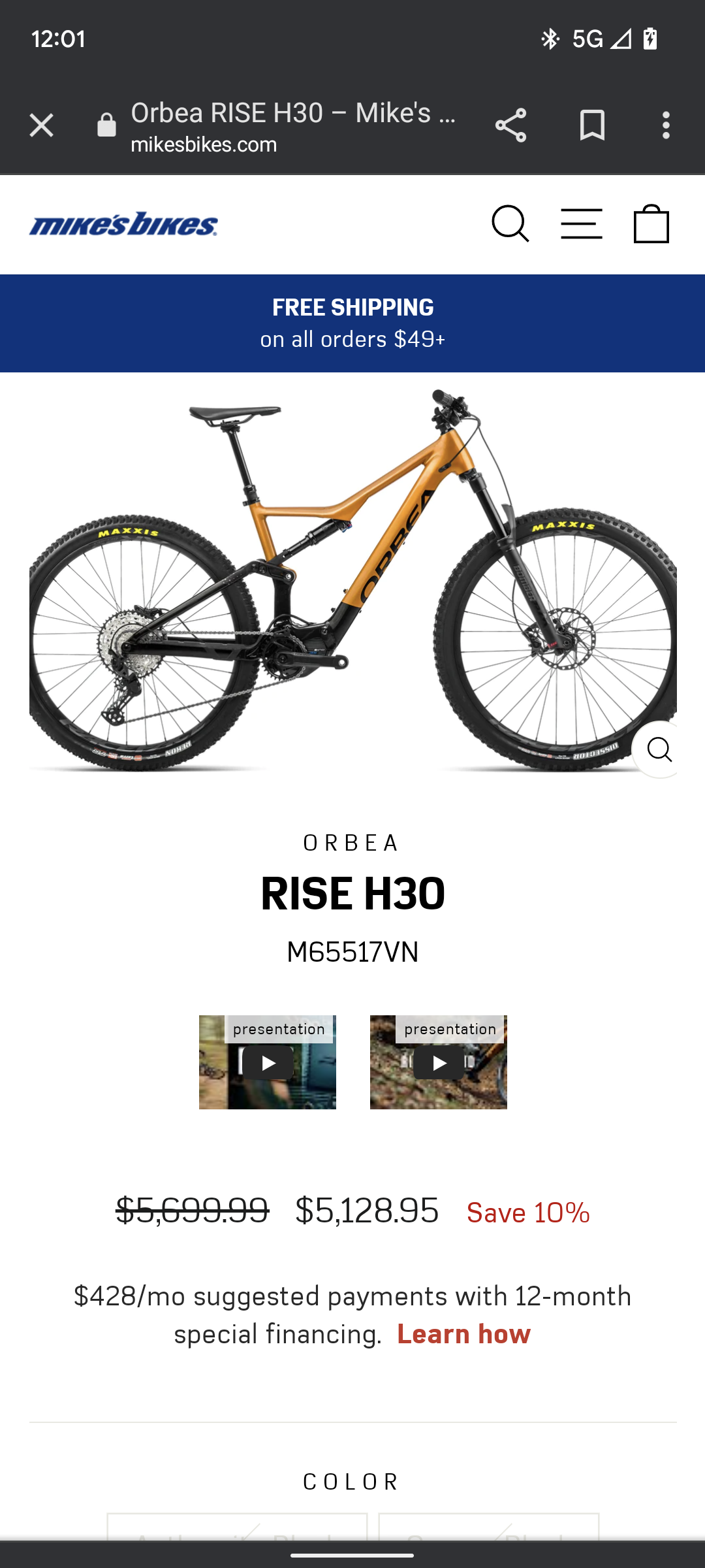

I have an Orbea rise H30 with a 540wh battery and I never run out of juice. So the small battery is perfect for me. The three lbs less for a trail rider is important. Lightcarbon LCE930 render
Nice price! 540Wh battery on AL frame is nice! How's turbo feel on the Shimano RS?

I am 250lbs and the Rise has no problem getting me up steep sections. I am not an enduro rider so I don't have to shuttle up long dirt roads. But for trail riding, and the Rise is designed as a trail bike, I am very happy. Mine is down to 43lbs but I want a lighter bike for my wife.
