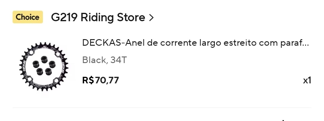

good morning, a question regarding the chainring: it does come standrd with a 32T, but can I find different size aftermarket? Is it steel? Do we need any special proprietary tool to remove it?
I assembled it with 34T, but I've never disassembled it so I don't know if I'll need any special tools to remove it. I think 32T would be bad for maintaining faster shifting speeds.

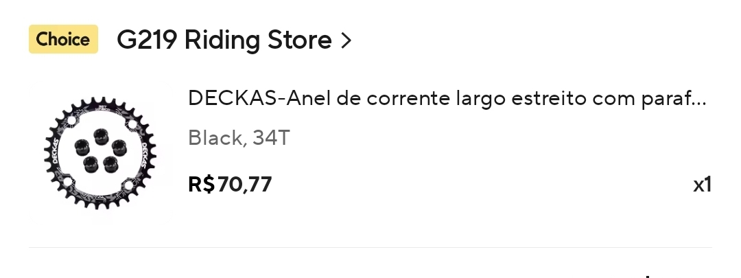

Well, I was thinking of a 30T as it’s pretty steep where I live (and any bike I’ve tried in 29er that uses 32 or bigger always felt off) and the bike will likely never see the asphalt to reach those speeds
