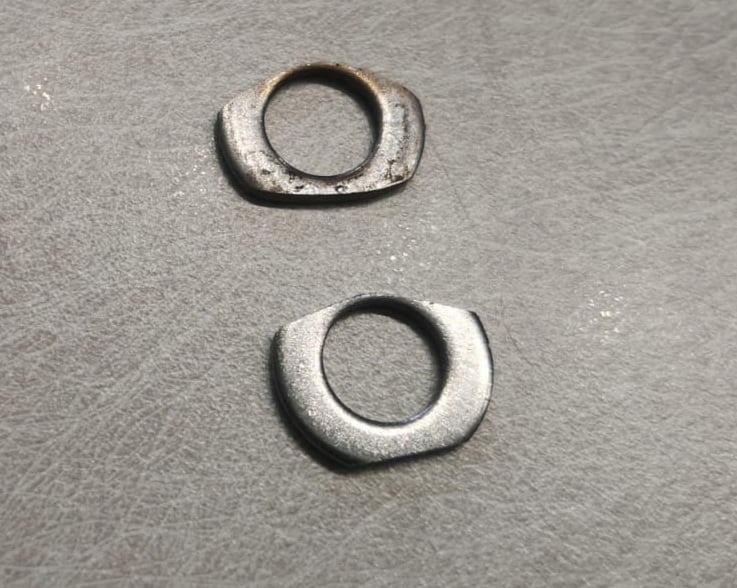

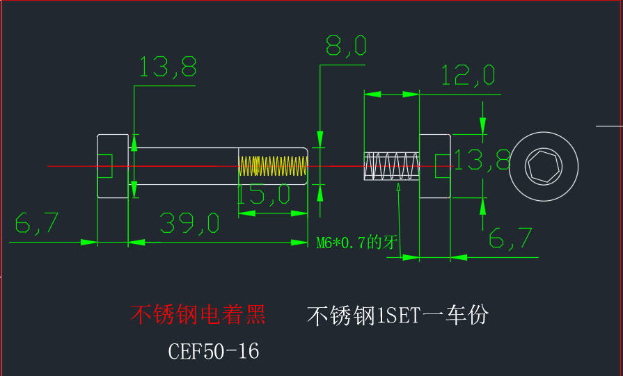

The shock mounting bolts are very soft and imbus tolerances with them not very strict. Be very careful with them, too much threadlocker or too strong one is as bad as no threadlocker - you might easily snap the bolt.
The top (rocker-side) mounting bolt dimensions are in the pic.
Unfortunately Jean recalled pic of bottom bolt before I was able to save it, but what I remember is:
  • nut OD is 8mm (M8) just like the top one
  • nut length is 32,5mm
  • bolt head OD is 15,8mm
  • head length is 3mm
  • screw is very likely M6 just like the top one
These bolts are custom made for SZZT which somehow explains their poor quality. Probably we could choose higher grade material if they were off the shelf/standardized ones instead of carved from a piece of soap.

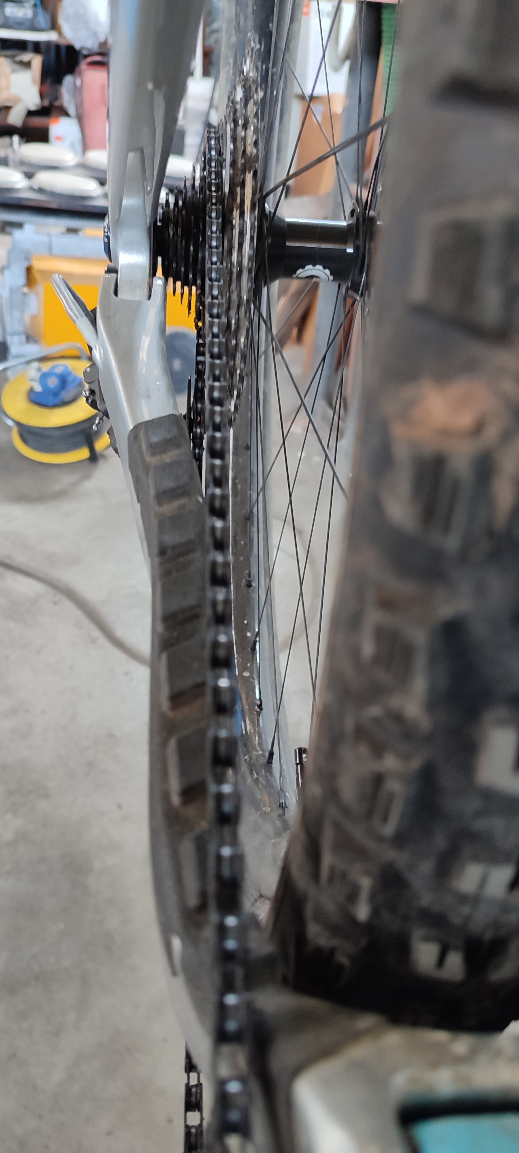

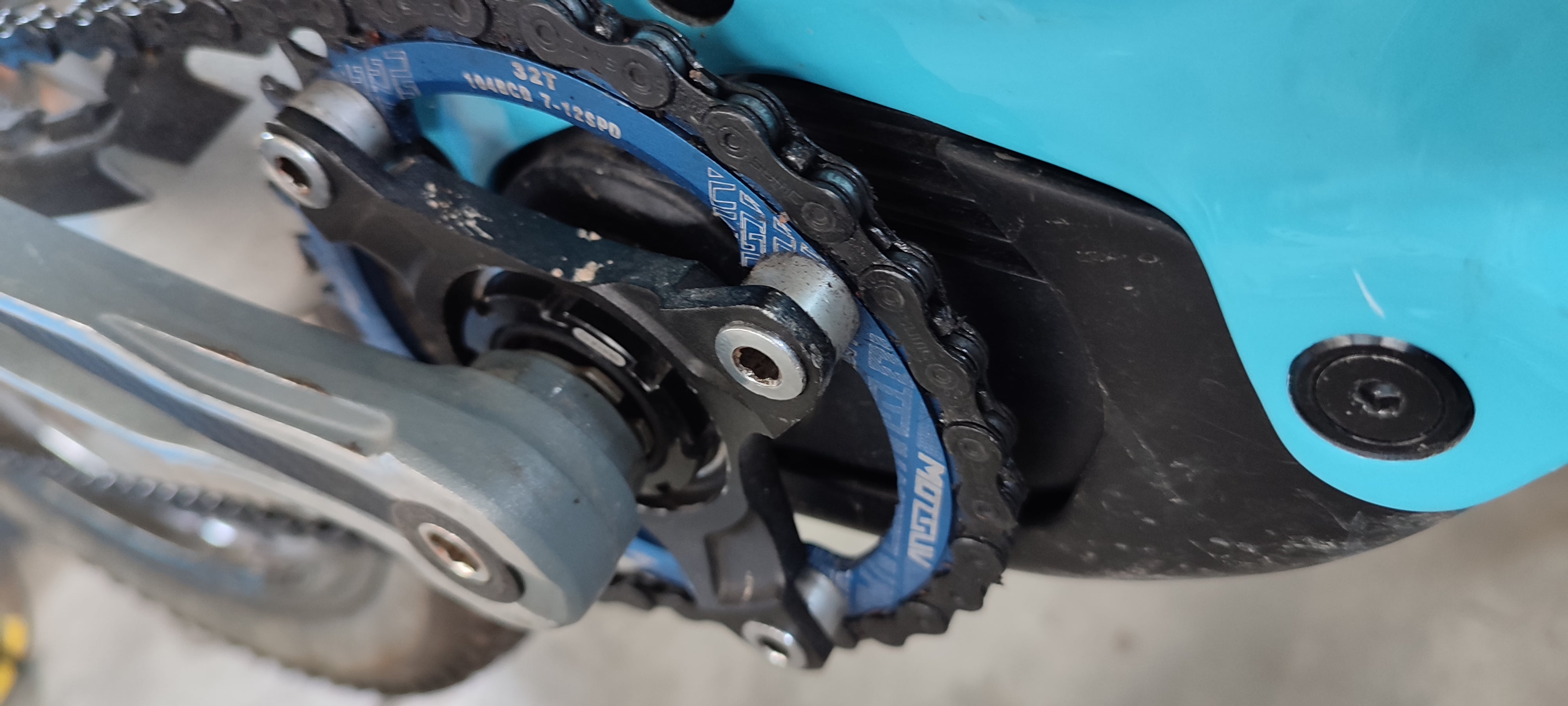

I wasn't satisfied with the chain line of my CEF50, I put some spacers to move the chainring towards the internal side.
before you could hear noise on the larger sprockets, after the change it was definitely better.
In the photo the updated chain line.
I had doing the same, but not as large, only 2 mm.

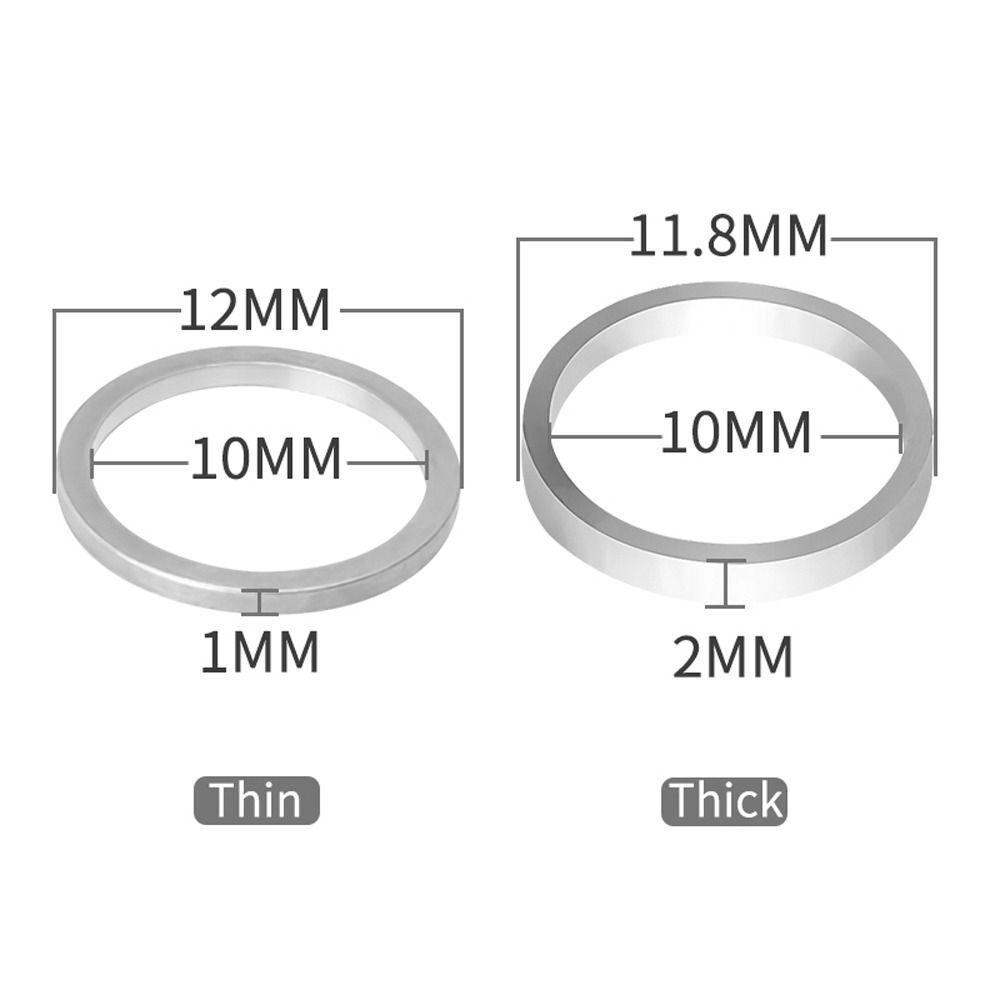

what size spacers and bolts did you use? please share link if possible

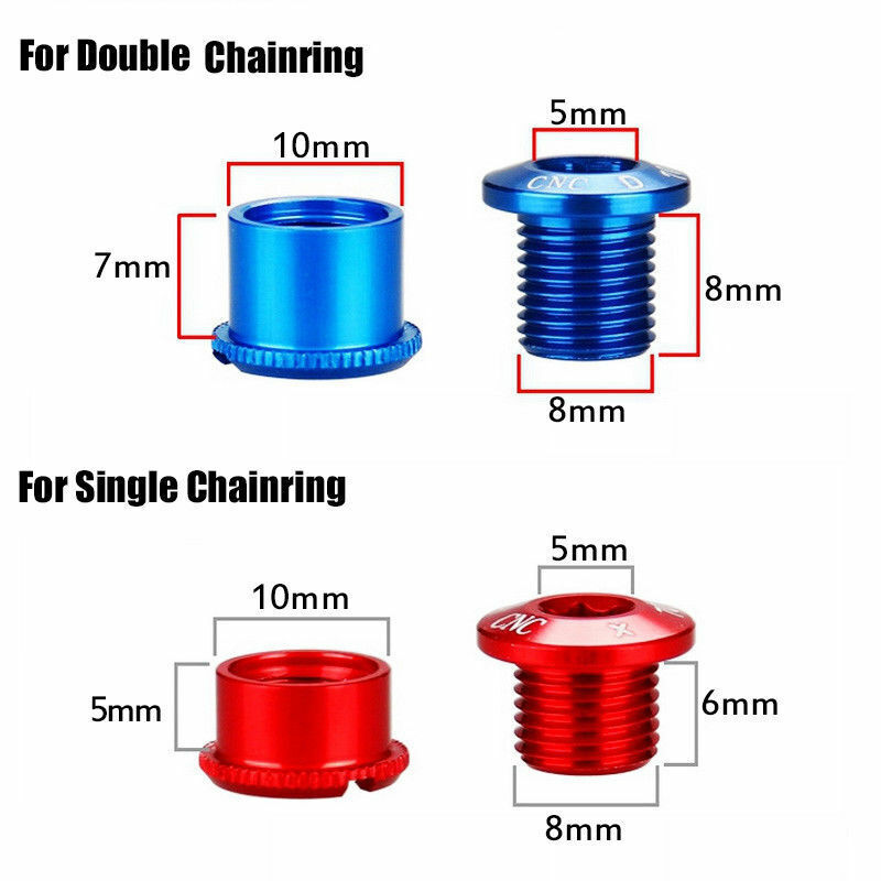

I just got something like these from ebay. I used the 2mm
"Spacer Chainring Bolts Washer Bicycle Chainring Bolts Gasket Screws Washer"
don't forget these. I think I used the Double Chainring.
"5 PCS Litepro AL7075 Single/Double/Triple MTB Road Bike Chainring Bolts Screws"
I already had the material at home recovered from old bikes, in any case the height of the spacer used is 7mm.
Wow! you needed 7mm spacers? Assuming Bafang oem chainline is 55mm (I have no idea about this), you now running 48mm chainline? Is that correct?
TBH, I just spaced mine out until it looked ok (eyeball method) without going too extreme.
I wanted to move the crown inwards as much as possible as I mainly use the largest pinions which are also the most delicate as they are made of aluminium.
I'm not saying it's the best solution for everyone, probably the most valid for my use.
Yep, i totally understand. I had a similar problem with my chainline to the big cog

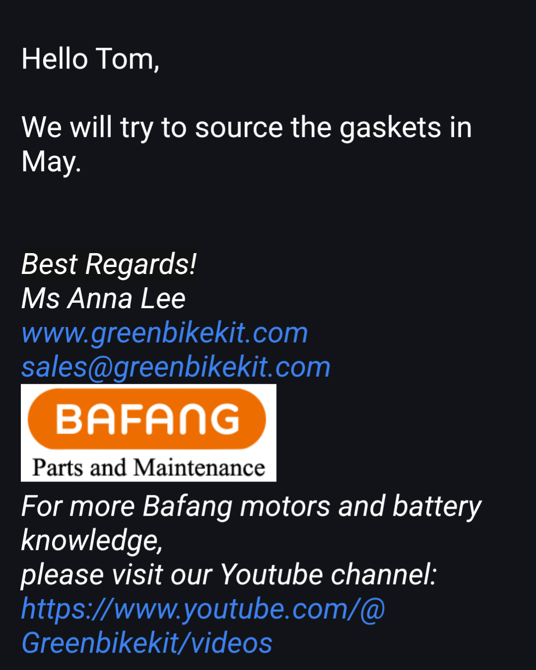

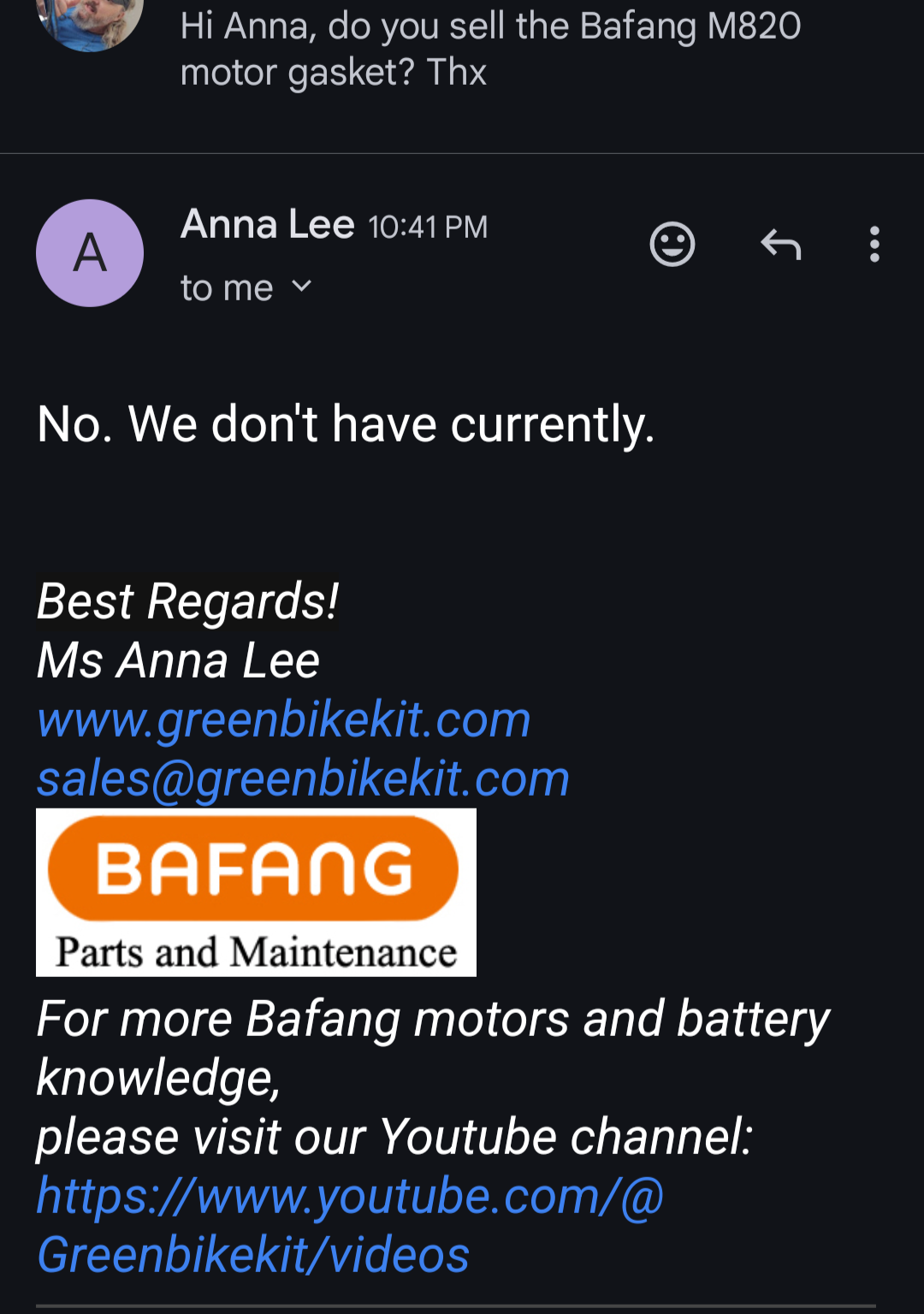

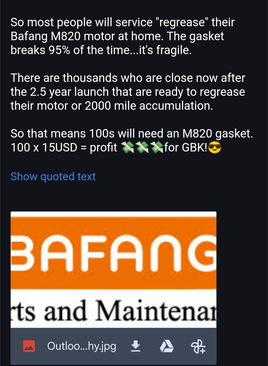

I looked and no they don't. I guess a clever person could make one out of auto gasket material?
I sent out an email to Anna at GBK to see if any are available! Sure I could make one but blah...not accurately. Anyone looking for a side-hustle?😁
Well...this is why Bafang dealers frustrate me! Bafang has a minimum order quote (MOQ). Greenbikekit.com won't order until they get a sufficient minimum number of requests...which is unknown at this time🤬
So, basically, the gasket will likely tear and just use gasket repair sealant or cut your own.😈
Good news Bafangers of the M820 gasket acquisition seekers!🤩
Anna at GBK.com said she will stock gaskets when you're ready to regrease your drive unit. Unless you're really super lucky, the fragile gasket will likely break when it's cracked open. This happened to me with both of m600 motors too, but fortunately not for my much bigger (hence bigger and thicker gasket) on my M620.
So, email her at: [email protected] to encourage her and indicate that you'll eventually want an M820 gasket. The more that request, the higher probability that they'll stock it.💪
Here's the email correspondence: 👇
And my logic to get her to consider stocking them.👇😁
Disclaimer: the actual price may vary.💸
