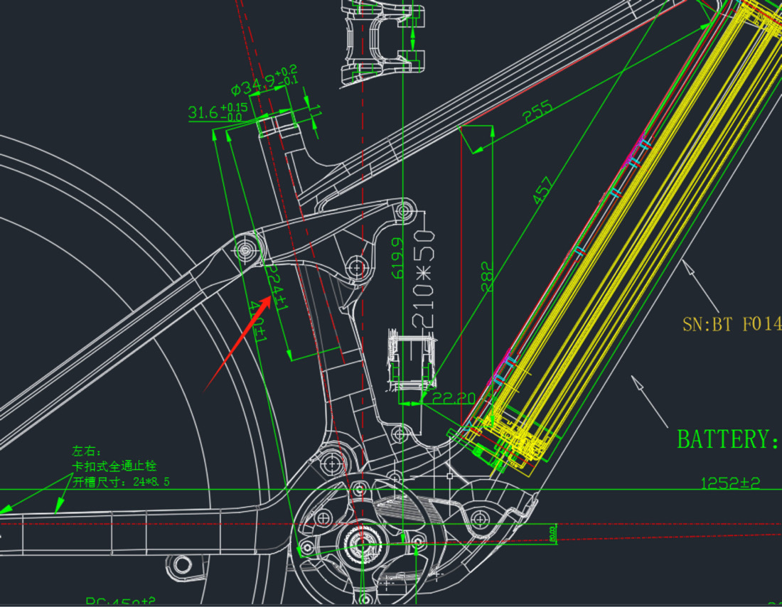

Dropper insert depth on M-size frame is 224mm according to the drawing I got from Jean.
Did you ask her directly about the max insert length? or is this just your conclusion from the drawing?
My wife's CEF50 frame size S has insert length of 234mm. It can insert all the way down to the charge port screw.
I suspect the measurement you see in the drawing is a glued piece of carbon inner sleeve?
I think it's best to ask them directly. don't assume.
I asked her directly, she replied with the technical drawing showing 224mm, I asked again if 224mm is the max insert depth, she confirmed. At this point I had no reason to ask her to double check that.

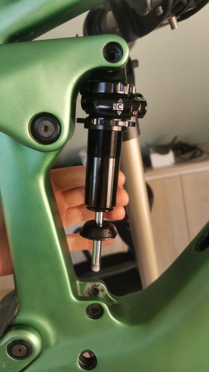

Coil will don't fit on mine (XL, received in october), coil will be in contact with frame and prevent to insert upper axis. Mine DTswiss R535 one fit very very close (less than 0.1mm), between frame (link articulation) and shok body at full extend. I don't think any restriction regarding reservoir, lot of space in front of the shok
I also faced this problem. I found an inexpensive Cane Creek DB coil 190x50. After measuring and enlarging the legs at the bottom by 20mm. The shock absorber must be installed on CEF50 V1.0
