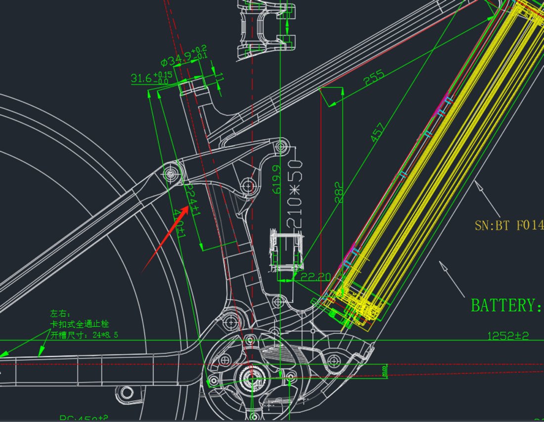

@voigtkampff "Dropper insert depth on M-size frame is 224mm according to the drawing I got from Jean."

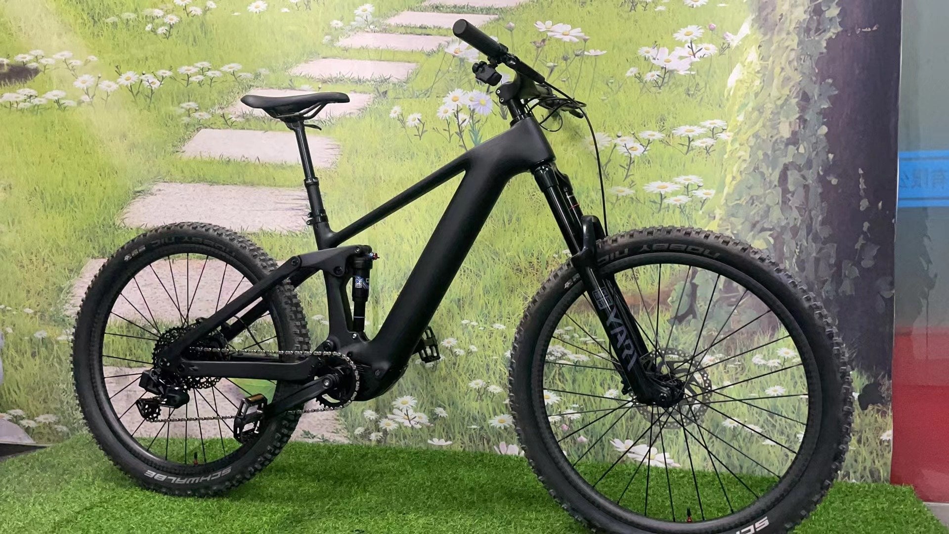

What beautiful photos. Do you know how the wires and cables come out of the frame and go into the rear triangle? You have such photos?
It looks there are only brake line ports...I believe the set up is for wireless shifting only. I'm using my wireless SRAM AXS GX drivetrain.🤙
The tell was they have a wireless setup in their complete build pics and no chain stay ports for the shifter cable.😞
But you may want to confirm with Linda that there aren't two frame versions: wireless drivetrain v. traditional wired?'🍻
Top picture looks like it has a chainstay port.
IN the top picture you can see it on the outside of the driveside chainstay. I don't think wired is dead quite yet.
But it does look stout so cross your fingers.

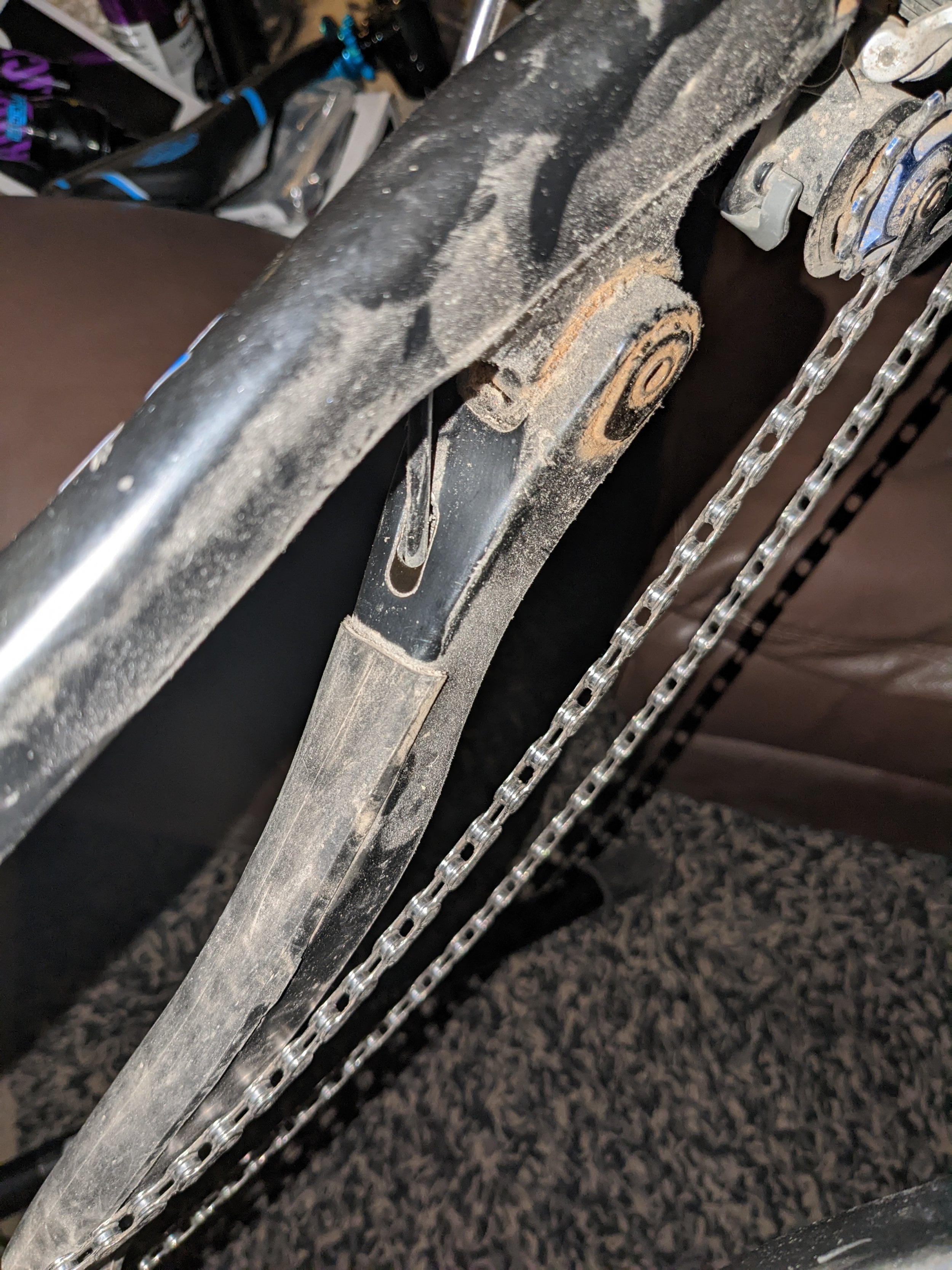

I saw it. But it's not. All 5 of my carbon frames have driveside ports dorsal not lateral. It lines up derailleur on top of chainstay with a friction-free path. Plus, the Orbea Wild has no cable ports either...anywhere.😲 Update: the Wild carbon does a derailleur side cable port...but dorsally.
Here's my Enduro analogue I'm currently repairing in the stand.
