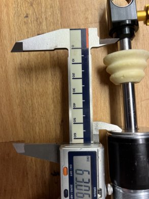

No, that was my wish. But unfortunately the inch-sized Öhlins have 6mm less travel then specified 🙈 and that without the bumper...
So i had to send back the 222x70mm which had effectively 60-63mm.
I also have measured a 216x63mm to 57mm.
So i took a 210x55 which has 52.5mm with bumper fully compressed.
Here the "70mm" TTX22M:
