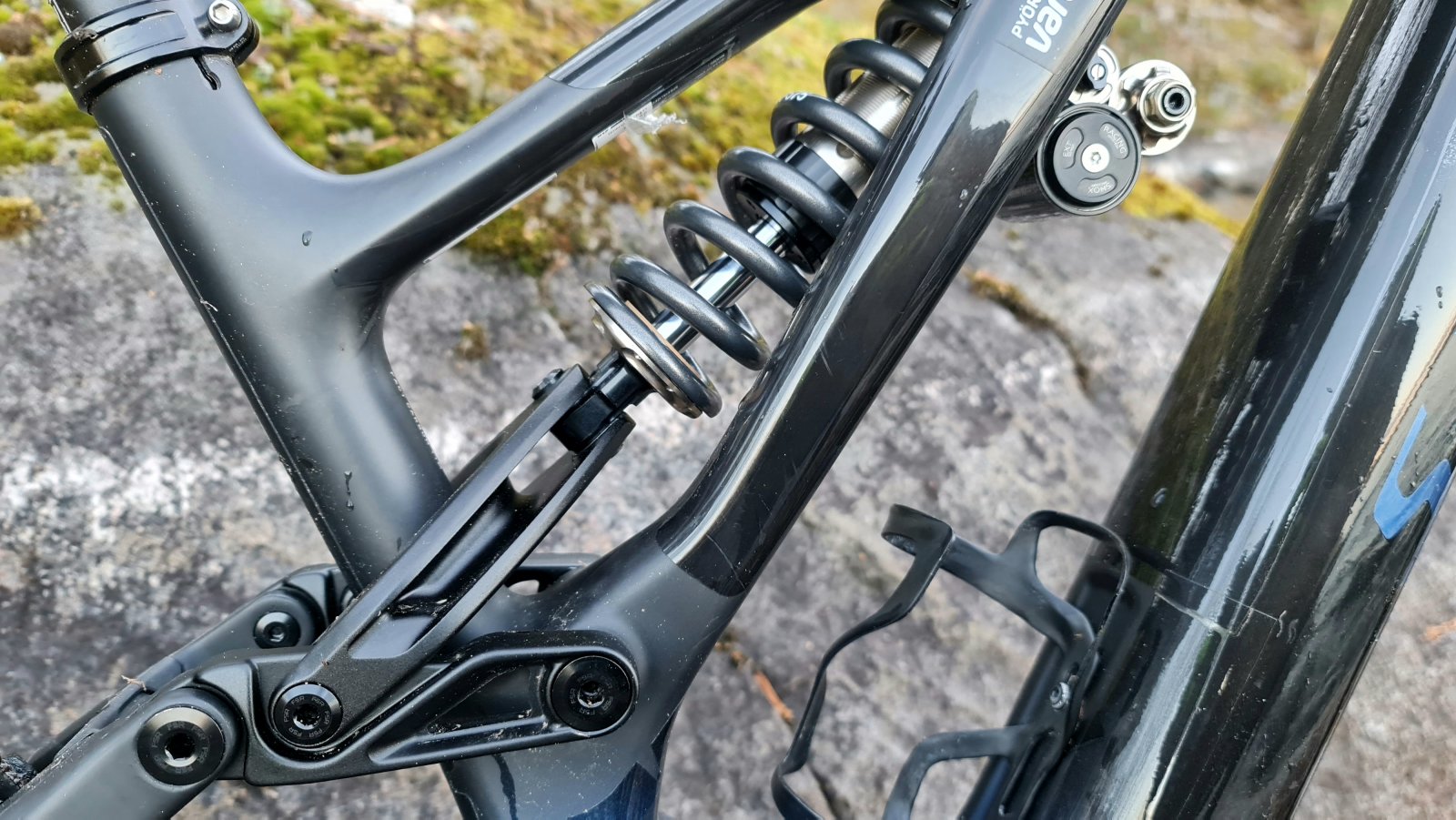

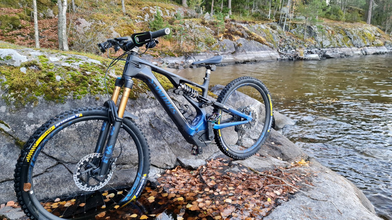

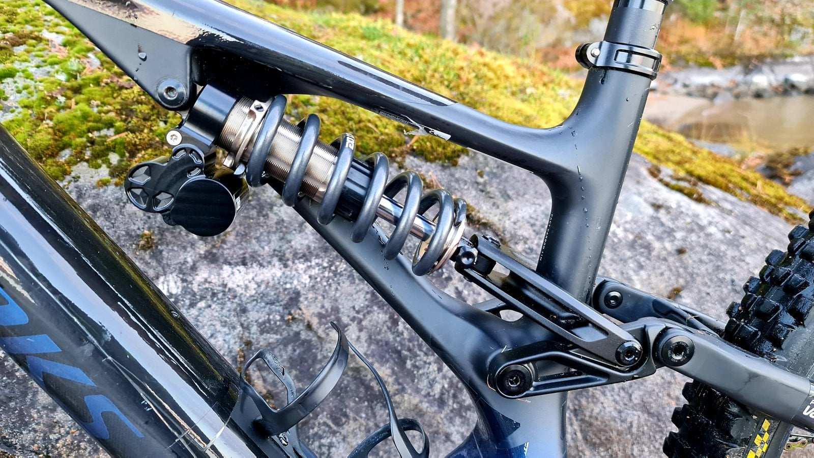

Here you go,my levo with estoria.
How do you feel ?
Estoria feels great and much different than storia on gen 2 levo. Probably gen 3 kinematics or tune is different. Hbo adjustment makes it much more progressive feeling. Maybe there's something also longer spring to do,don't know. With smashpot it feels racy feeling suspension,plush but proggressive.

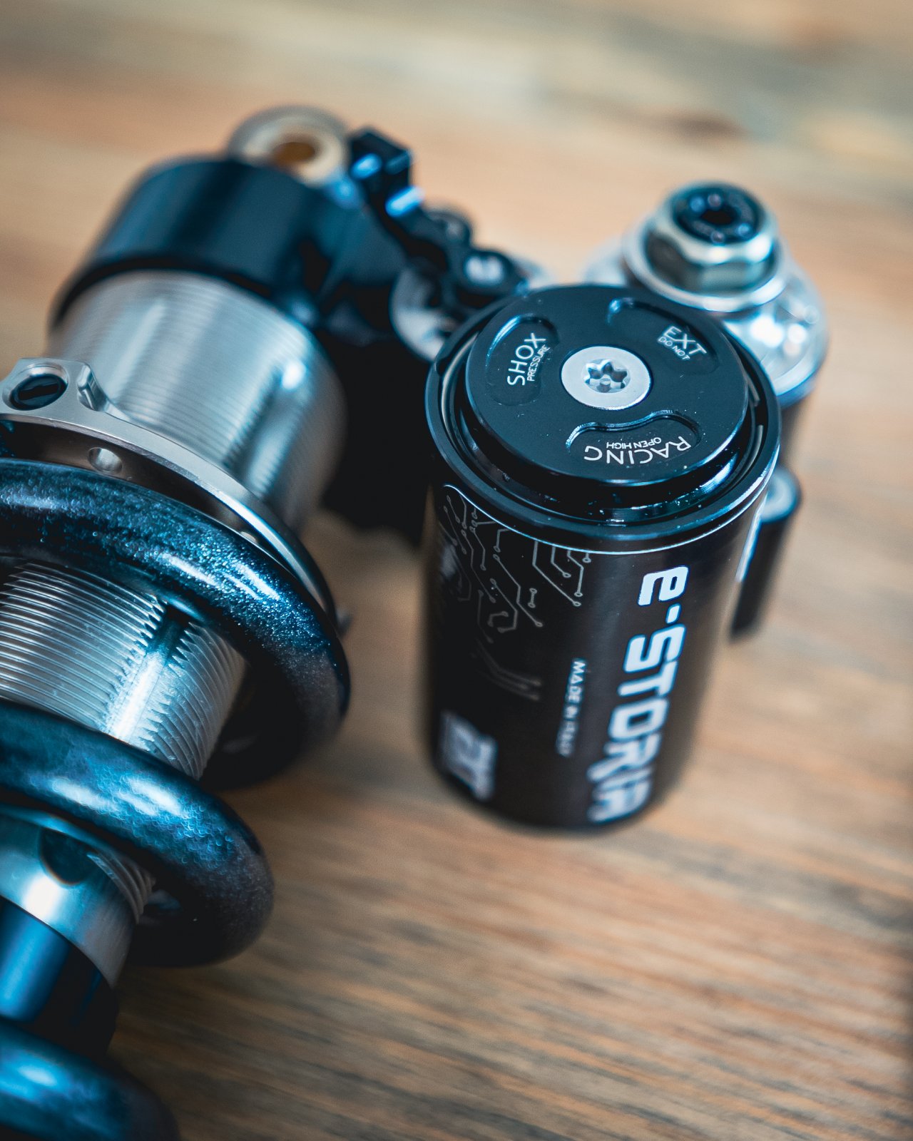

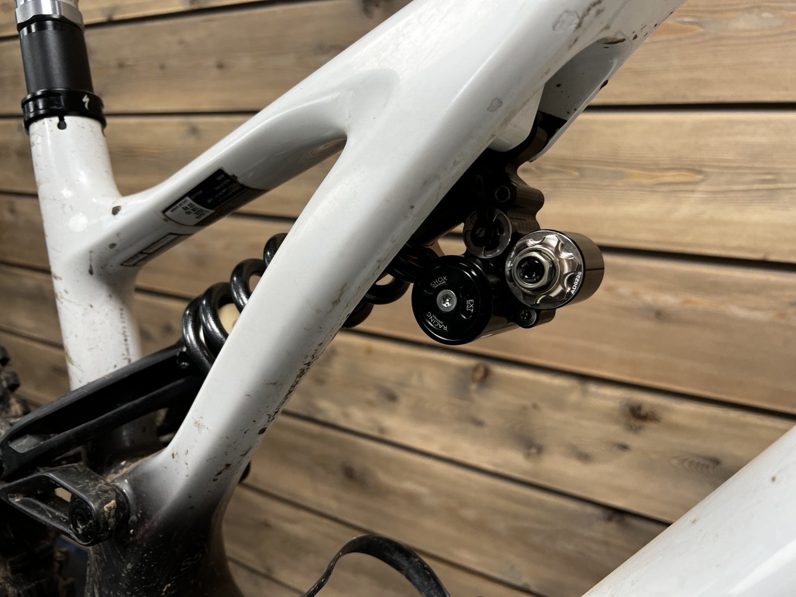

Just got the 210x55 estoria.
It seems to only have 52.5mm of usable travel...and it doesnt fit as well as the fox x2 or a dvo jade x...
I have to pull the rear wheel up alittle to fit it, anyone have any feedback on fitment?
I kinda feels like its been manufactured to small...
Photo attached
Hey, the e storia has a negative spring so when you’re preloading the spring this has to be taken into account. Bolt it in with the spring attached, then pull up on your saddle and push your rear wheel down. Then tighten your spring collar to the shock.
That’s possibly the 2.5mm you’re missing when the shock is off the bike due to the negative spring.
