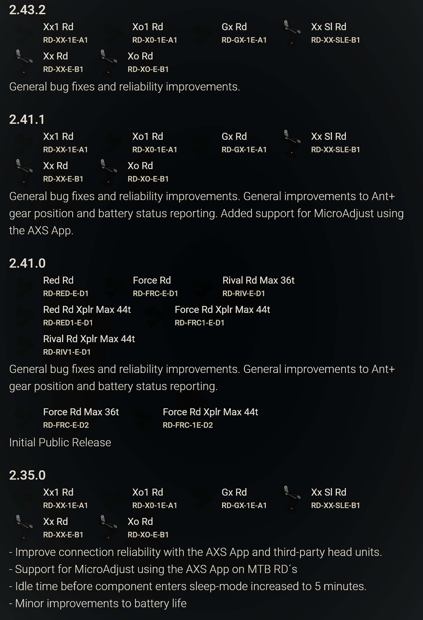

All the same FW from GX to XX1. The Road axs mechs had in app Micro-adjustment yr or more before sram finally added the same in app option for mtb axs (GX,X01,XX1) which was FW 2.35 which I updated my mech to which was about 6m after sram rep on fb group told me/us that they were testing it in beta and expected to release it april 2022. I was on 2.41.1 before updating to the latest 2.43.2 yesterday.

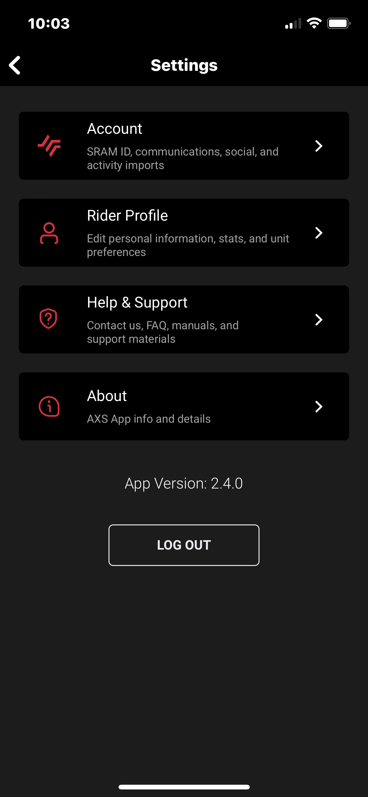

Haven’t had time to check the app out on the bike but here’s my version. IMG_6242.png

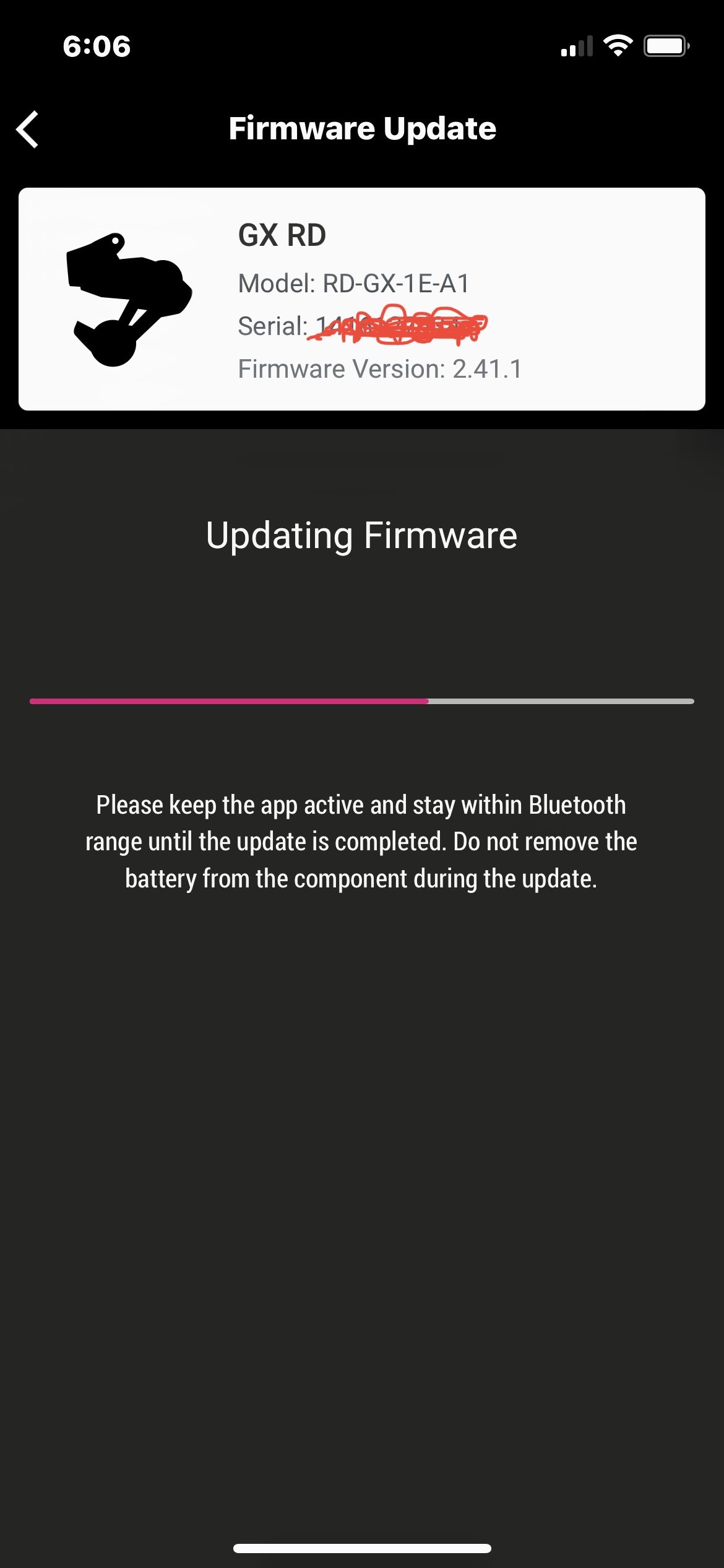

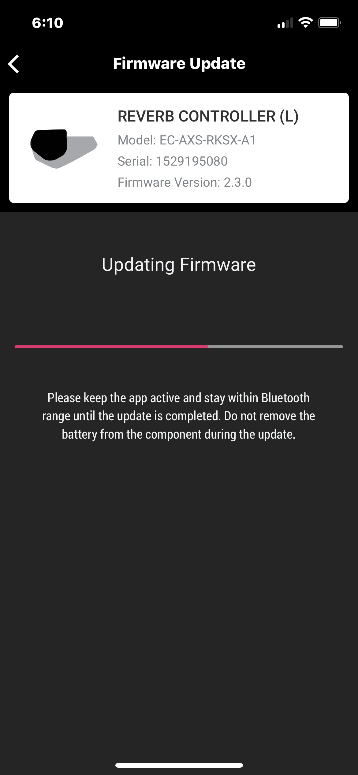

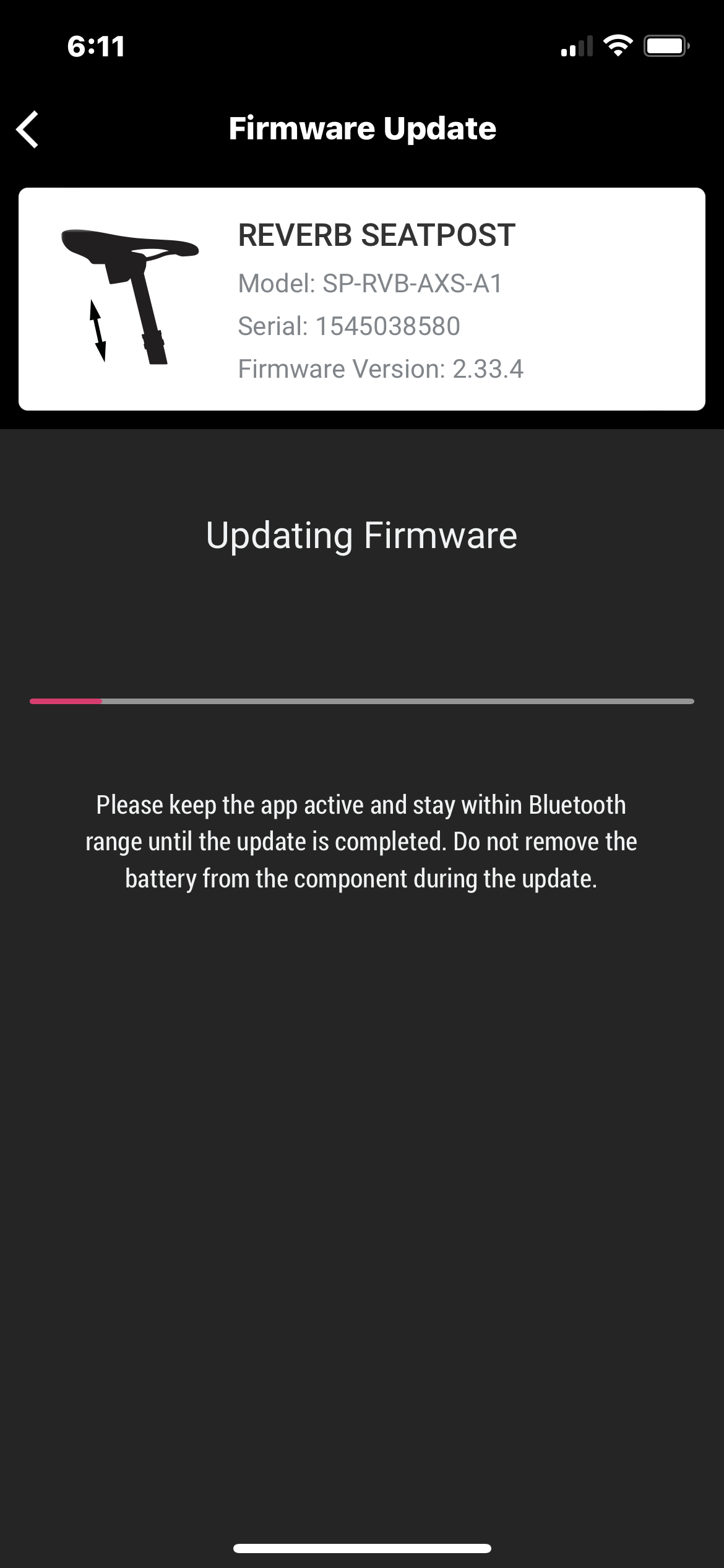

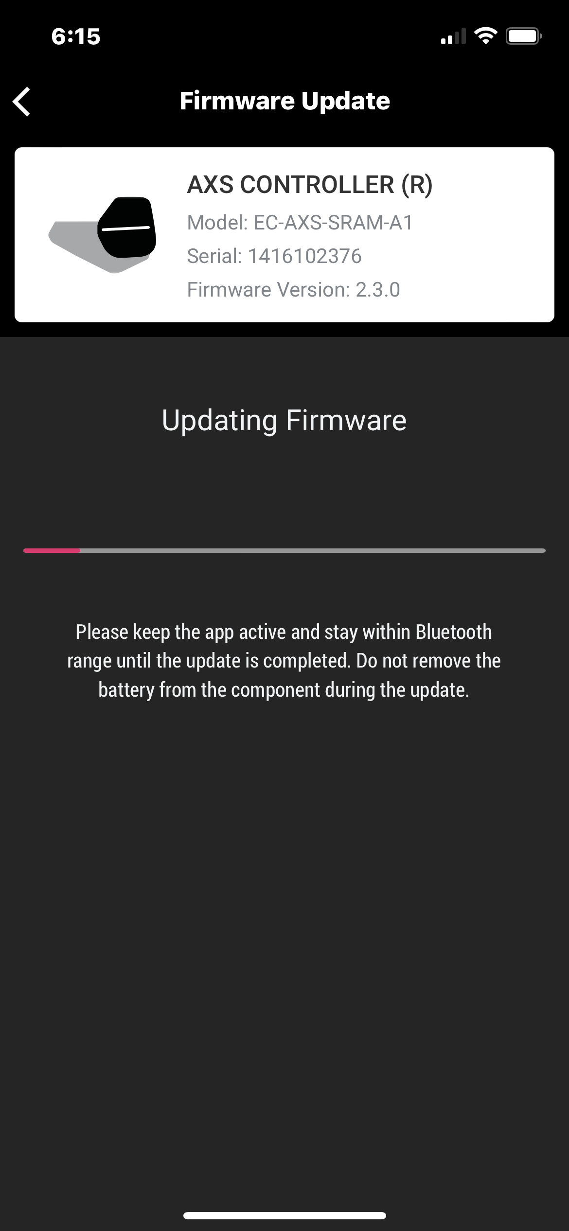

I stand corrected. I just installed the latest firmware update for the AXS GX derailer and the AXS reverb dropper.

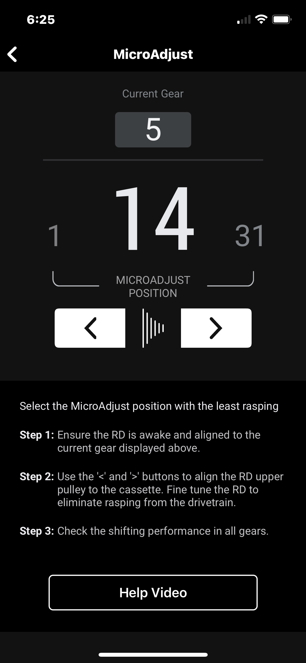

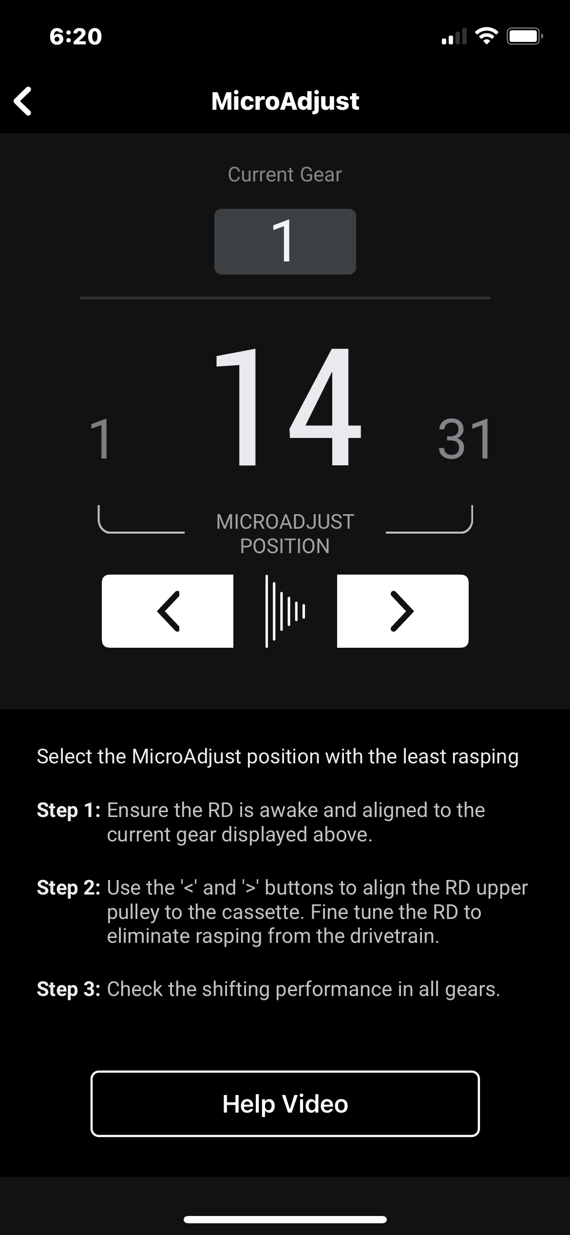

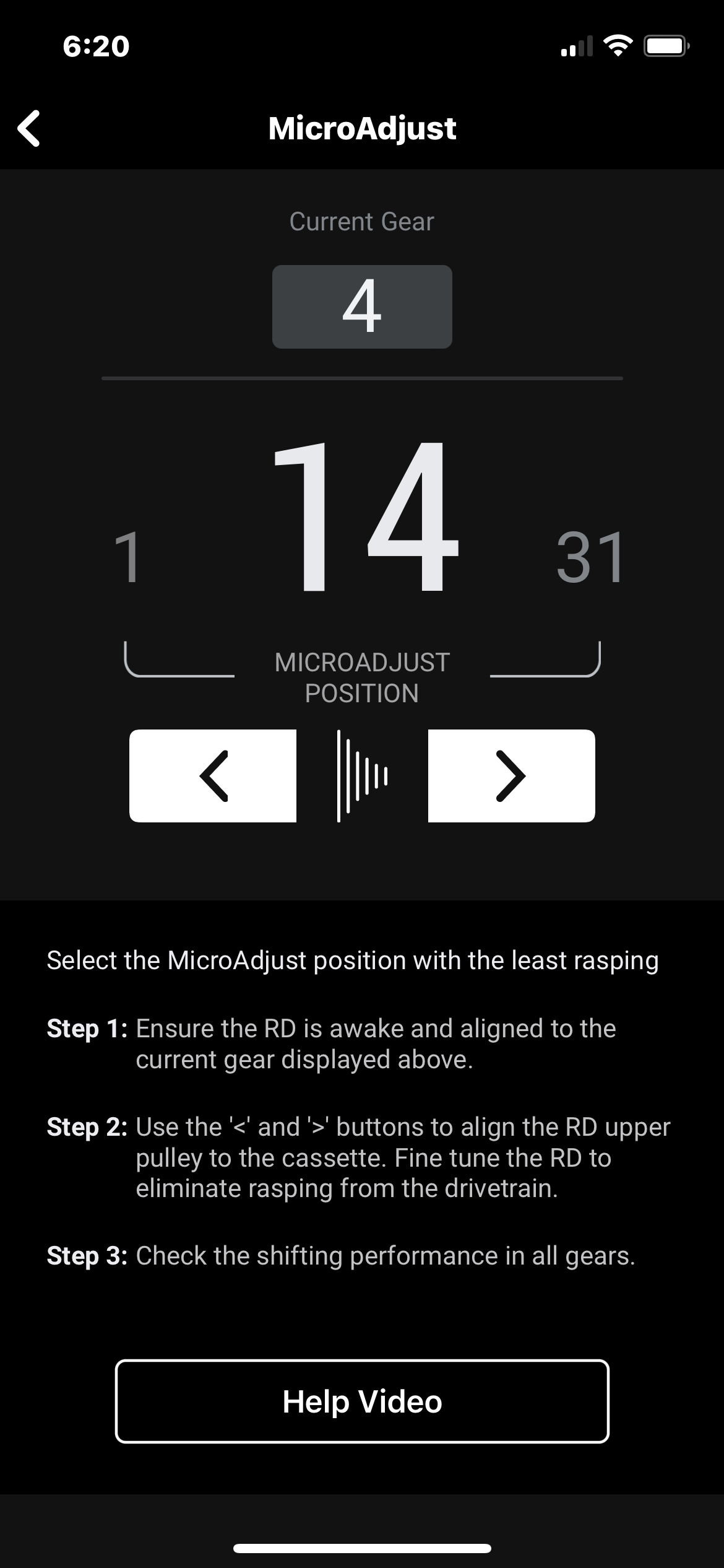

All the settings are 14 in all gears ( global) . 14 micro setting is the happy spot for all 12 gears. IMG_6252.png
IMG_6243.jpeg IMG_6246.png IMG_6245.png IMG_6244.png IMG_6249.png IMG_6250.png
Just fitted mine today. Used LoveMTB guide from YouTube. Working great. Can confirm on my gx the micro adjust is the same in every gear. Using 17 ATM but very hard to tell the difference.
Yeah, once I got past the embarrassment of thinking each gear was micro-adjustable, I set mine to 14.
My neighbour is set to 18.
