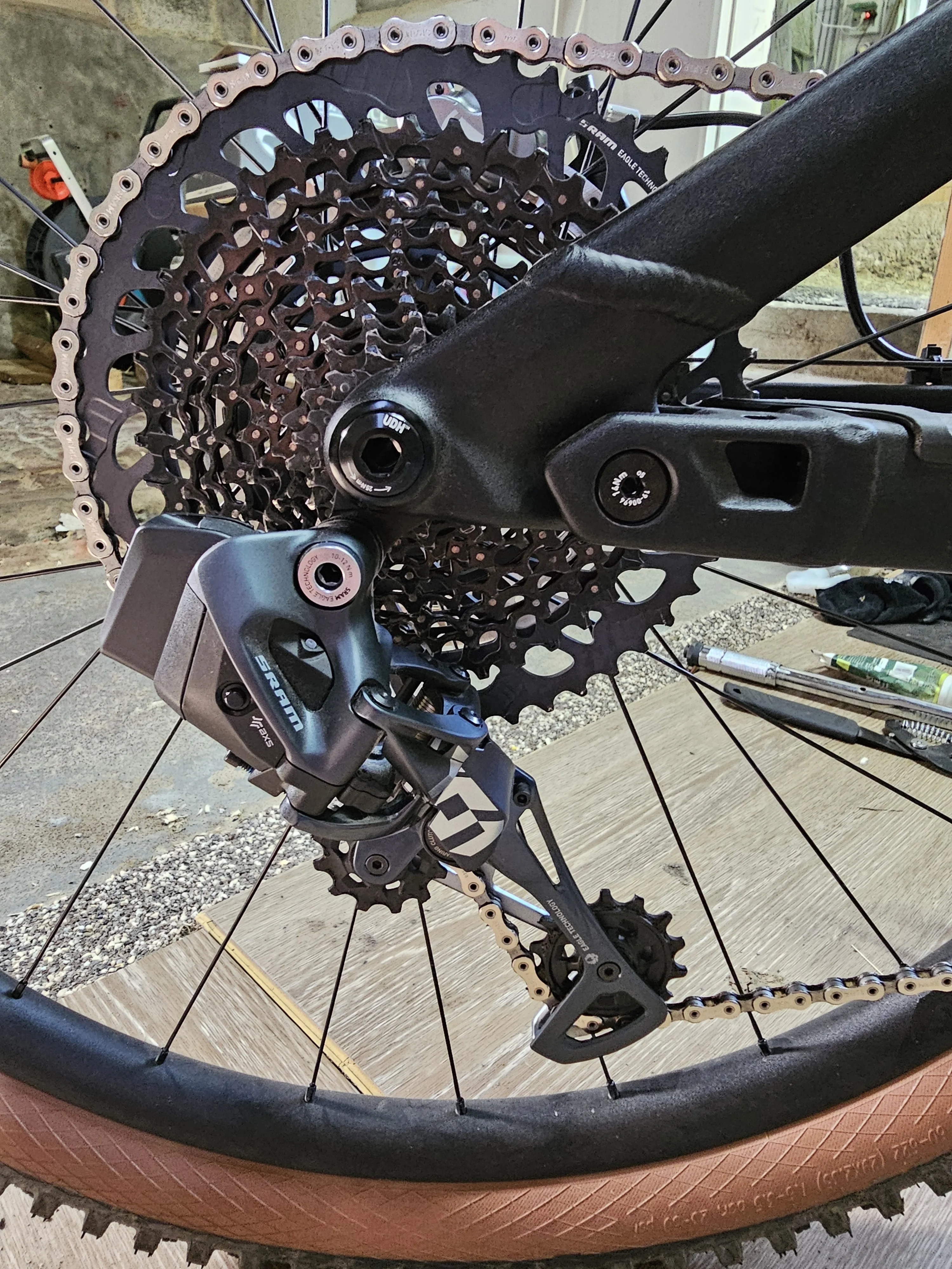

What does the derailleur cage angle look like in big-big?
This is the angle
@Greg Watts are you sleeping?
@Sander23 - It's 8:30 on a Sunday morning, so yes, briefly. Right, I can see the image now. That cage angle looks reasonably healthy - not the forward-yanked-under-tension look of a chain that's too short. So chain length is probably not the culprit here.
That actually shifts suspicion toward hanger alignment. "Tightened" the UHD hanger is not the same as "checked it's straight" - even new bikes come out of the box with transit-tweaked hangers. If you haven't run an alignment tool along it, that's the next step before touching anything else.
The other thing worth checking: is the GX cassette a standard HG freehub cassette or an XD driver? XO AXS "old type" (non-Transmission) runs on an XD driver - if there's any mismatch there, or the lockring isn't fully torqued down (~40Nm), you can get exactly this roaming-skip behaviour where adjustment helps one end and hurts the other.
