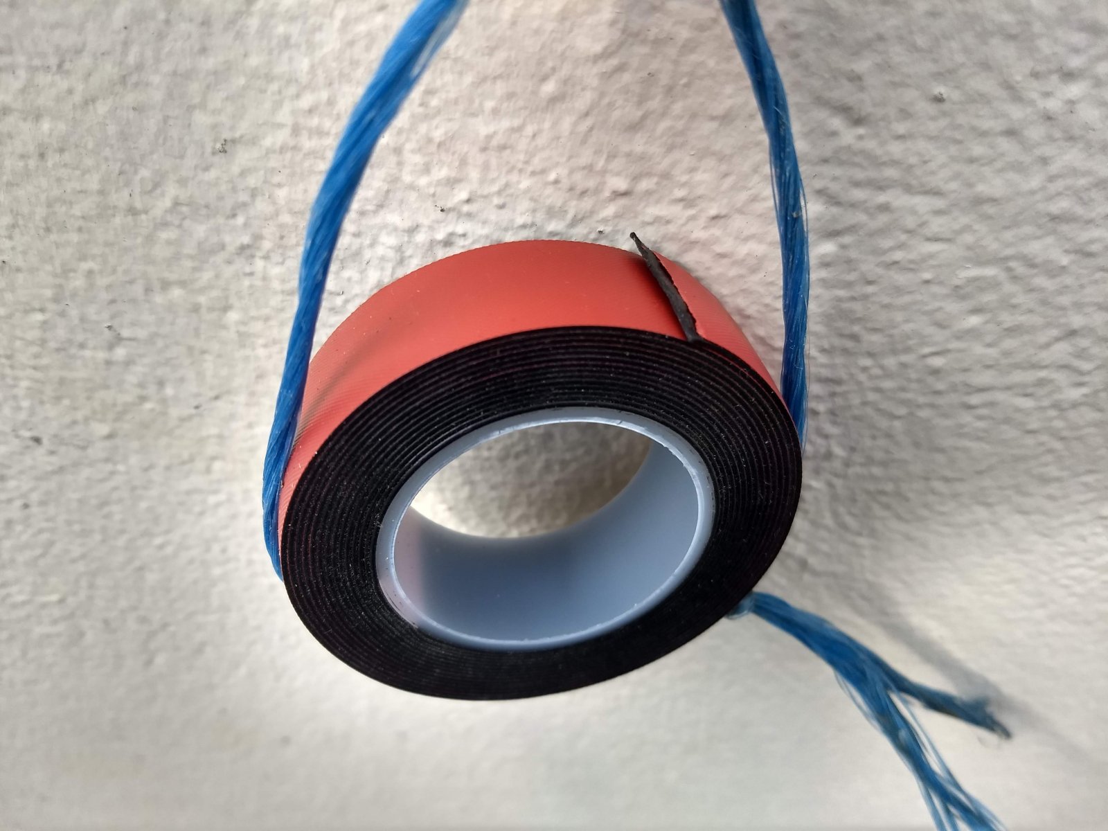

However, with Swissrob's black band aid fix, not a single squeal or scream ! Needs more testing and that was with 5 or 6 wraps rather than the recommended 3. But at the moment, if you have the ScReAM brakes, this seems like it might work !!!!
Swissrob recommended this :
Scotch® Rubber Splicing Tape 23 | 3M United States
I ended up using this, which I think is basically the same :
Cut a length off and then peel off the red stuff. That was from "Action" for about 99p

Just tried another test with the tape. Certainly considerably better than normal. I did experience two squeals - though of considerably less volume than normal. Will try some tape on the other spokes too ..

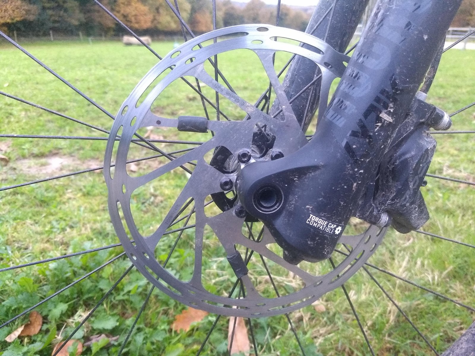

After just replacing stock SRAM 200mm front rotor for SRAM 220mm rotor brake scream in the front completely gone.

My rear Code-R caliper seized three pistons, so it seemed like a good sign to change it.
Installed a Zee caliper and lever. This is an easy straight swap and everything lines up and works correctly with the SRAM rotor.
The Code-R lever and the Zee lever are both basically the same shape and size, so they both feel the same from that respect.
The disk was thoroughly sanded and cleaned.
A quick ride to bed in and clear some fallen trees off the fire roads for a test.
Interestingly .. they still scream ! So it is the SRAM 200mm rotors which resonate. They only screamed once wet.
Feel wise, for me I prefer them. I didn't find them grabby - this was a super slippy sloppy mud fest and I felt like I had perfect brake control. I found them to be more predictable and effective - especially when wet. The SRAM's sometimes feel like you're just squeezing a sponge wondering when it's actually going to do something, the Zee's just add more braking corresponding to how hard you pull the lever. The SRAM's performance drops off hugely when they Scream, the Zee's felt exactly the same when screaming or not screaming :-)
