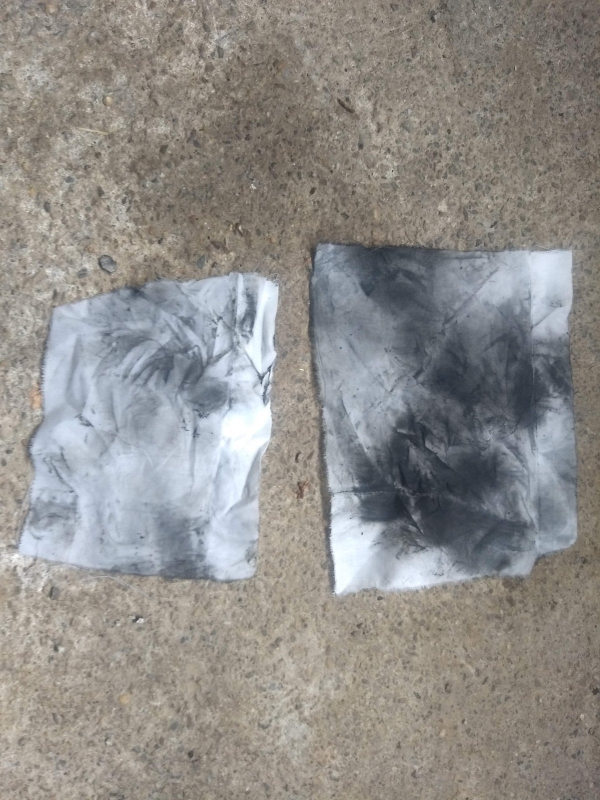

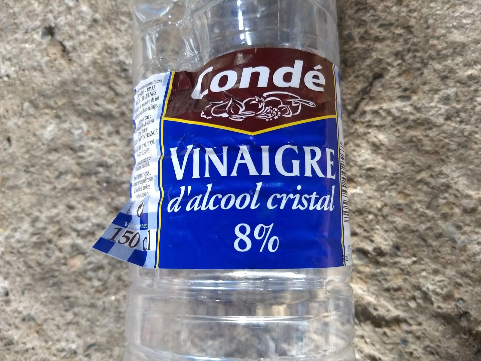

Started with @GrandPaBrogan's minimum contamination system, stripped naked and used White Vinegar to clean the disks .. Quite impressive what came off when you consider I cleaned the bike yesterday.
Right cloth, both sides like that, first clean. Left cloth, both sides, second clean ..
Vinegar is your friend ..
@outerlimits & @Rusty probably uses it as a nice after dinner digestive as they chat on Skype about the good old days of cast iron frames..
Stripped and cleaned the pads and calipers. Sanded the disks and calipers with 150 this time instead of 800 last time.
So will go for another drowning session later, try to bed them in again and see how we get on.
Vinegar is acetic acid so will dissolve salts but not oil based deposits. You need to use isopropyl alchohol.

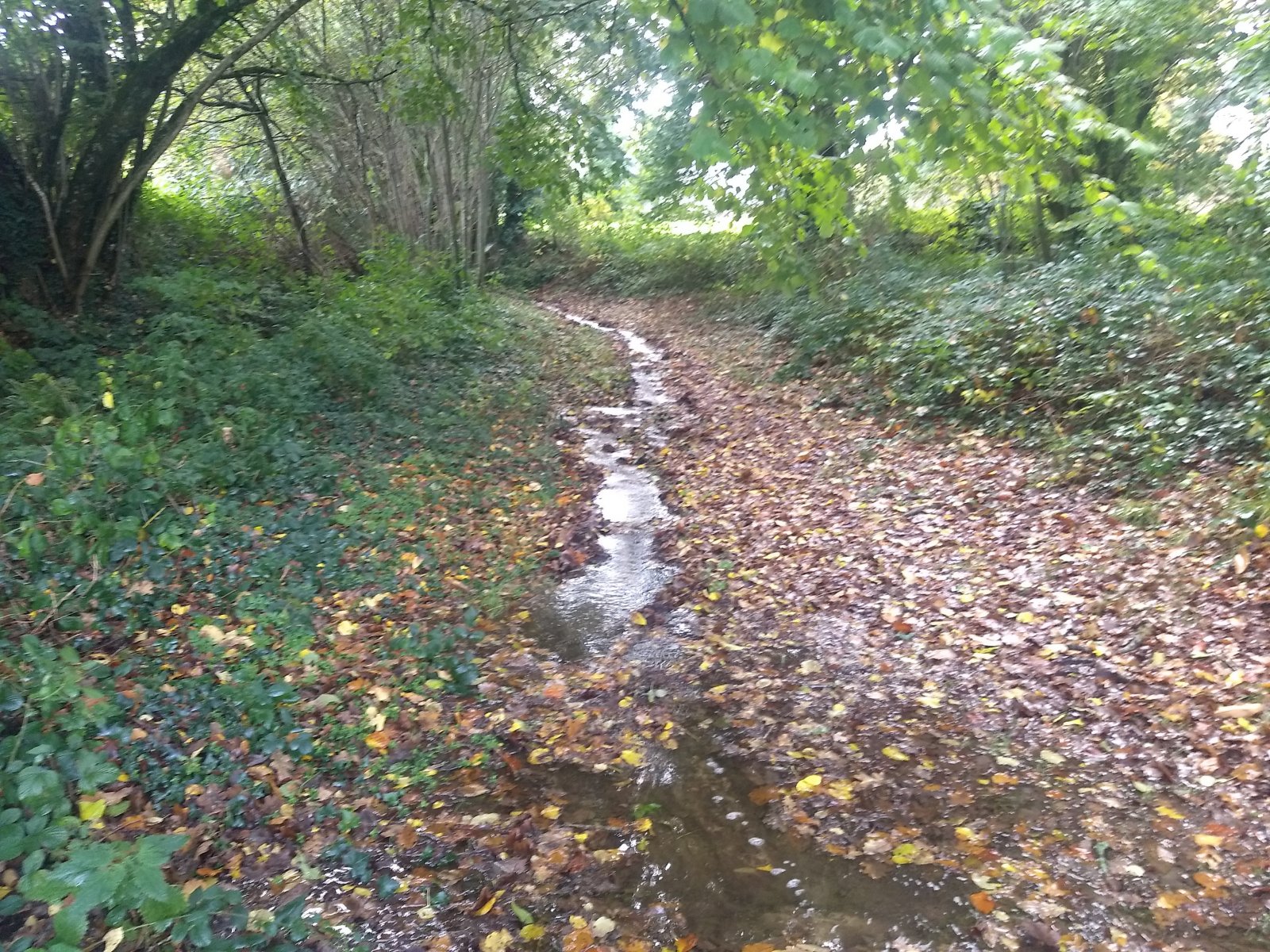

It's VERY WET .. most trails are just flowing rivers at the moment. Didn't do any black runs as one of the ones Friday had half eroded at the bottom and was just huge pointy rocks and bike (or rider) swallowing crevices. The guy I met last weekend said it was closed, I though he was just being a bit of a softy..
Here's one on the edge of the forest .. it's just yukky ...

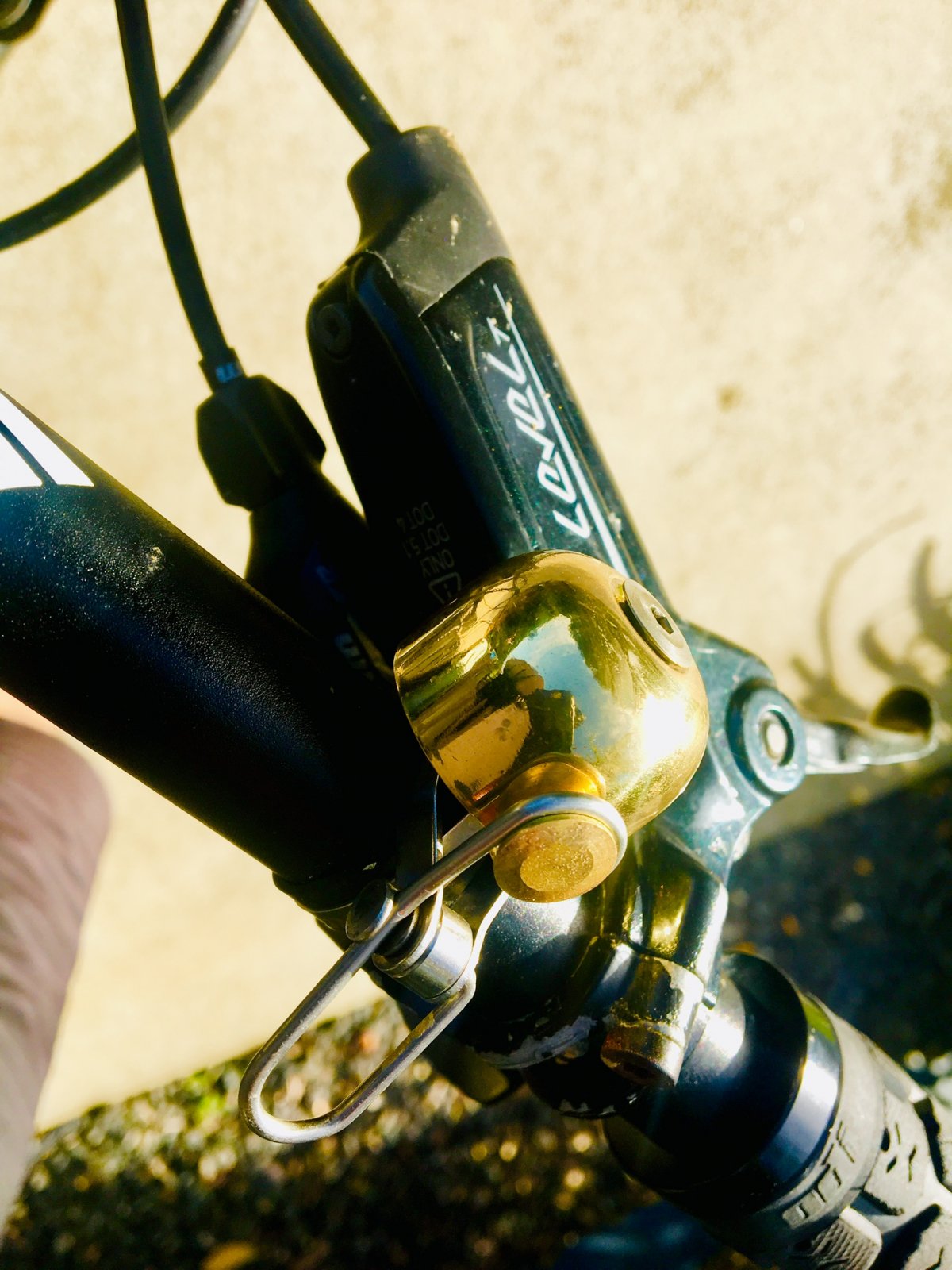

Ah ha .. that's what does it ! Don't need a bell though if you have SRAM !
I have SPAM brakes and they don’t make noise in the wet or dry ?‍♂️ When looked after properly. I have a bell, it is big and loud and shiny. I fn love my big shiny bell ?

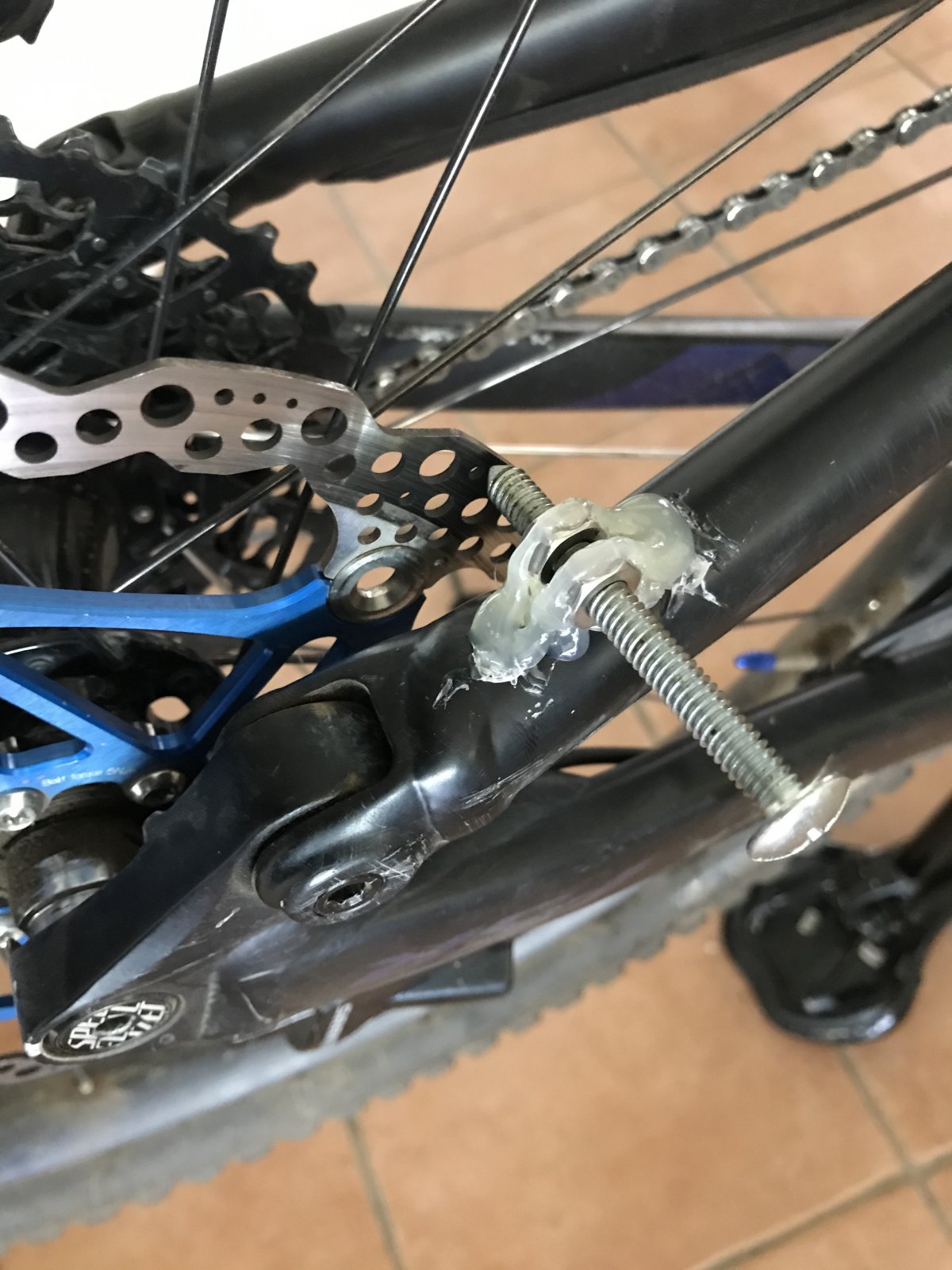

Sadly no snow here or due .. just rain .. so they've been re-aligned repeatedly at home and out on rides.
