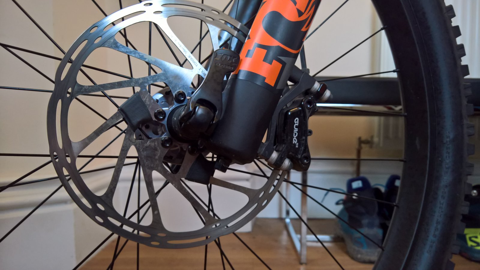

My tip from a while ago.
I haven't seen this mentioned much before but I use Scotch rubber splicing tape (self vulcanising), cheap, indestructible and never comes off. I also use it to make 2 or 3 rubber dampers around the spokes on my brake discs, the end of noisy brakes forever also less vibration on discs extends pad life. Scotch® Rubber Splicing Tape 23 | 3M United States

Interesting ... found your other posts about using it (though only now).

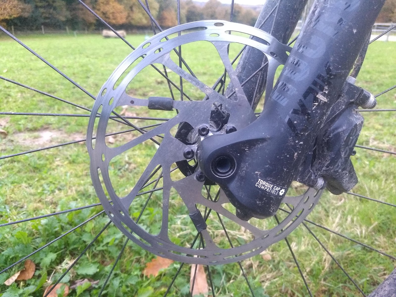

@mark.ai followed your suggestion and applied the tape like this :
Is that correct ??? Or would you wrap further along an individual spoke ?
I wrapped it further along the spoke but the location is a bit dictated by clearance from the caliper, ideally 3 layers or wraps but start off with 3 equal length pieces a bit too long as you need to stretch it to get it to stick, lastly cut off equal amounts of excess so the disc stays balanced. Reminds me I must do the Levo as this is getting noisy in this wet weather.

As any impatient moron should, I carefully didn't follow @Swissrob's instruction to the letter.
So in a quick test I cut and wrapped spokes 1,5 & 9 with a 6cm strip of the thick self amalgamating tape (has a peel off backing - or fronting... , or the one I used did) This resulted in about 5 or 6 wrap arounds rather than the recommended three - which instantly ruins the test :-)
Then, as this was an impatient - only 10 minutes to spare, test .. I quickly shot down the road and went head to head with a 60 tonne triple axled massively overloaded maize/corn tractor in a test of squeaky brakes .. Both vehicles braked furiously from about 25kph. I was pleased to say that in terms of braking distance, my 100kg's all up easily out braked his mere 600 times more mass. For ScReAM though, I'm going to give the win to the tractor .. it was close, but I think he was slightly louder - so maybe the tape reduced the volume ..
Will try again tomorrow with three loops of tape and go for a proper ride and get the brakes warm first.

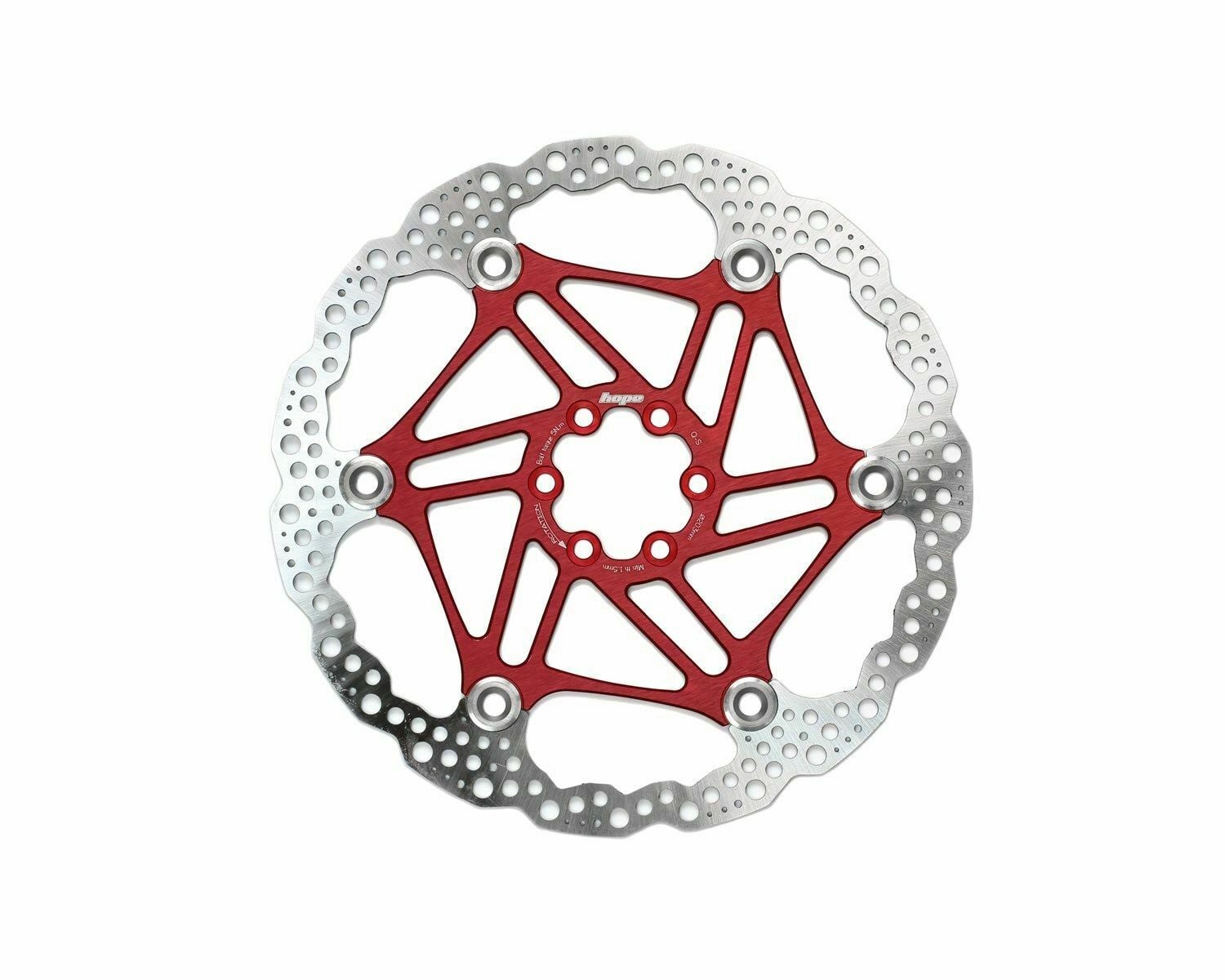

Has anyone tried swapping for floating disks ??

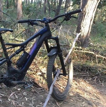

I have managed to bend rotors still as there are some big sticks around my parts that like to hitch a ride.
I was lucky this one was not on the rotor side.
Floating discs are IMO terrible idea on an mtb and just cause even more grief.
Would you run a 6 bolt disc with all 6 rotor bolts loose? Coz that's basically how they feel in use.

I have run my rear “floating rotor” disc with all 6 bolts loose. That made it a “super floater” and it still worked flawlessly. If you have had poor leaver performance whilst using floating rotors @Gary maybe you need to work on your hand strength ?‍♂️
