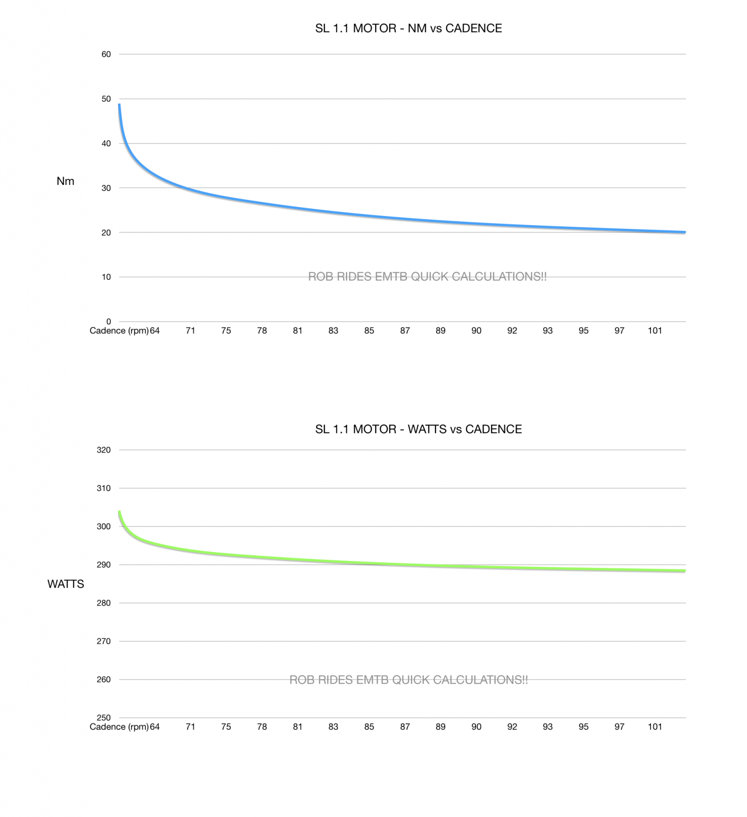

I did some data mining using BLEvo and a calulation to work out NM from a motors given Amps / Watts.
I cannot validate this data but here's a quick graph I made from the ride data:
I didnt pedal to high enough cadences in my last ride as i didnt anticipate making this graph. But you can see the NM quicly drops off after cadence 65. But Watts remain high throughout cadence. I'll work on it a bit more to look at wider cadences.
I only used data from 100% Turbo mode with fresh battery.
To add: this is all based of data I captured using BLEvo that gets the data from the SL motor. It is interesting none the less...
I will do the same to BROSE. All we need is BLEvo to work with Shimano / Bosch / Fazua and Yamaha... @PaoloBLEvo !!!
#dataiscool
