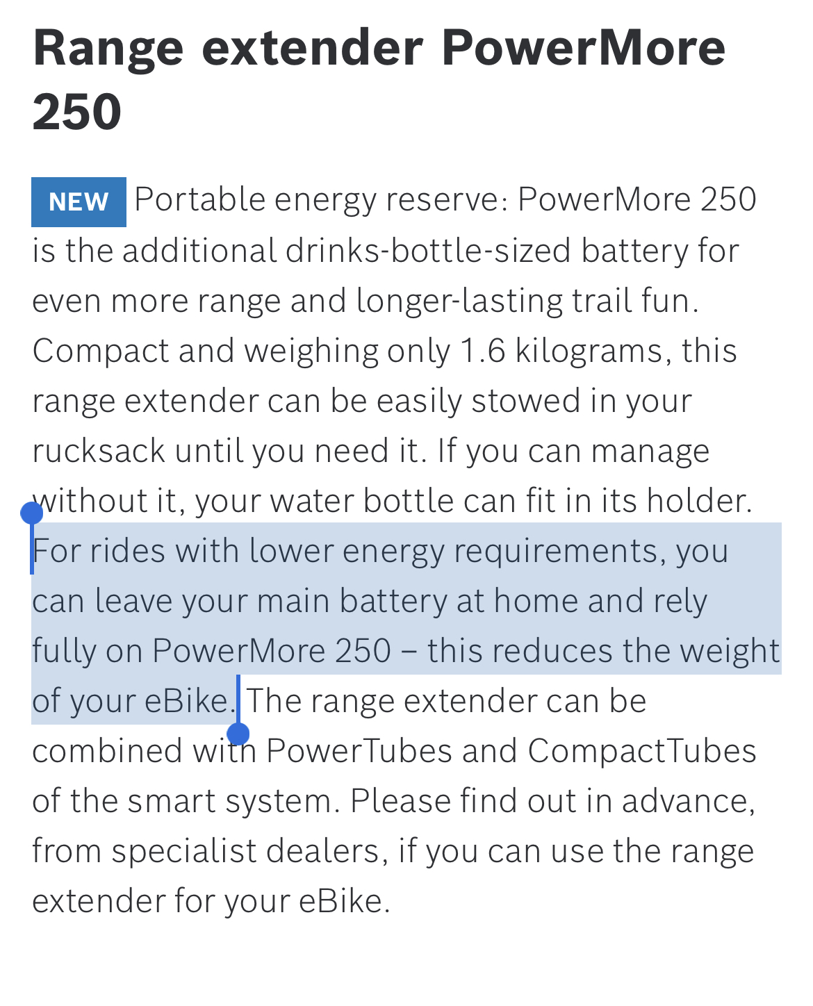

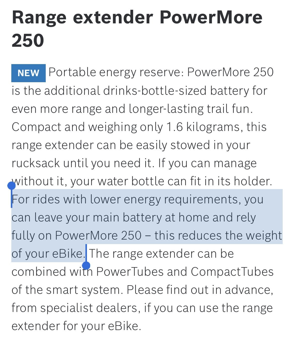

Interesting. According to Bosch site it’s possible to run bikes on just the PowerMore.
250wh PowerMore is 1.6KG
750wh Powertube is 4.3KG
Seems a quick and easy way to shed 2.7KG of battery for those 1 hour quick blasts.
