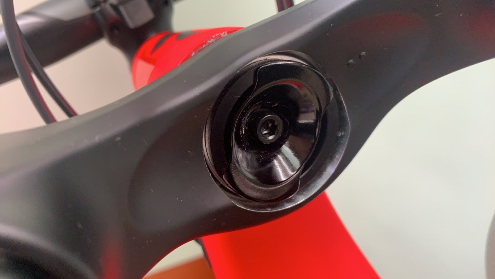

Hi Rob !Glad to see all these useful information, as current owner of a brand new Levo SL Comp 2021 . My previous Kenevo expert sold at once after one year of usage and only 470km performed....
I would like to ask if anyone knows what is the exact tightening torque for the front fork in order to disappear-reduce any “play” ?
Thank you
Thank you
You just need to tighten your bike's head set
Thank you
There is no torque figure, it's done by feel more than torque, same with any aheadset on any bike. Lots of info on Youtube.
