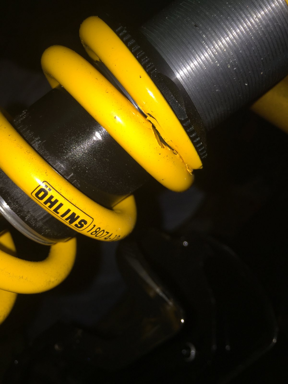

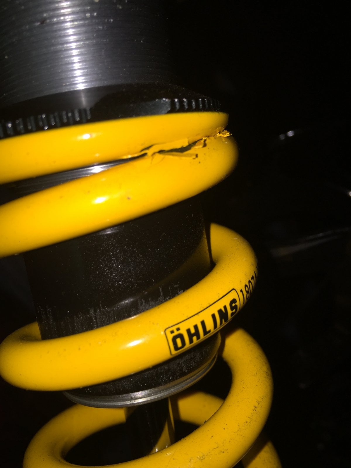

Only had my Kenevo a couple of weeks and have noticed that the yellow coating has started to crack on the öhlins spring. Has anyone else had this happen to them?

Only had my Kenevo a couple of weeks and have noticed that the yellow coating has started to crack on the öhlins spring. Has anyone else had this happen to them? View attachment 6130 View attachment 6131
Mine did that. All springs have coils are painted together at ends from new so bound to do this once they get some use. A bit annoying. Bugged me a bit too

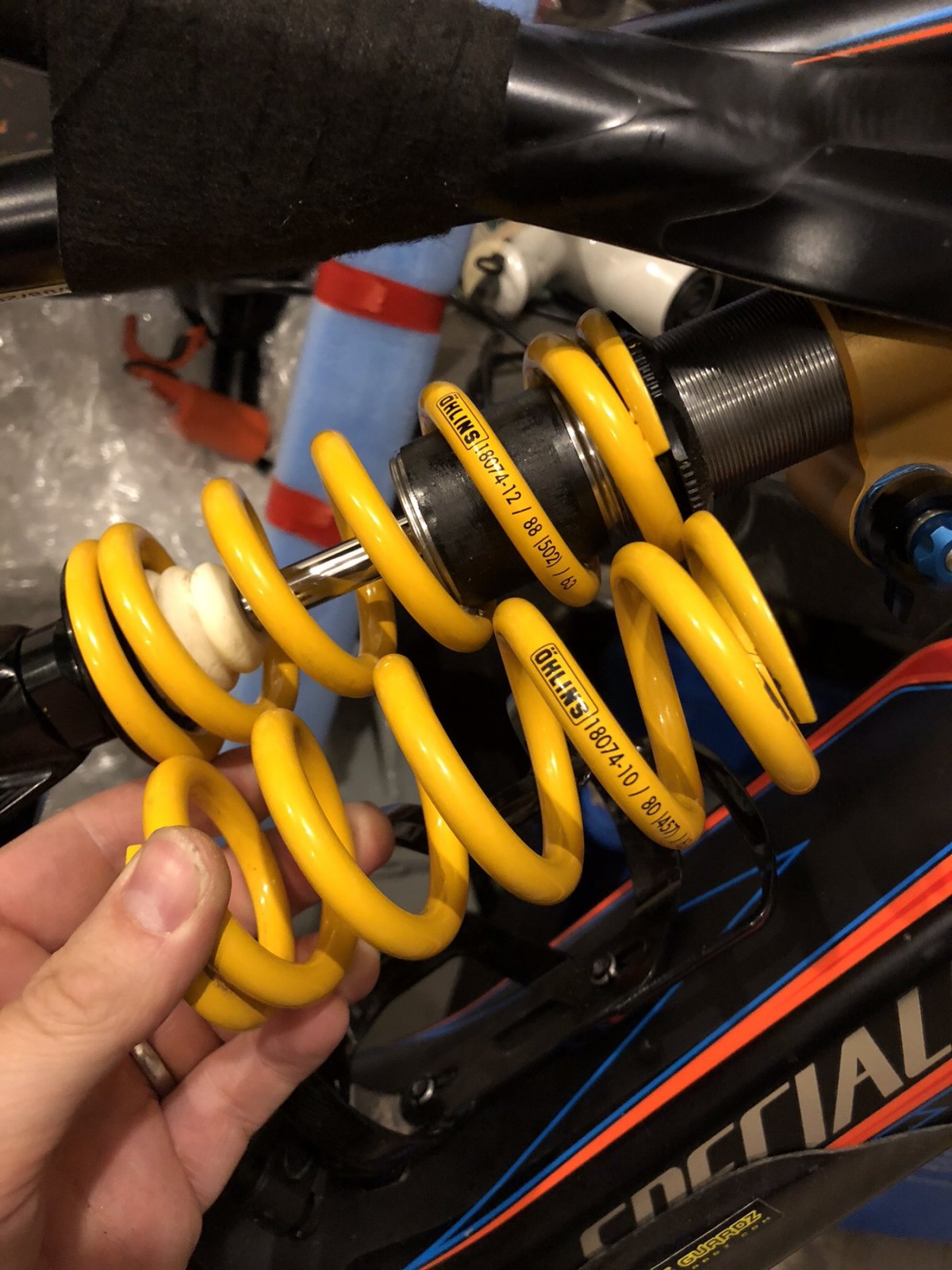

Awesome info Rob! Thanks for posting. Question, the rear springs for the Kenovo are offered as “demo” for around $50, and a regular version that’s $100. What’s the difference?
