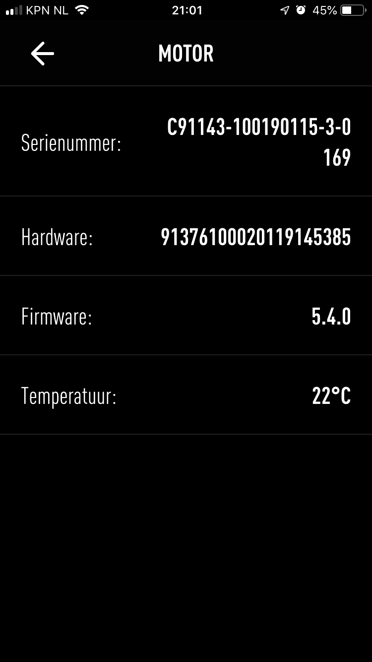

what is the latest update? I have two weeks ago a new motor in my 2016 Levo. previous motor on 4.4 firmware. new motor on 5.4 firmware.
my bike is in shop, but i think i’m still on 4.0.1 - i thought they stopped updating the older stuff. BLEvo is working perfectly, i don’t want to mess that up.
what hardware do you have now? im gonna have to check in on blevo thred about this!
