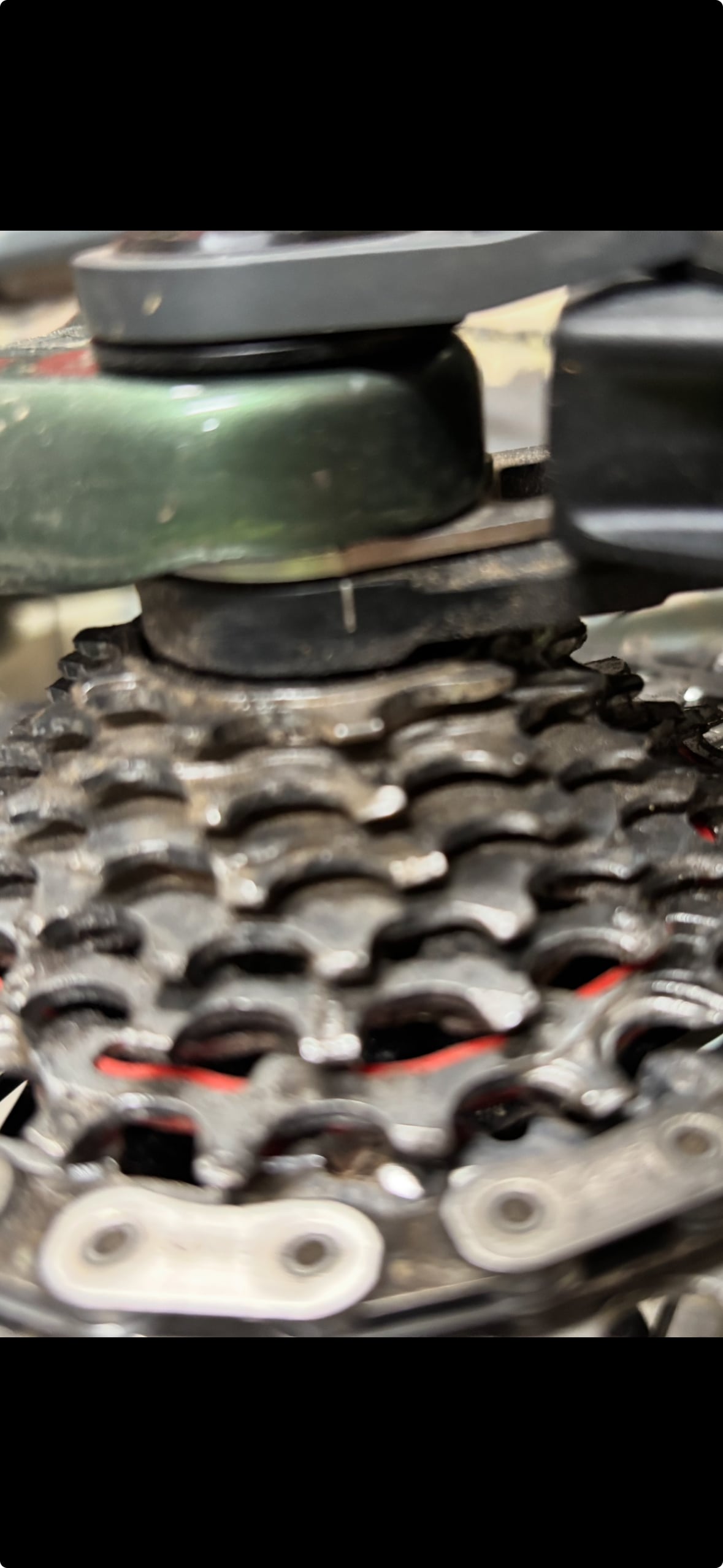

So to give a update they swooped the cassette again to a XO and chain worked for about twenty minutes , then it slipped again I’m so frustrated right now , everything on the rear end has been swoped the only that’s left and no one wants to admit it is the motor’s gears are …..ed , surly if I spent $15300 on a bike Specialised would want to be actively involved to get it swoped or fixed , from the first day that I rode the bike I recorded videos and sent it to the Bike shop , they have tried everything to help but no joy. I own a business and if my client is unhappy for any reason the issue is sorted and corrected ASAP but it’s almost like Specialized doesn’t want to get involved to help (and I’ve bought three bikes in 5 months from them with a another(number 4) Levo on order) 😫

sounds like the chain is too long or you missing a tooth on an idler.
Did you check the # of links and/or try a new chain?

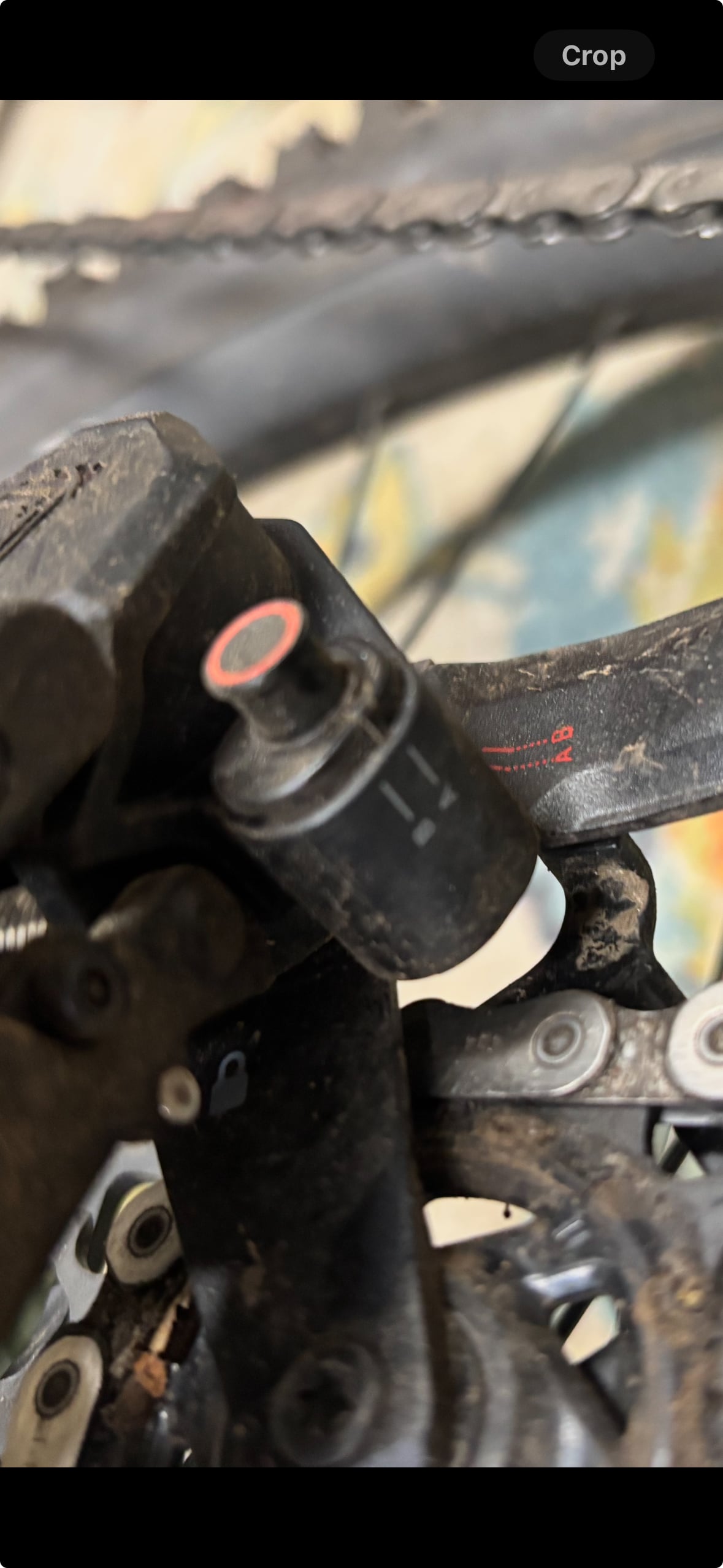

check that the hash marks align. There are two settings a-b so make sure its on A, check the chain lenght in the smallest gear. good chance you have to remove a link. also you could be at the far end of the adjustment range and the app will tell you if you are, set back to middle and follow the setup intructions
View attachment 160420View attachment 160421
yup this was all done , they have tried everything right up to Specialized telling them that there’s a defect int he free hub and they need to check that (which they did and it’s not that either ) Told the LBS take the bike back and refund me rather really not getting any help from Specialized on this

It’s definitely Specialized problem if they telling the Bike shop (ohh sorry there’s actually a issue with the free hub ) which the bike shop checked and it’s not
They have changed chain cassette etc etc etc three times now and done all you mentioned above , this bike has done this from day one and specialized kept quiet about the factory issue with the free hub makes you think what else is problematic with this model

Really isn’t the LBS specialized eventually admitted that There’s a factory fault with the free hub , the guys at the shop have done everything in their power changed the cassette changed the chain , they have been fantastic specialized in the other hand is a issue . This bike was a issue from the day that I received it and they are a specialized specific Dealler , So the bottom line is line shop is great Specialized on the other hand is extremely questionable
Why would to motor be the source of the skipping issue? Have they tried a new derailleur?
