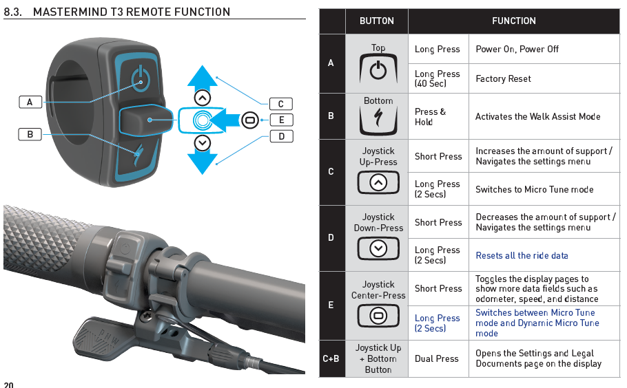

Correct. I always press the center knob up first then press the bottom button to avoid shutting the bike off.
Yes entering this mode is the worst, I have mistakenly hit the top button and reset my ride and even turned off the bike.

Do you mean....... push the center toggle down and the bottom button at the same time to get to the correct screen to enter class3?
So according to the manual its joystick up + Bottom Button. Once in the settings menu you scroll down and see the class selection.
Do you mean....... push the center toggle up and the "S" button at the same time to get to the menu screen, then scroll down to the speed screen then select 28mpg which is class3?
Yes but it's hard to get it right pressing at the same time so I always press the toggle up first then the "S" button to get to that settings menu.

It did not have to be setup at my LBS, just needed to access the settings menu and select class 3
Interesting when I was picking mine up I had to log into the app and register my bike before the lbs was able to add class 3. It was about a 10 minute wait for them to load it. This is in the US.
Well yes the bike does have to be connected to a computer to start update firmware and link the bike to the app for ownership and warranty, but the class 3 selection is just selection in the settings menu
