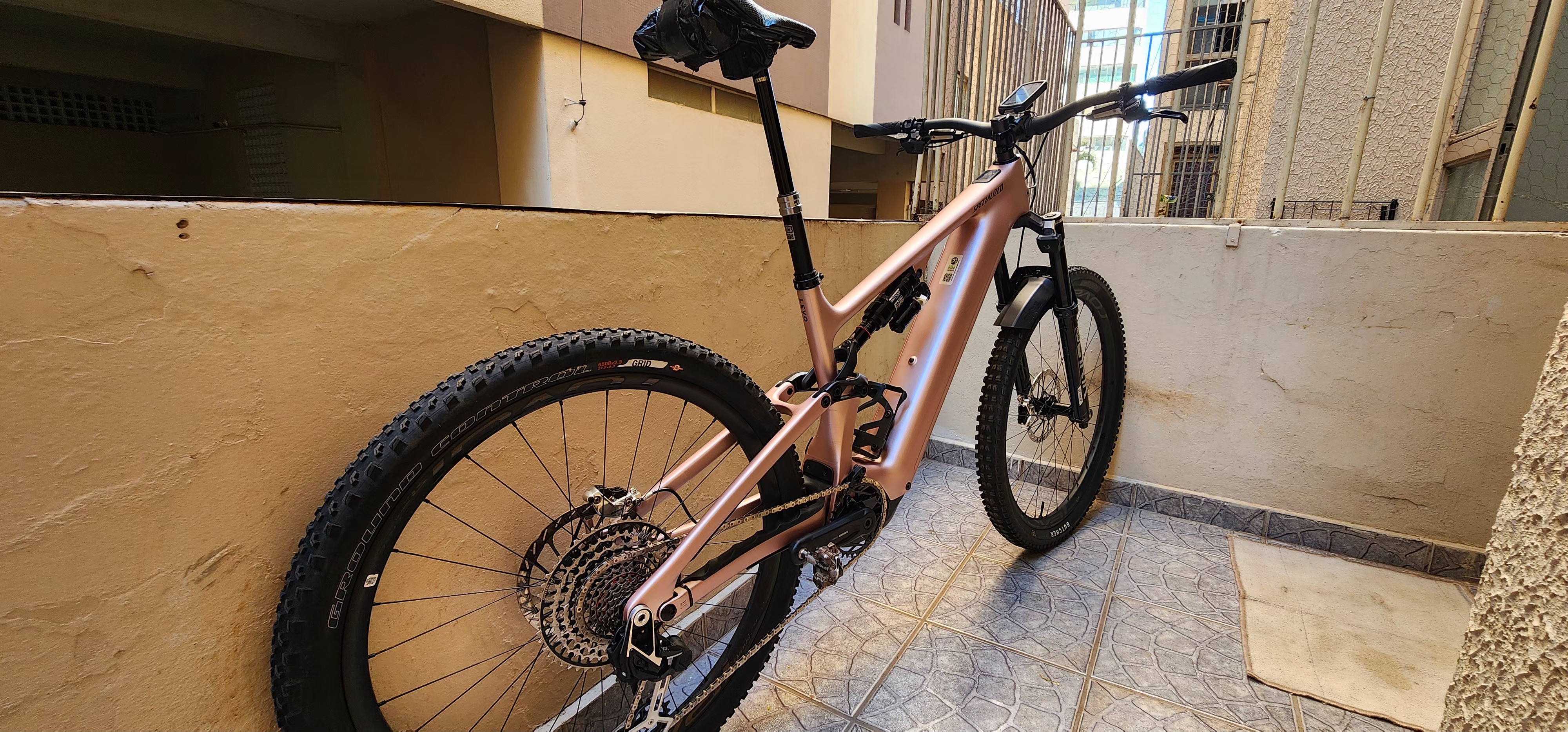

Did some testing today with shuttle mode set to high. If you recall the Velomotion test, they found that with 100 watt rider input the S-Works motor produced 406 watts (so about the official 400% assistance). That's without shuttle. I was able to max out the motor (680 watts on the display for 3.1 motor) with less than 100 watts. The number jump around a bit, but I think around 80-90 watts rider input is enough, meaning the assistance is around 800%. About the same as DJI.
Only the normal eco, trail and turbo modes are affected by shuttle. Auto, microtune and dynamic microtune stays the same. This is confirmed in the motor tune in the app and display as shuttle mode is unavailable if one of those modes is selected.

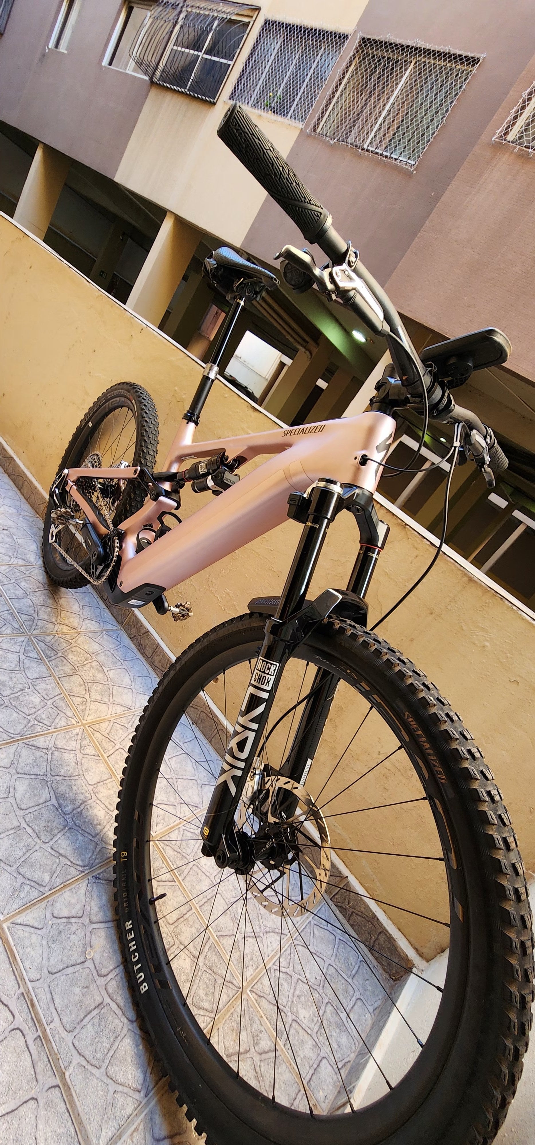

Here's a pic of the burnt gold color:

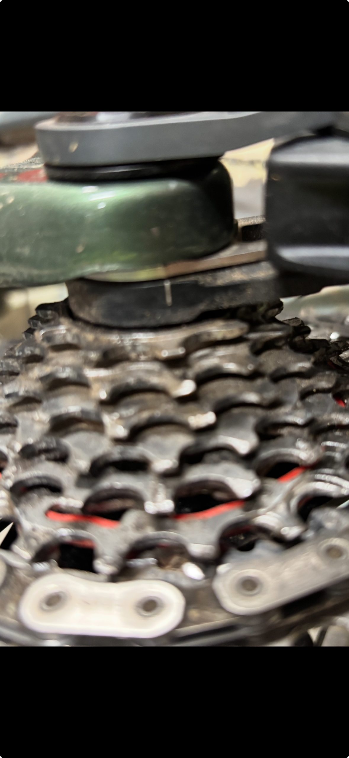

I’ve had my sworks for three weeks and they’ve changed the cassette twice and it’s spent more time at the shop than on the trails , soooooo frustrated really aggravated , going to see wha specialized has to say tomorrow, whats the use of owning such a amazing bike if I can’t ride it with out the chain jumping

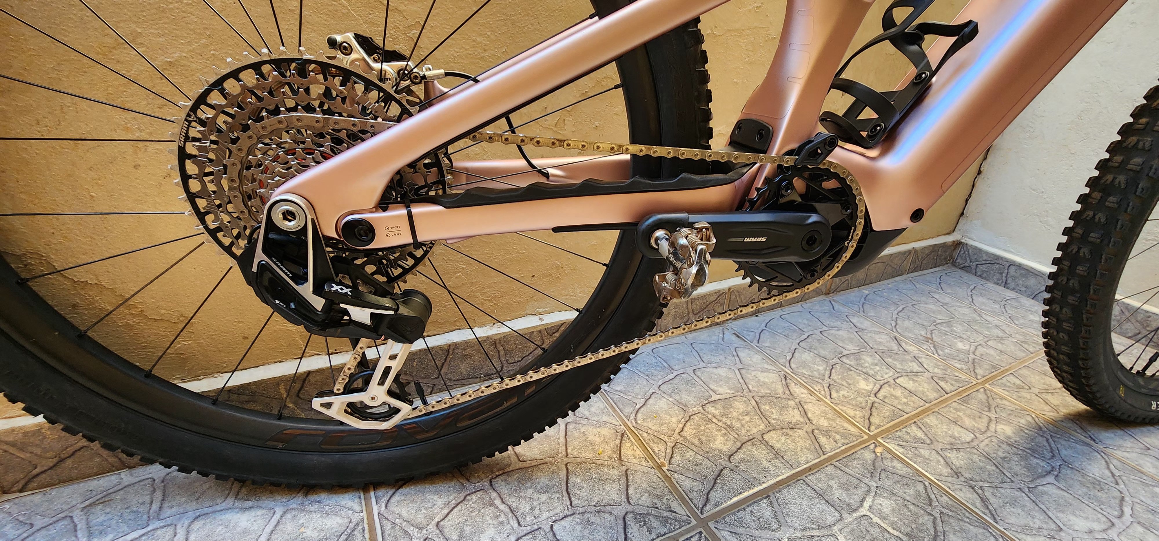

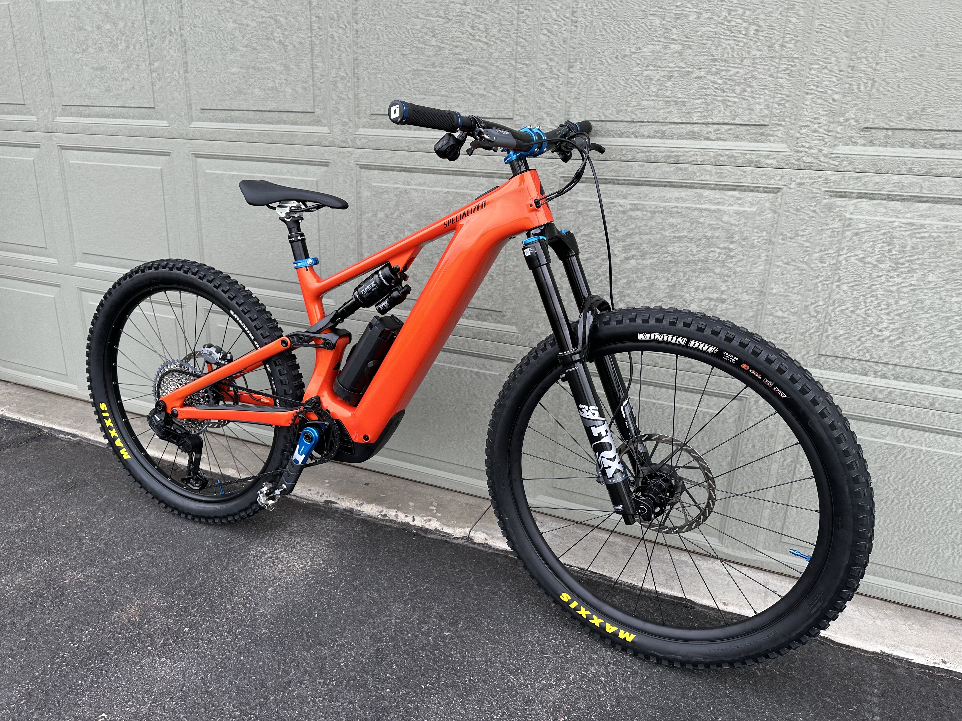

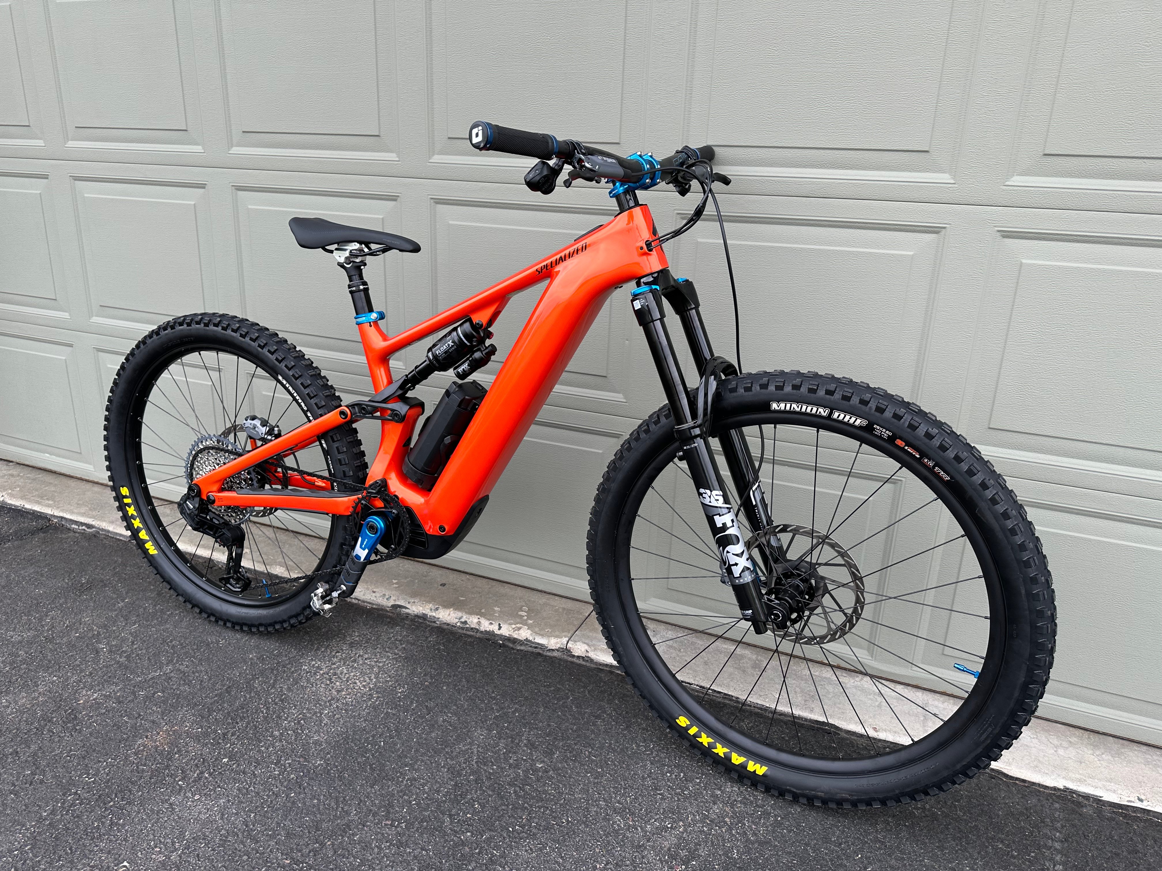

I transferred a few upgrades from my old Levo.
220mm HS2 rotors front and rear, +20mm adaptor for the rear was needed. Gen 3 155mm Hope cranks fit. Switchgrade seat adjuster. Raceface NextR carbon bars with Ruffian grips. Hope 35mm stem and seat post collar. New rear wheel built up with DTSwiss 350 rear hub and 54t ratchet with GX cassette and XO chain. 27.5x2.8 Maxxis DHR and 29x2.6 Maxxis DHF.
I still have matte invisiframe, Amygos guard, and fenders coming this week. Almost done.

If the cranks were made for the gen 3, the two sides have different offsets. So if you check the distance between the crank arm when it's next to the chain stay you will see that one is much closer than the other....If they are both the same distance, then were they not gen3 specific cranks.
That's sad... What's the problem ? That's said it's more a SRAM issue than Specialized one...

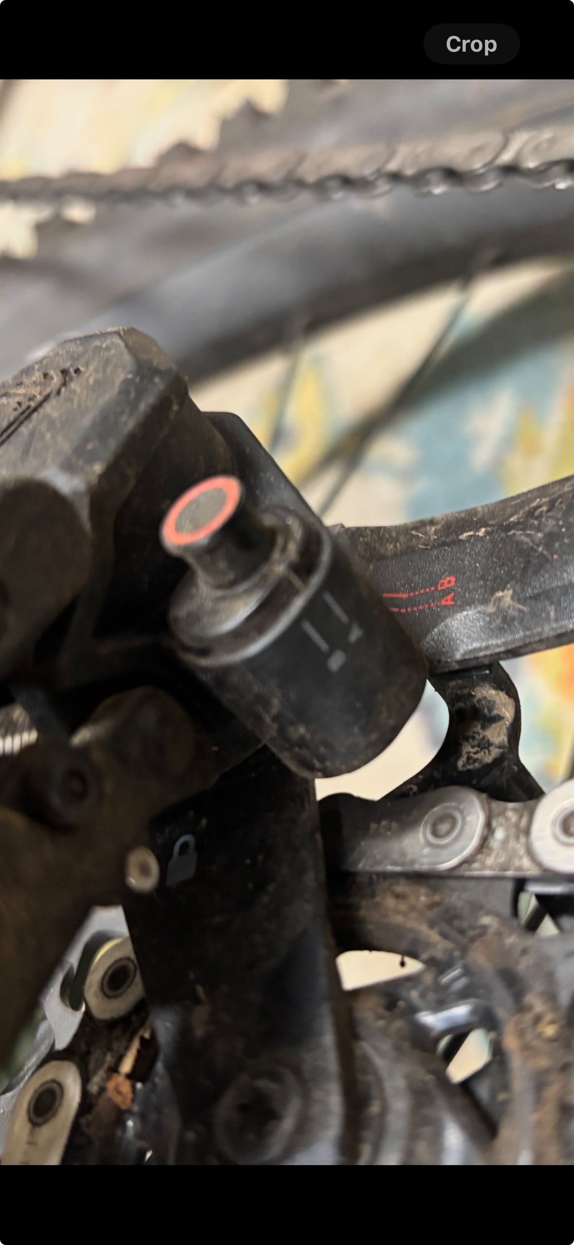

On my way to the LBS to hear what’s next they have already swoped out two cassettes and isn’t a alignment issue either so no idea so far but will keep everyone updated
Isn’t this just a case of adjusting the derailleur via the app?
Unfortunately not with the alignment you would hear a slight slapping every stroke or so , the derailer changes gears flawlessly and smooth
Just the lowest 3 gears 3rd smallest on the cog , when I’m riding in those three always a clank and once it starts it does it often

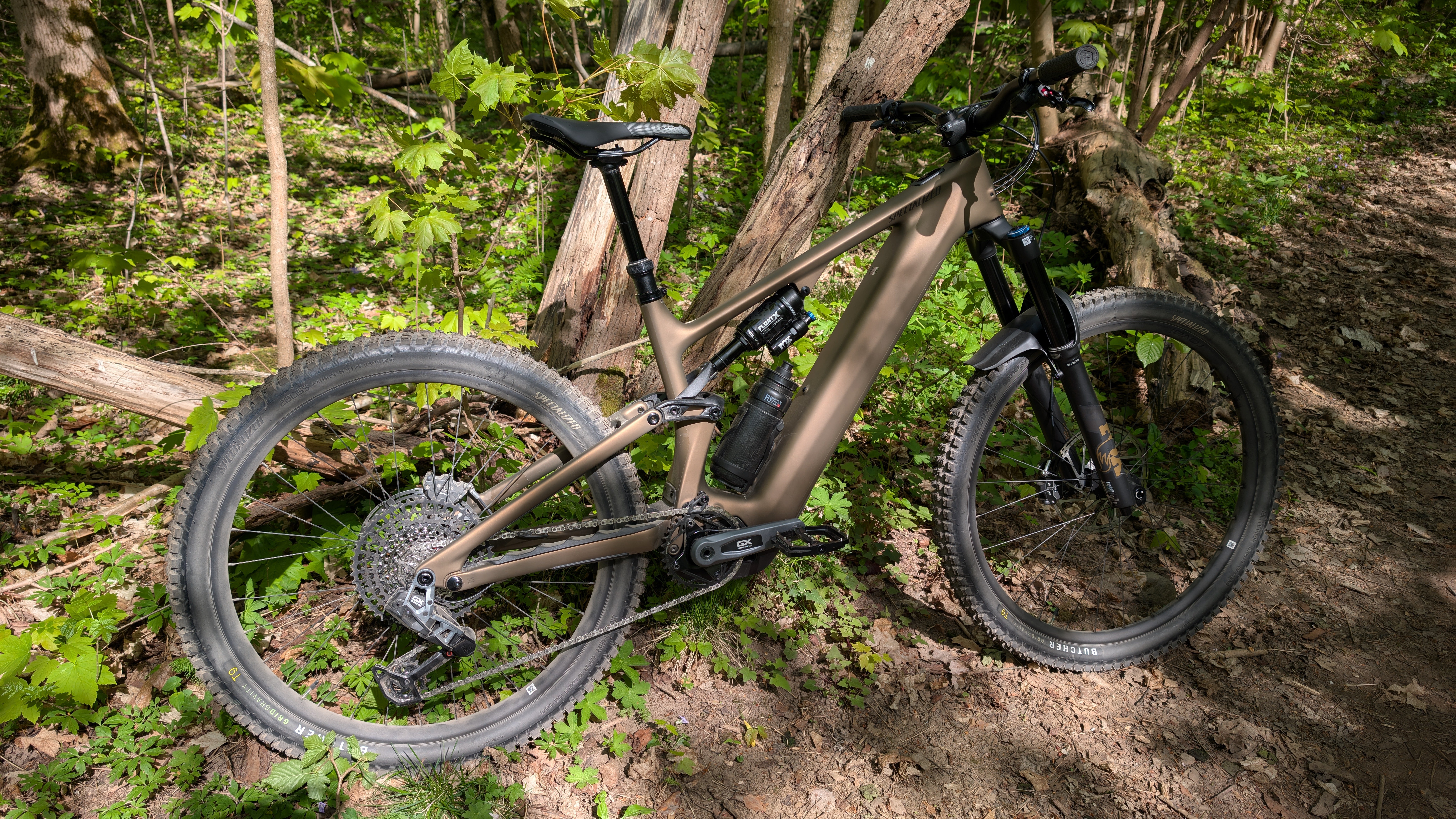

They managed to make it better and worse than the outgoing model.
Have you put 100miles on the bike?
beside a couple lbs, the new bike is better by every measure, especially cornering.
Took a while to get the suspension settings right, but I found the sweet spot and now feeling faster and more confident.
miles to empty is a great new feature as well. The side load is questionable but so far its been ok.
In the usa its the best full power allround ebike at the moment. My buddy has a new crestline but i think he regrets buying it after seeing all the features on my gen4 for less money. its a good bike but the noise from the bosch is very loud.
check that the hash marks align. There are two settings a-b so make sure its on A, check the chain lenght in the smallest gear. good chance you have to remove a link. also you could be at the far end of the adjustment range and the app will tell you if you are, set back to middle and follow the setup intructions
I like the color of your bike! I’ve ordered mine in cypress green but was tempted to go for burnt gold.
Unfortunately, my local shop didn’t have either available so I had to decide based on stock photos.
But I found some YT videos since which boost my confidence that I made the right choice.

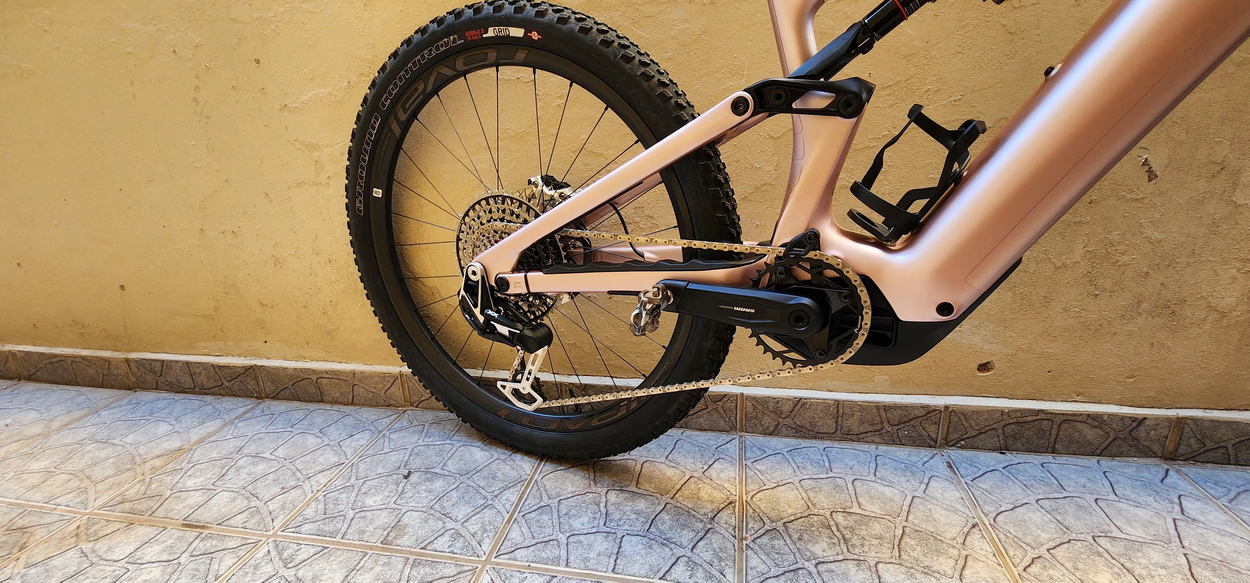

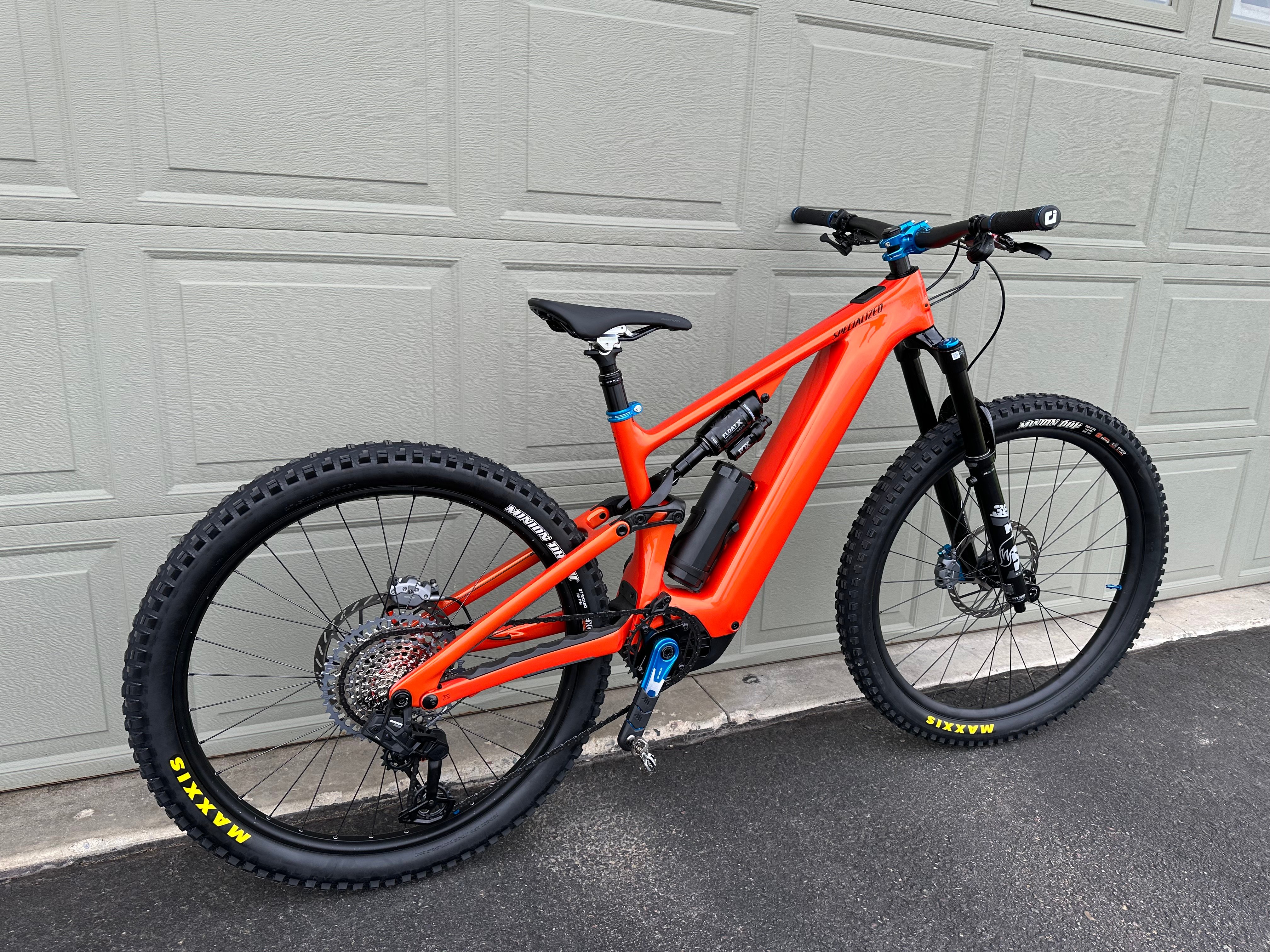

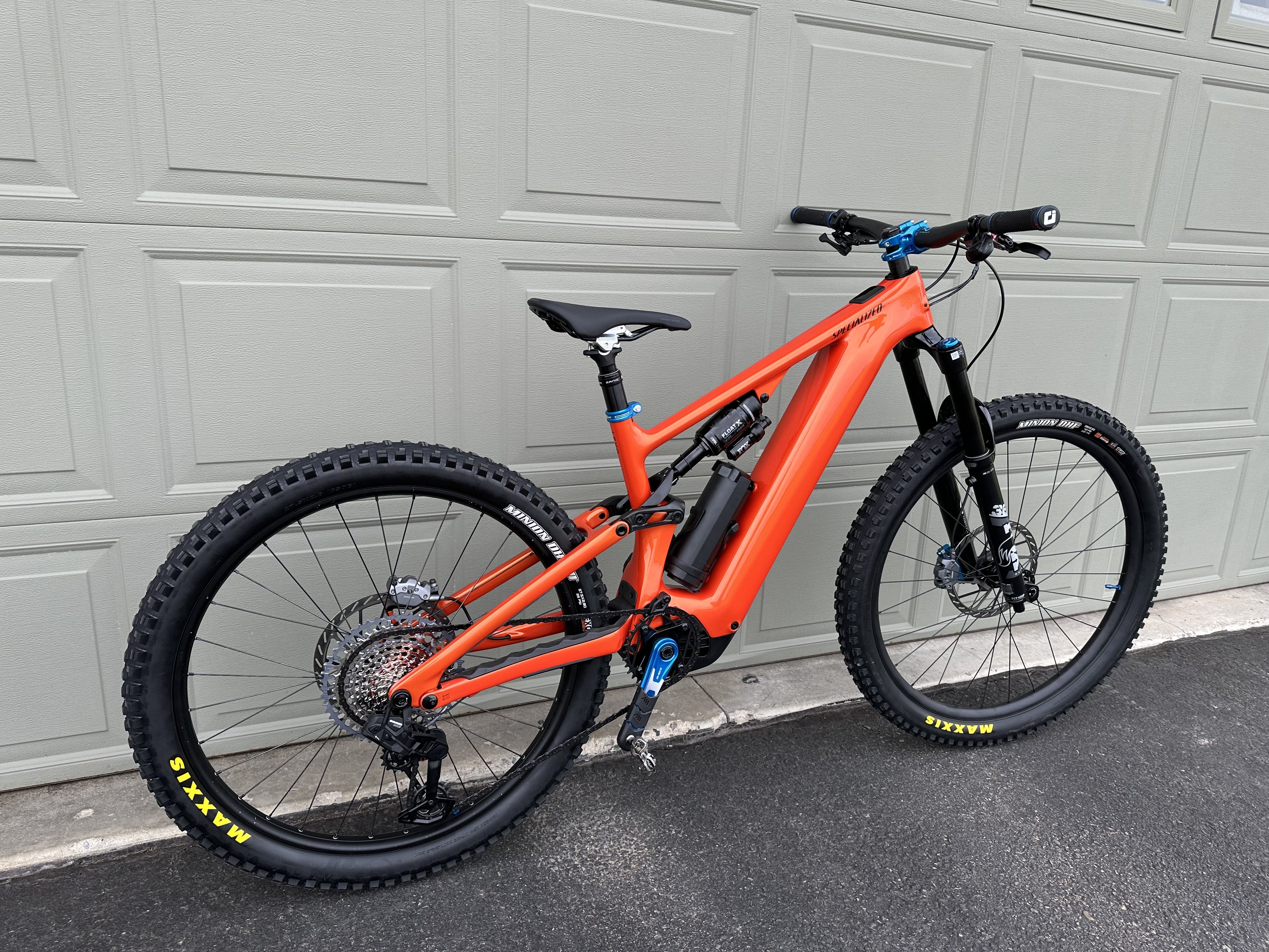

220mm HS2 rotors front and rear, +20mm adaptor for the rear was needed. Gen 3 155mm Hope cranks fit. Switchgrade seat adjuster. Raceface NextR carbon bars with Ruffian grips. Hope 35mm stem and seat post collar. New rear wheel built up with DTSwiss 350 rear hub and 54t ratchet with GX cassette and XO chain. 27.5x26 Maxxis DHR and 29x2.6 Maxxis DHF.
View attachment 160405 View attachment 160406
How did the 2.6 rear fit? Could you please post some pictures?

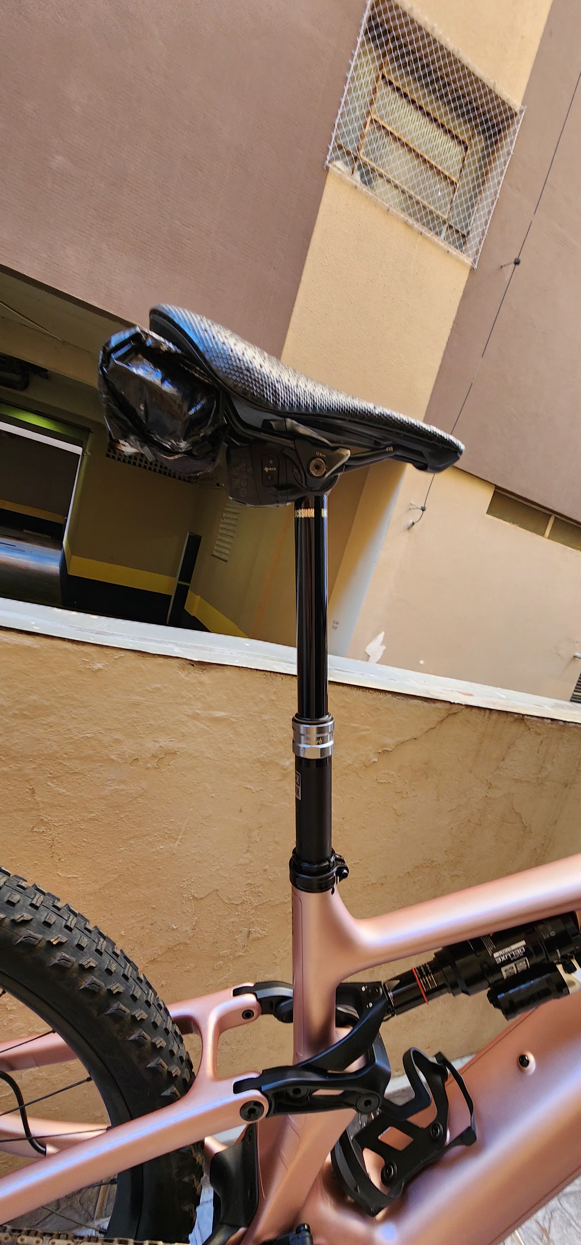

Have you managed to get a cable for the extender yet? They are out of stock in the UK.
