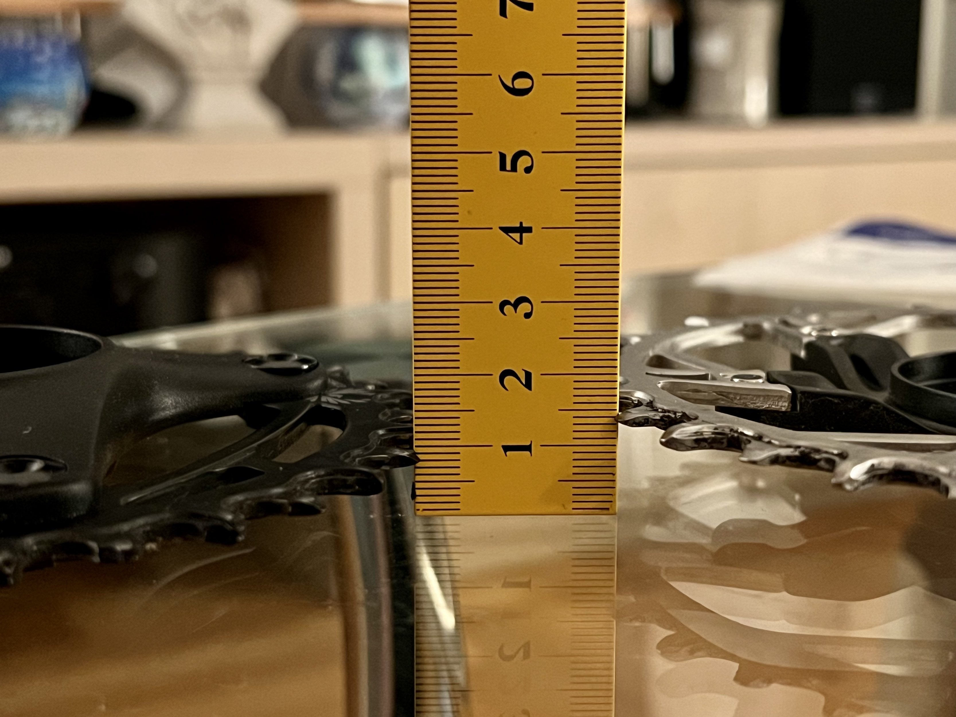

Not the best picture but I reckon the center of the motor drain hole is the centerline of the frame. I'm off by approx 2mm.
Thanks for the image - yeah as you can see it's exactly 2mm to get to the real center. Here are my measurements for 55m and 57mm. I think you are right chainline just with DM chainring is 57mm! But our measurements are subjective :) because of the angle that you can create...

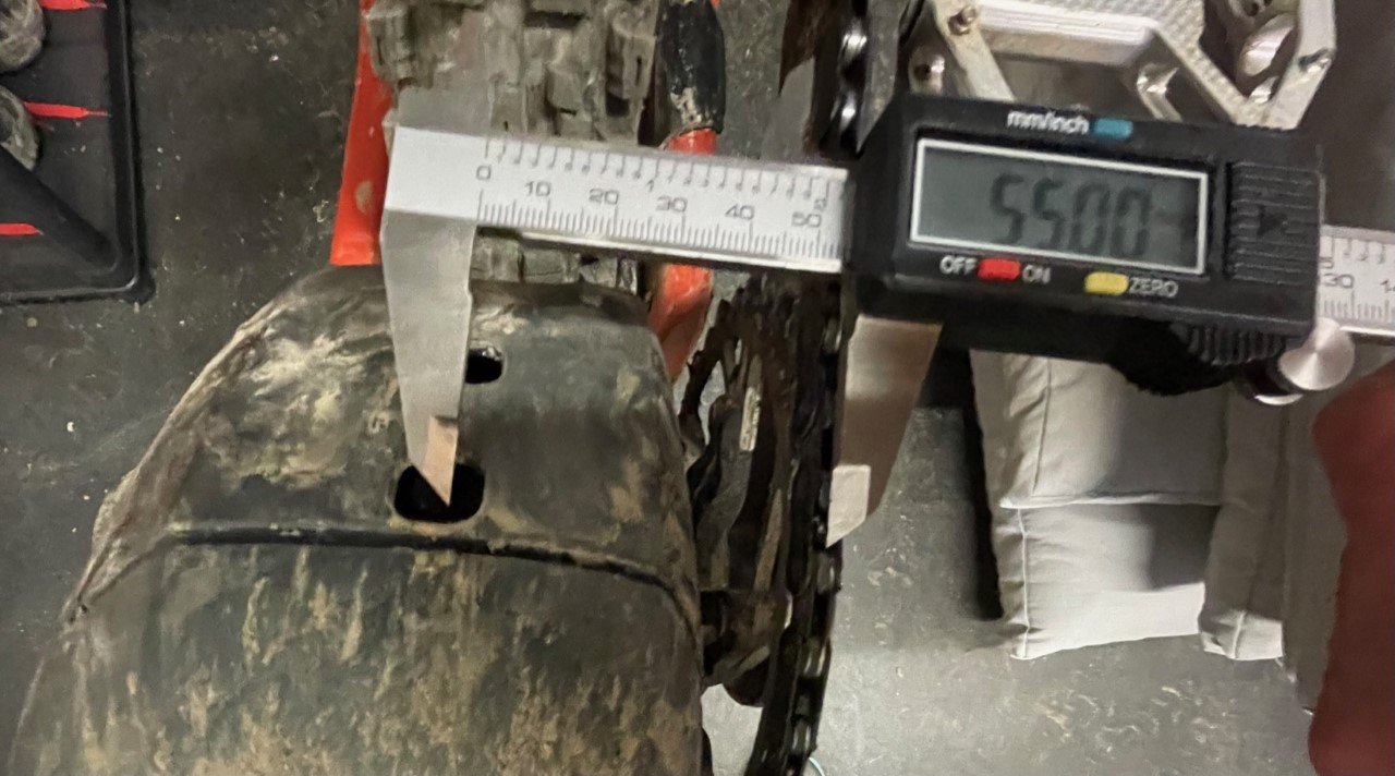

This is a more sensible way to measure the difference! Pic shared by another person going through the same pain! ;)
