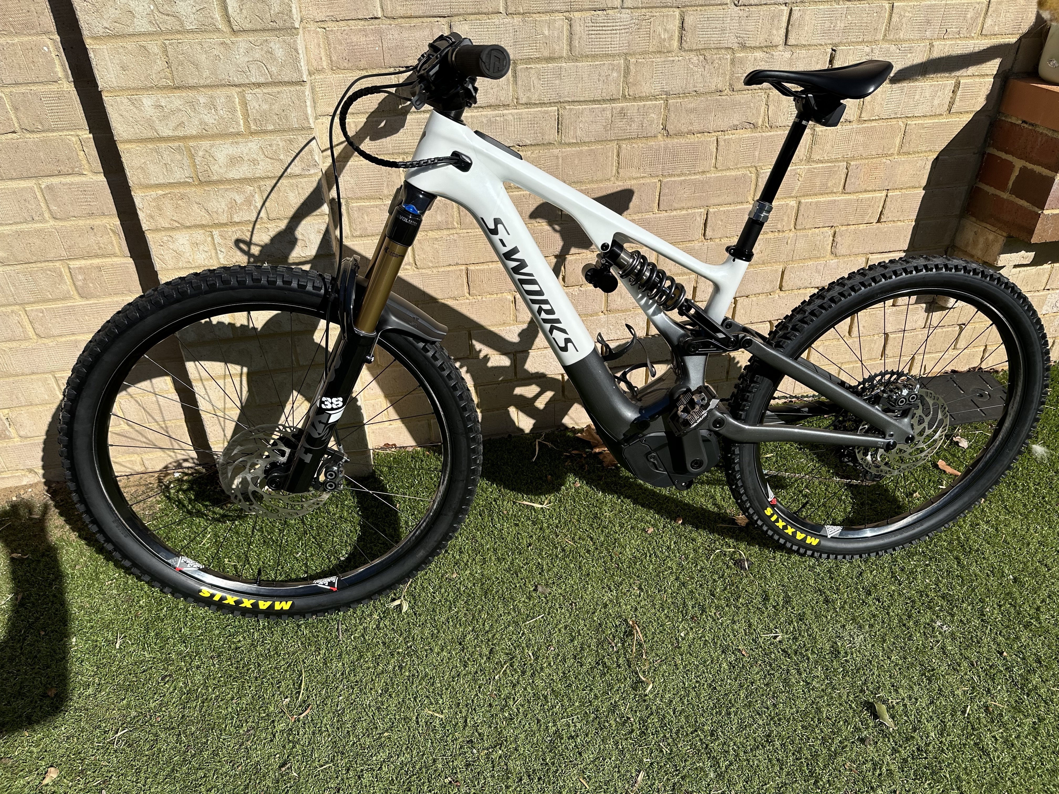

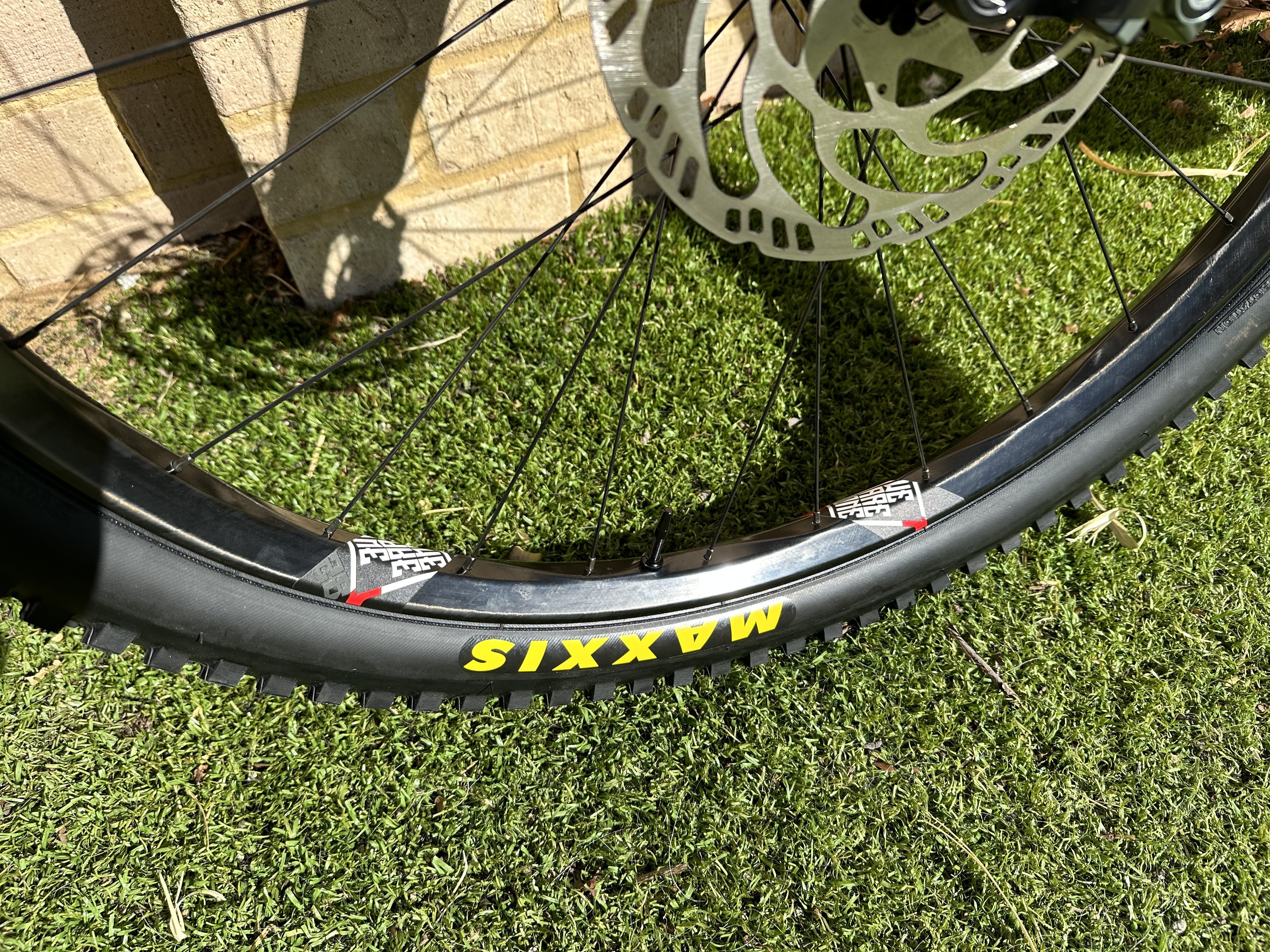

New wheels for my gen3
Decided to try 25 / 27 psi and was better but still not awesome, also think the stock tires are not the nicest.
I feel like I am a beginner rider again, this emtb thing takes a bit of learning to get used to.
I was finding I was always in the wrong gear and then was making sure I was always in the right gear and I was changing gears a lot more than on my normal enduro.
But had a great ride, 43kms and 1150m of elevation
