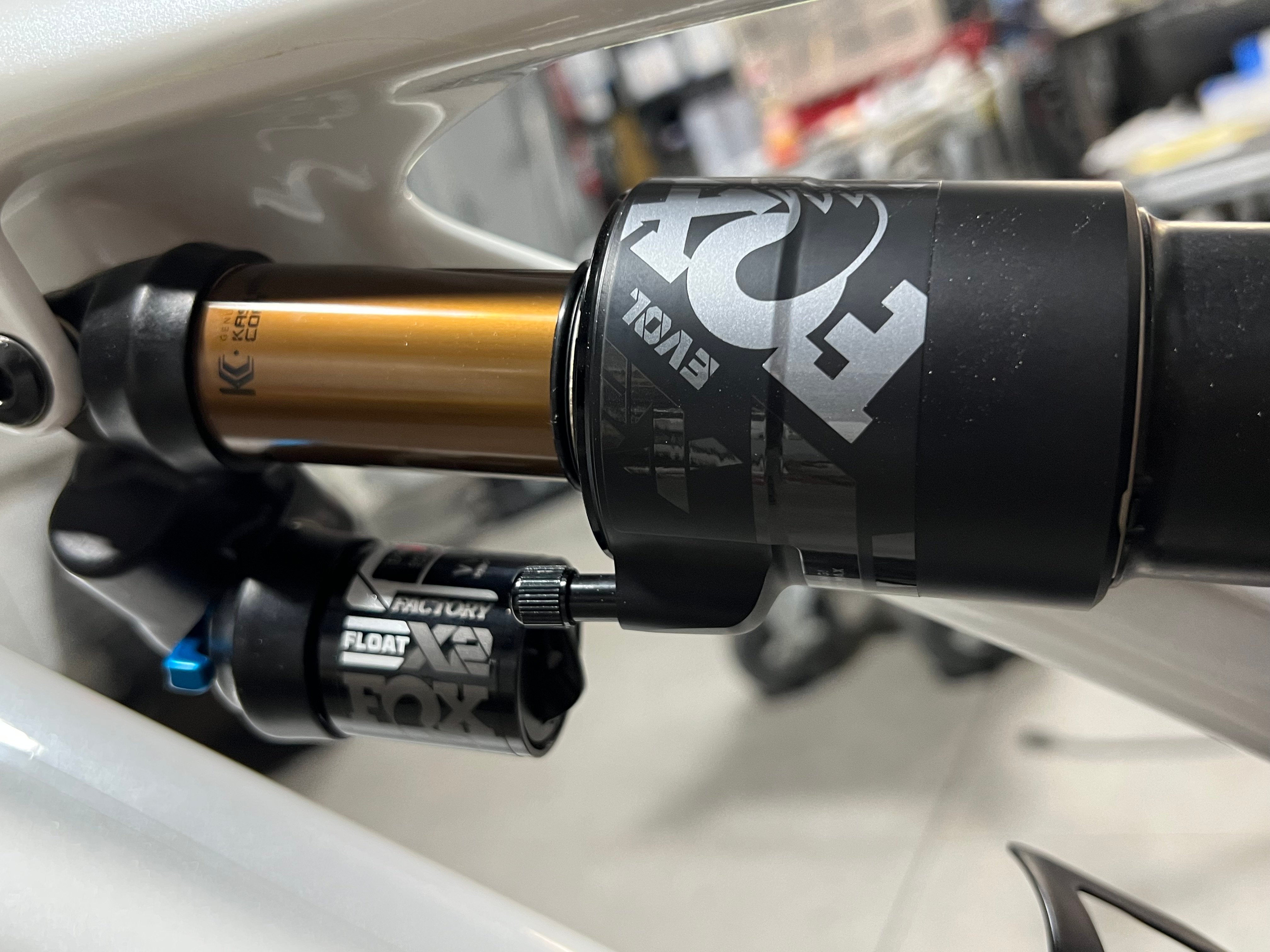

My buddy's Levo Expert (gen 3, purchased last Dec) has a Performance X2. LSC/LSR only, no HS adjusters.
Come on guys, someone here must have an X2 Factory on their gen 3 Levo.
I'm planning an upgrade on my Levo Comp from a Float X to an X2. Just want to make sure I get a shock with a close enough internal tuning on it.

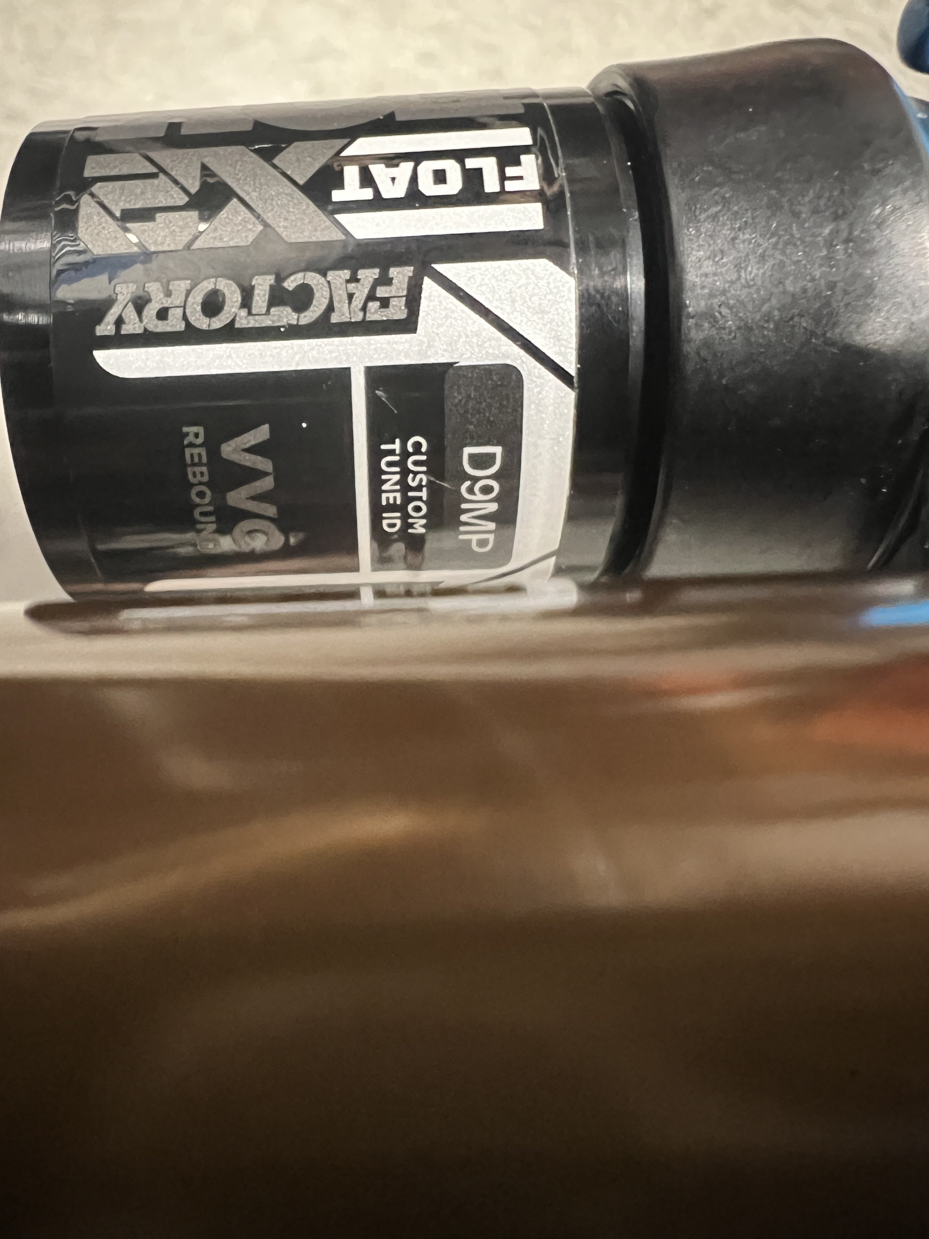

I basically gave the factory X2 that came on my Pro away, it blew up twice within 75 miles. It’s probably the last shock I’d “upgrade” to but if you’re dead set on it just get it custom tuned.
2022 S-Works

don't do that, tune your Float X, but don't put an X2, it's just a headache, just sadness when everything seems to work just fine, it has problems.....

No worries, I've come to my senses since, mainly because of the following:
1) Spoke to Fox Service and it didn't sound like they were overtly promoting the idea of switching over to the X2. Instead, I was advised to put in a bigger volume spacer in my Float X for better mid-travel support.
2) Doesn't look like I can recoup any money for my Float X which is ironically a solid performer with excellent reliability track record.
3) There is no solid indication that 2024 updates to the X2 have turned it into a reliable unit.
So for now. I will hold off and continue to enjoy the Float X. With some luck, I may get a chance to test ride an X2 equipped
Levo to see if the benefits would actually justify the expense and potential headaches.

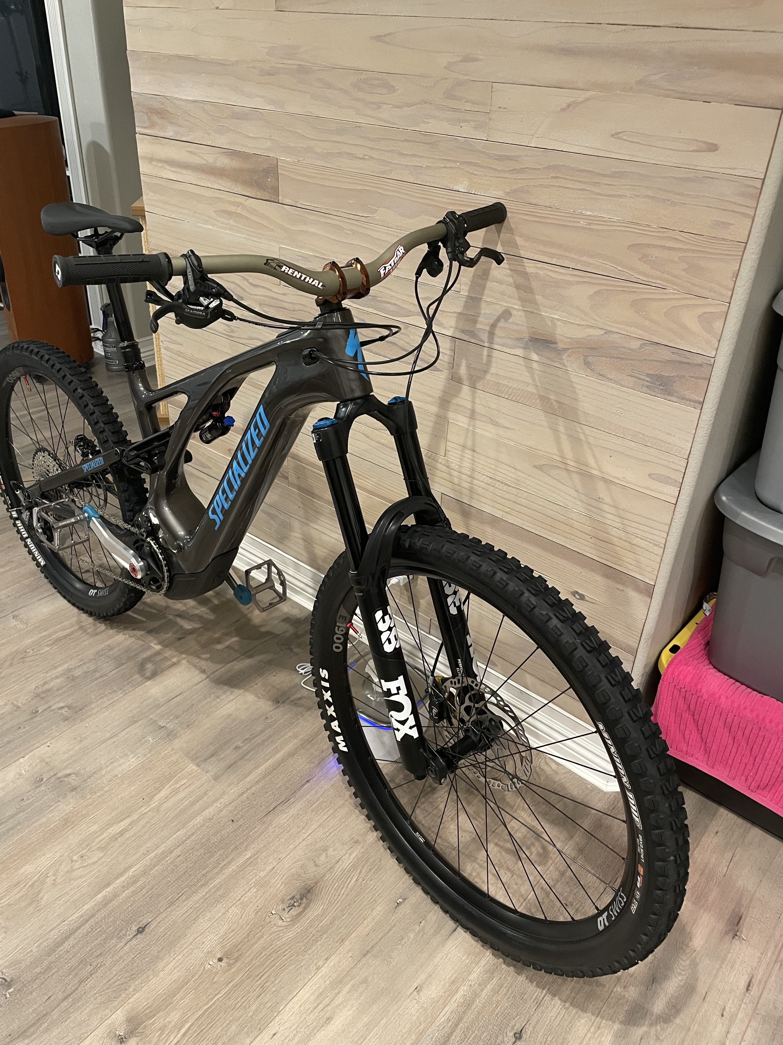

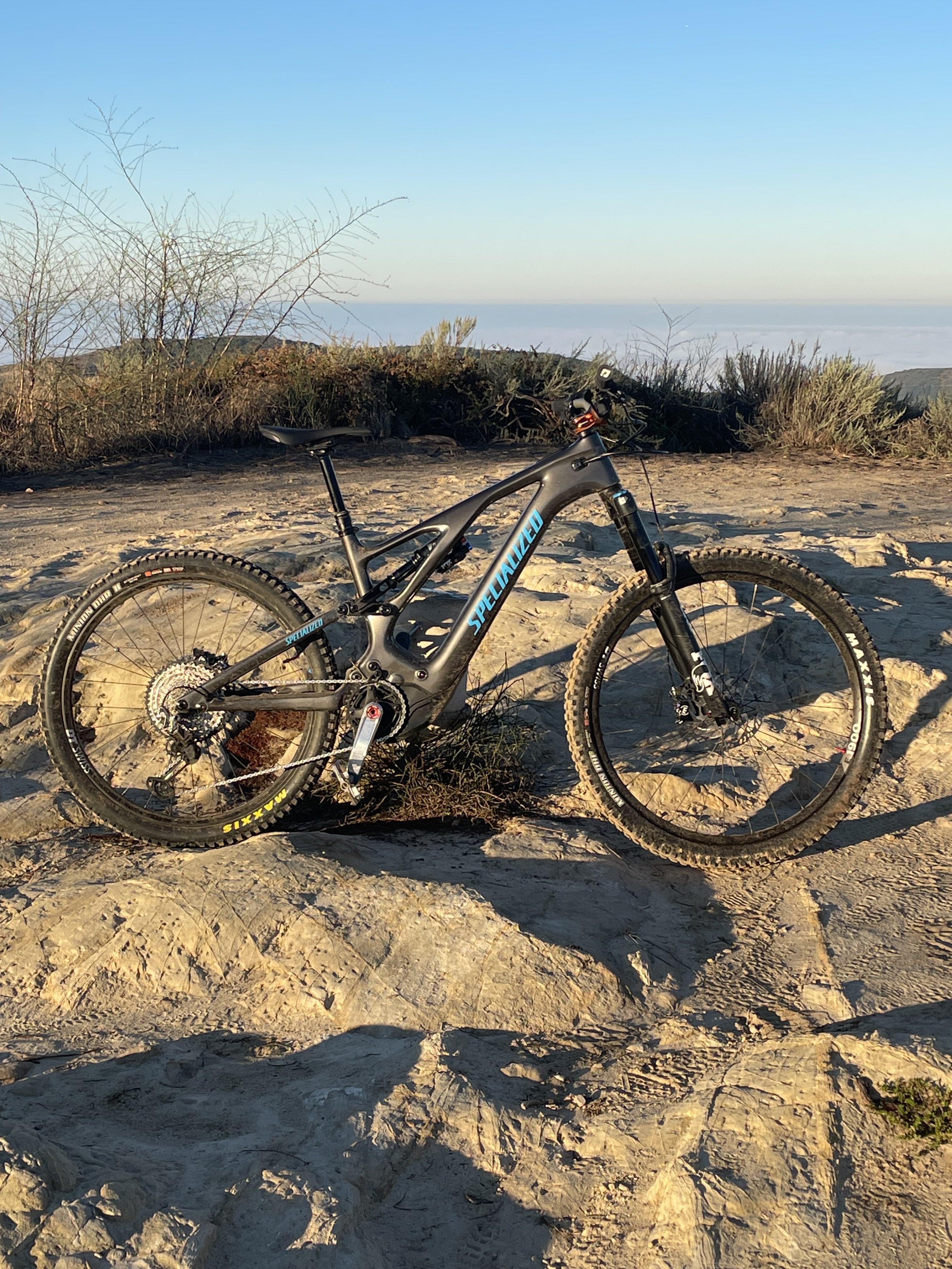

Intro. Finally got the Levo built.
Started with Base Carbon
Fox 38 performance elite 170mm
Fox Float X (cascade link on way)
Renthal bars
Nukeproof stem (or Renthal)
XTR 12 speed
Magura MT Sport Trail (4 piston F+R)
Lekkie Buzz Bar 160mm cranks
DT Swiss H1900 wheels (mullet)
Background is BMX and DH racing (mid 90s FSR DH Deer Valley NORBA National pic below) and MX
So far I’ve done a few rides, bike is extremely capable and fun to ride. So impressed with so many aspects of it. My little brother has similar background and has had the S-Works Levo for about a year. Now I know what the hype is!

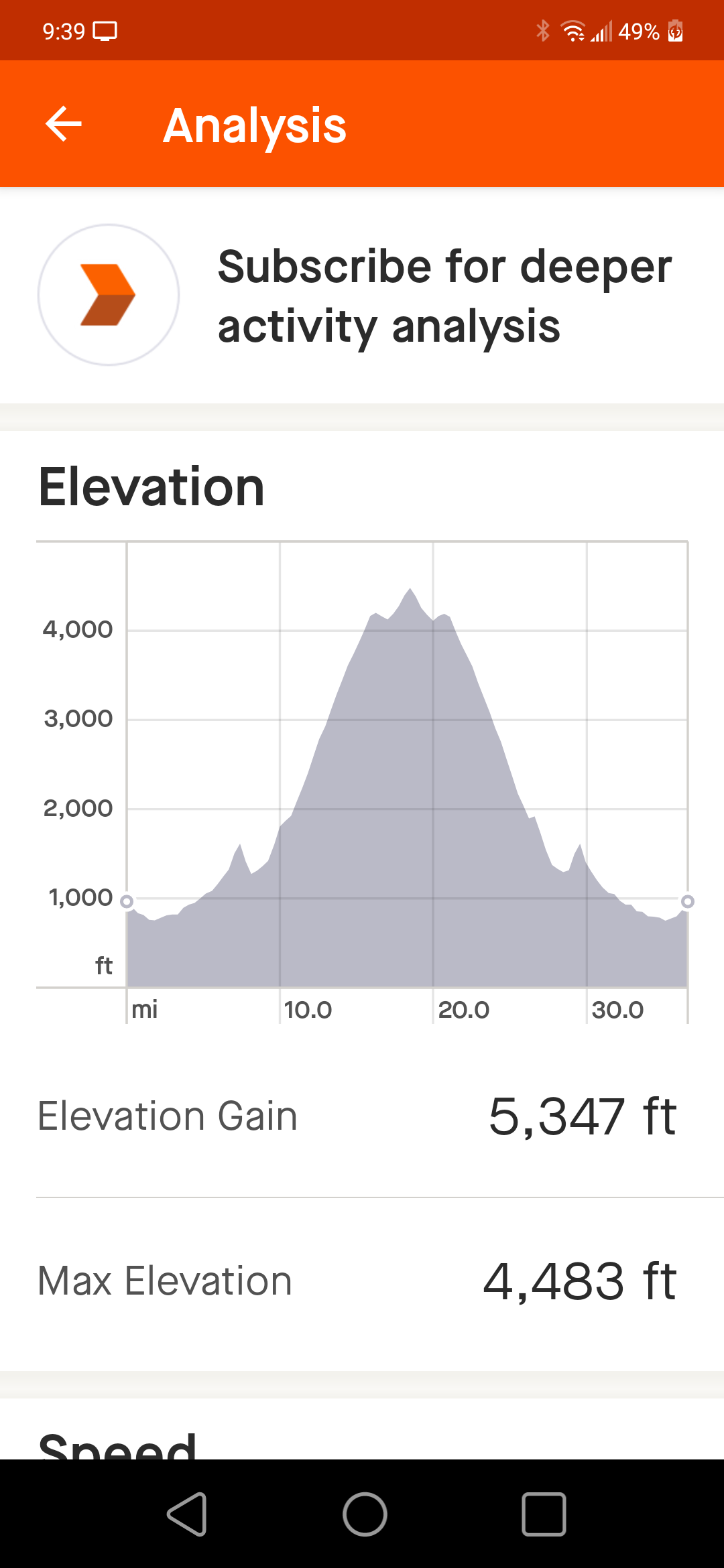

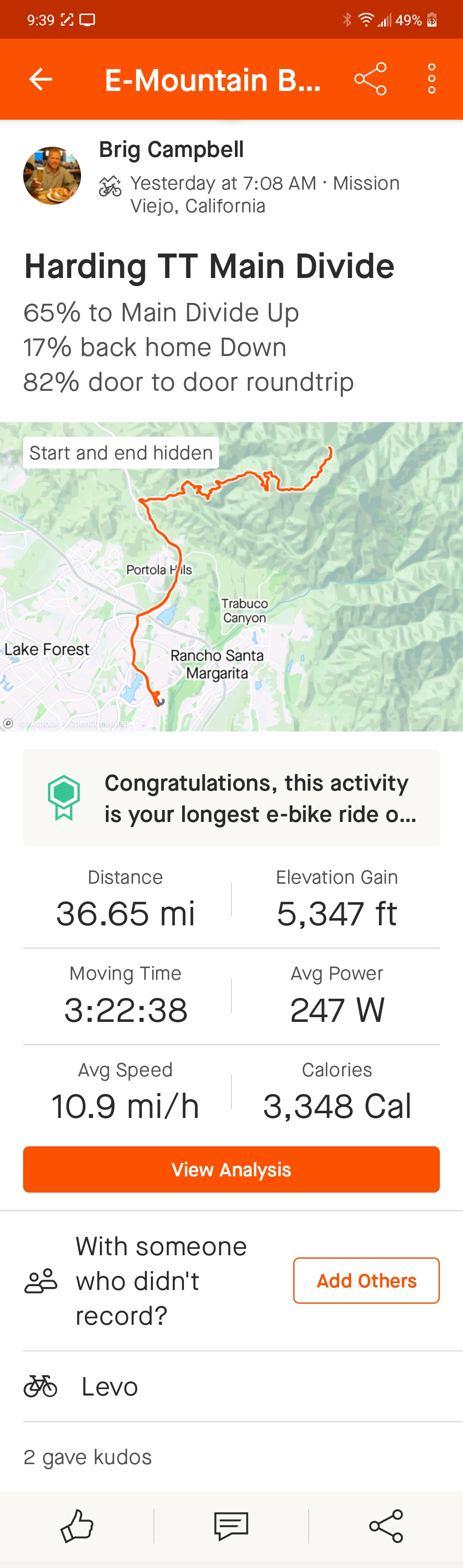

Range test for my one year old 22 comp alloy.
Basically 9 hilly road miles to the trail and 9 fire road miles up. Then back down.
Ran ECO 30/100 entire time.
Here's the battery usage.
Check out my activity on Strava: https://strava.app.link/U4NEN7ncACb
View attachment 123358View attachment 123359

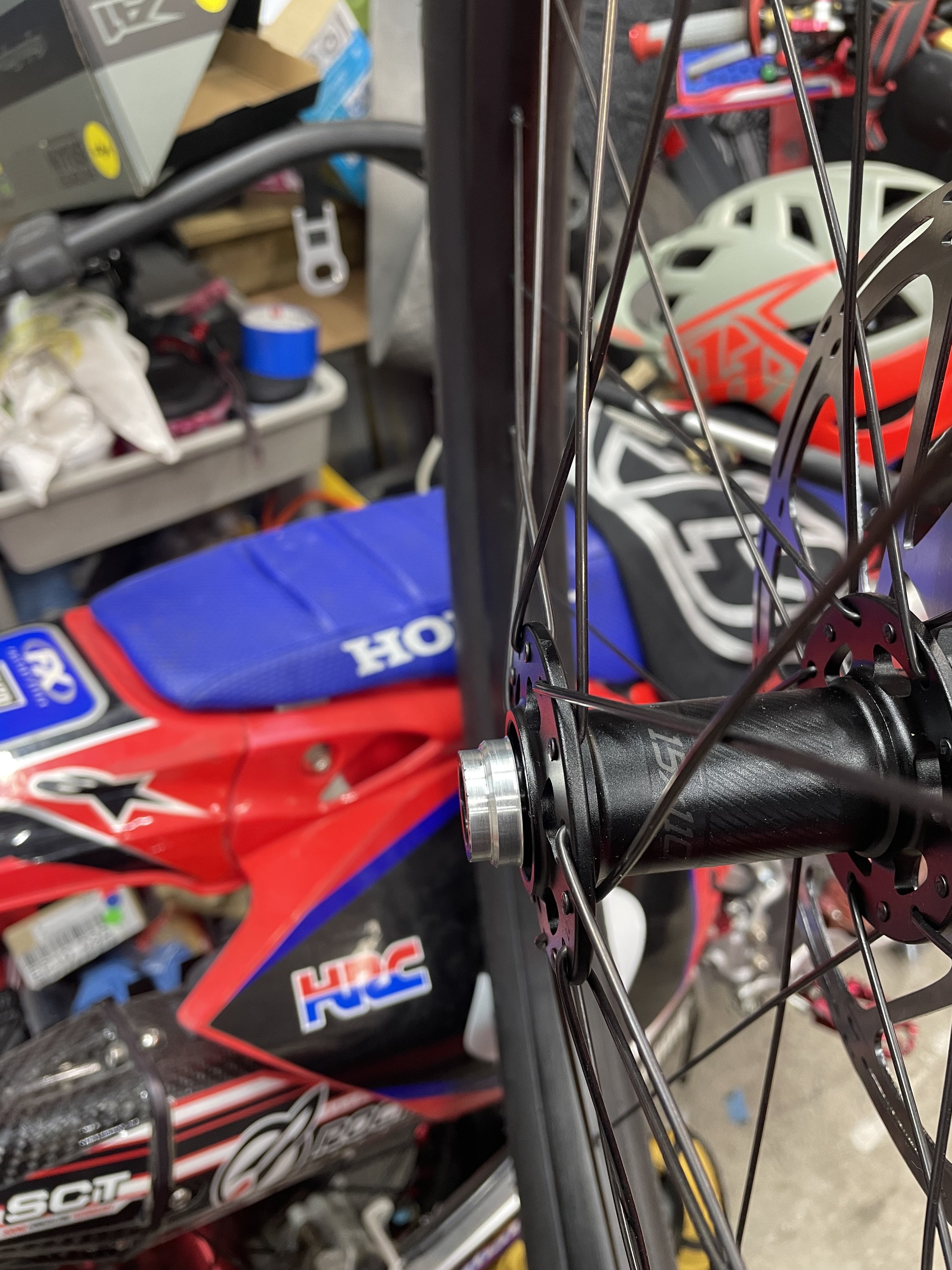

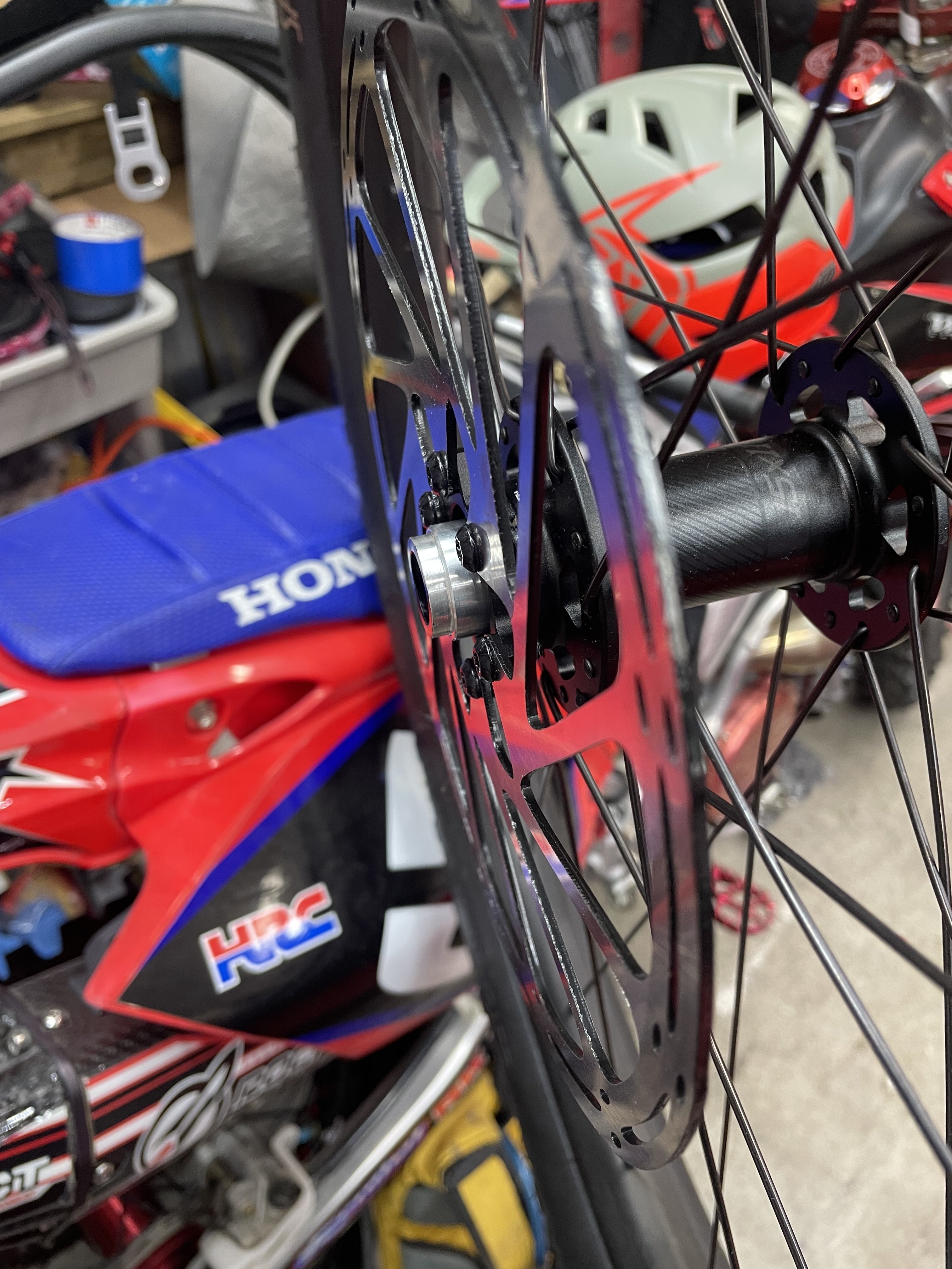

It is a 29" fork, what I mean is that the wheel has this.View attachment 120601
Hopefully I’m not replying too much, just got the Levo and now flipping thru this thread. I put different wheels on mine, and was planning to sell the stock ones, but then decided to keep them as a second set. Sure enough, they won’t fit my Fox 38. The specialized part is sold out everywhere and no ETA in sight. Reached out to some connections I have and found a machinist to modify mine.
