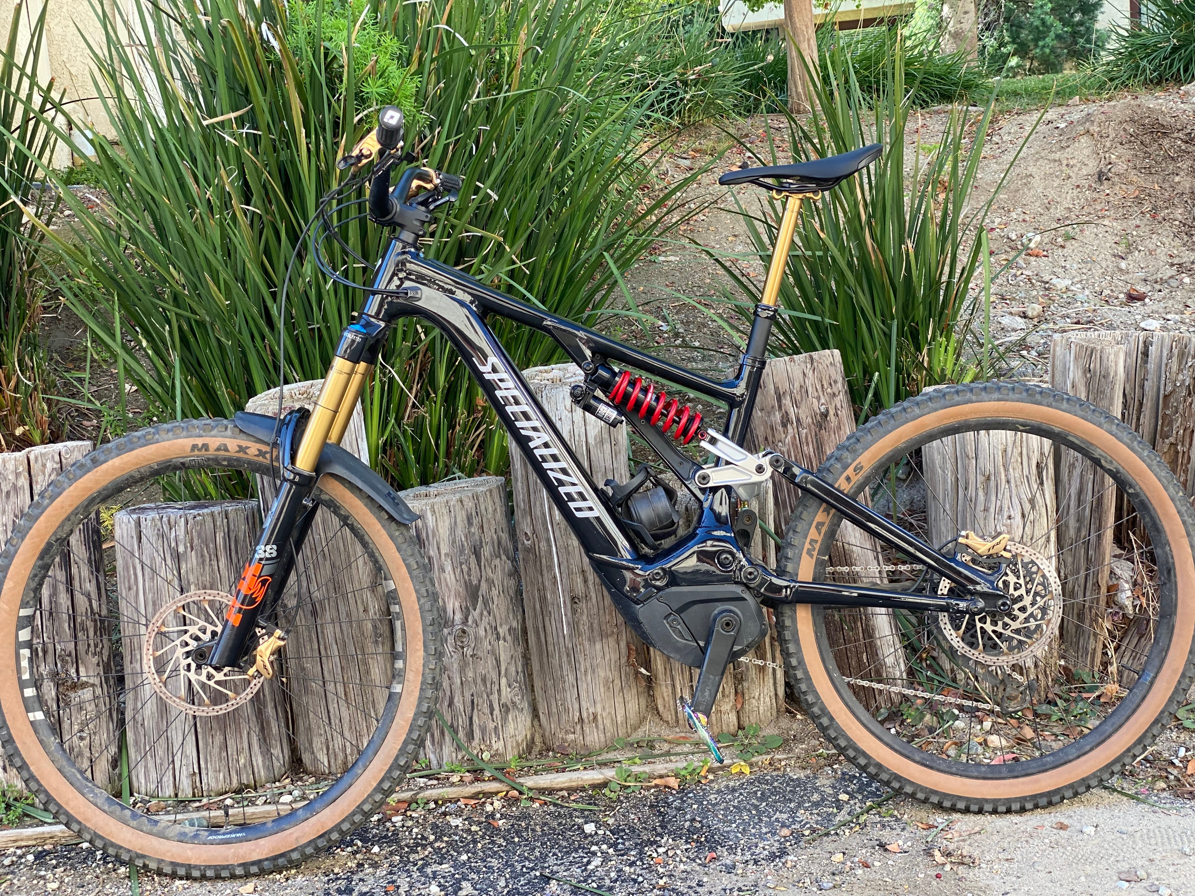

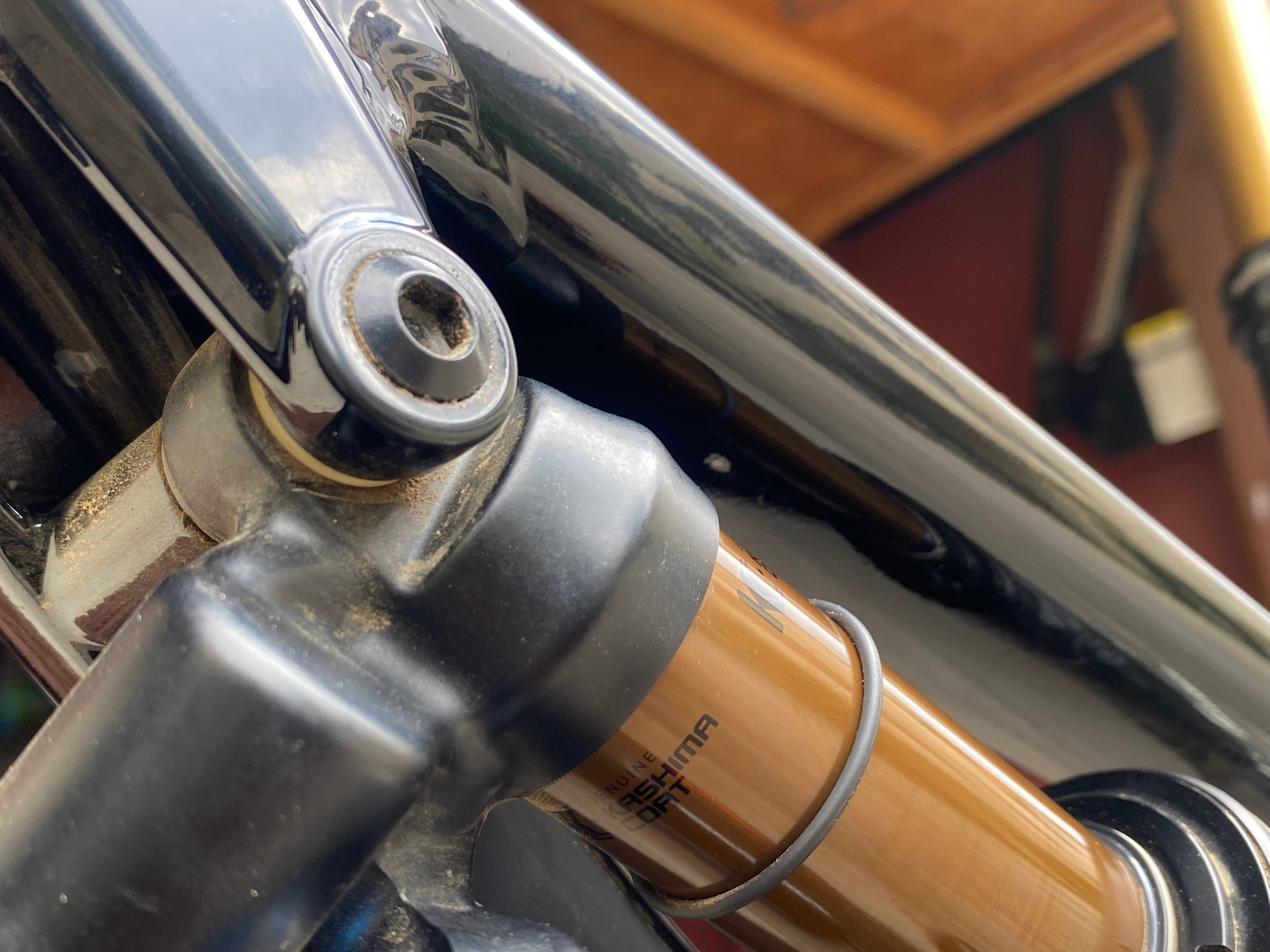

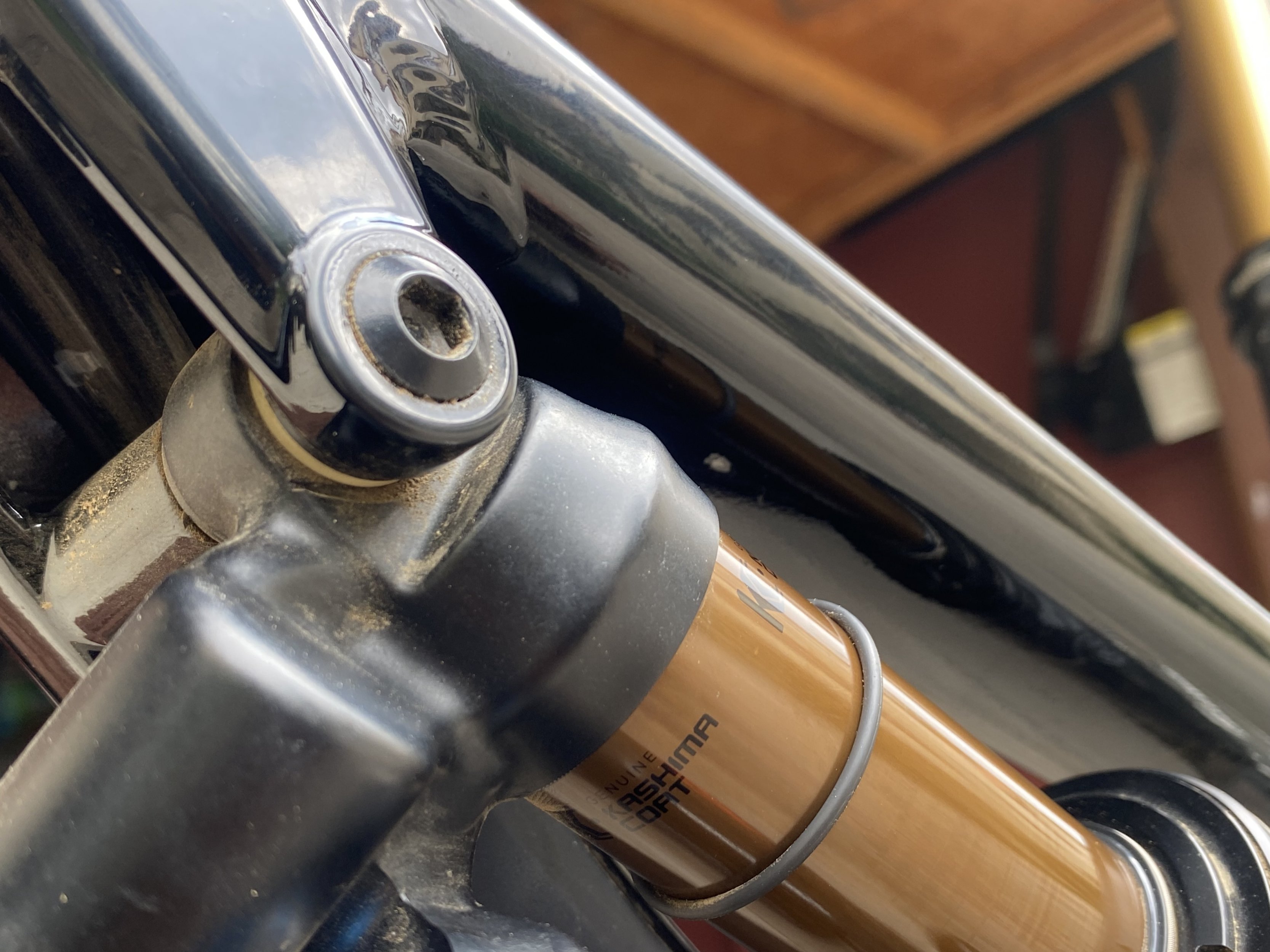

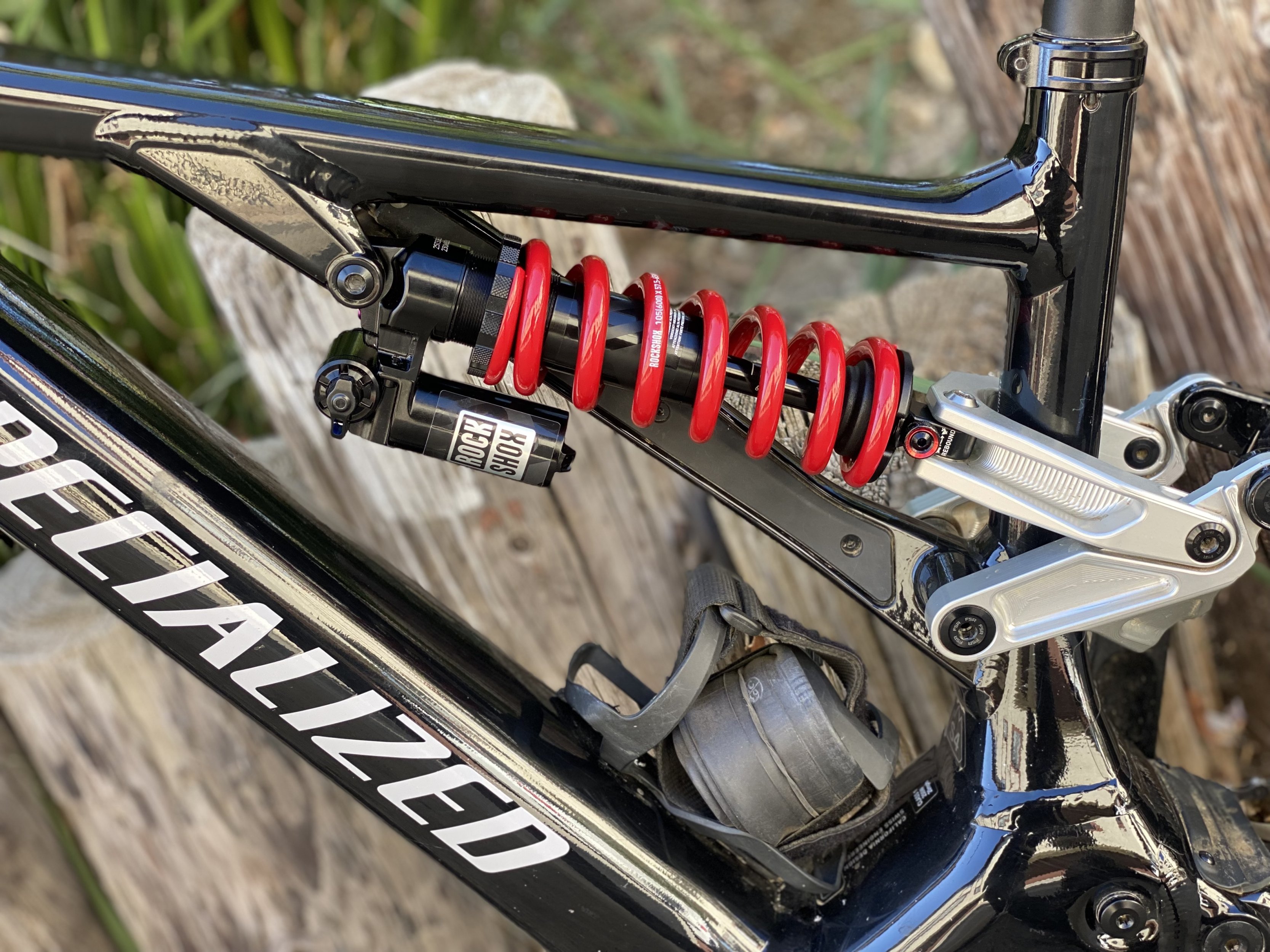

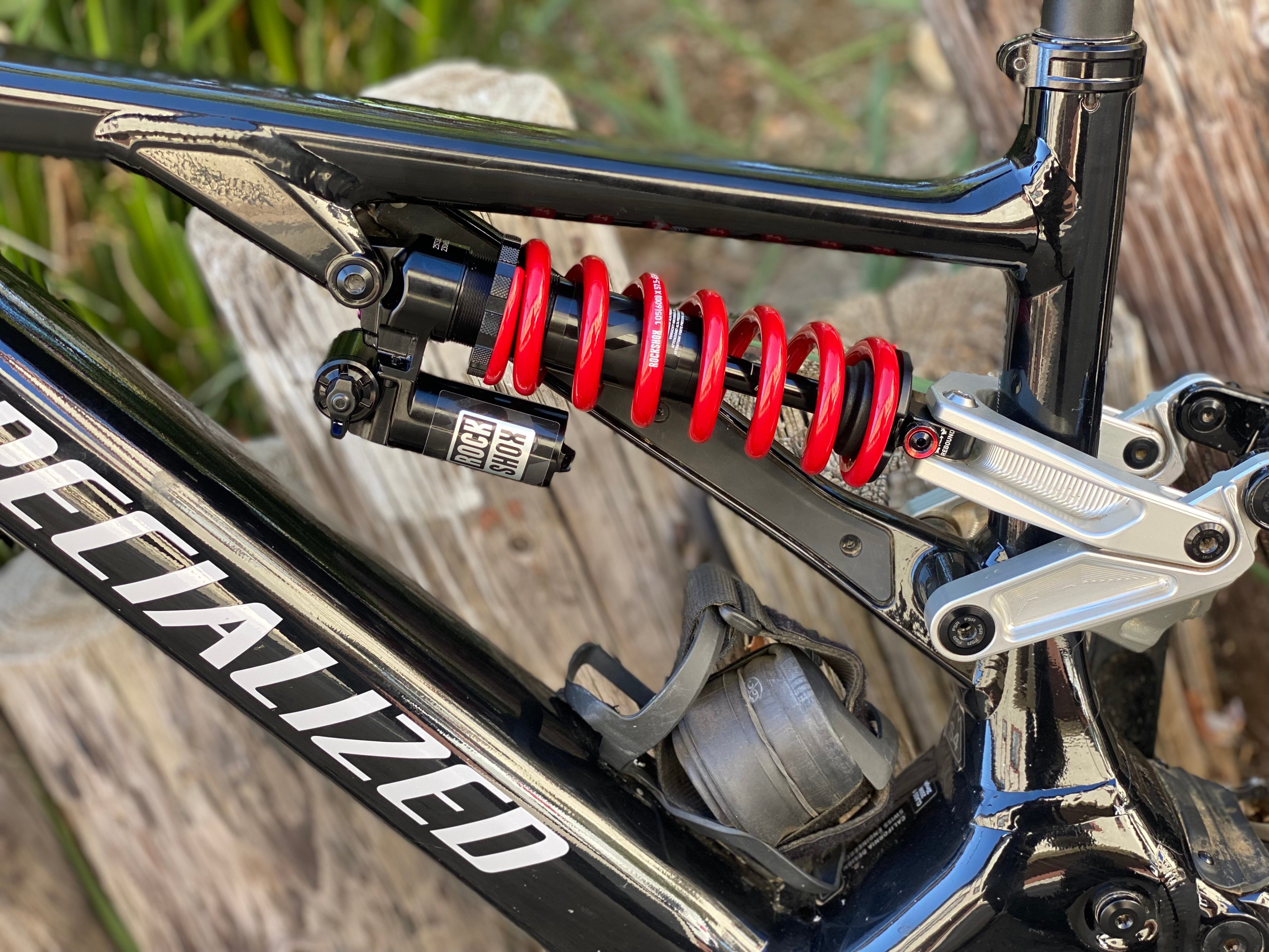

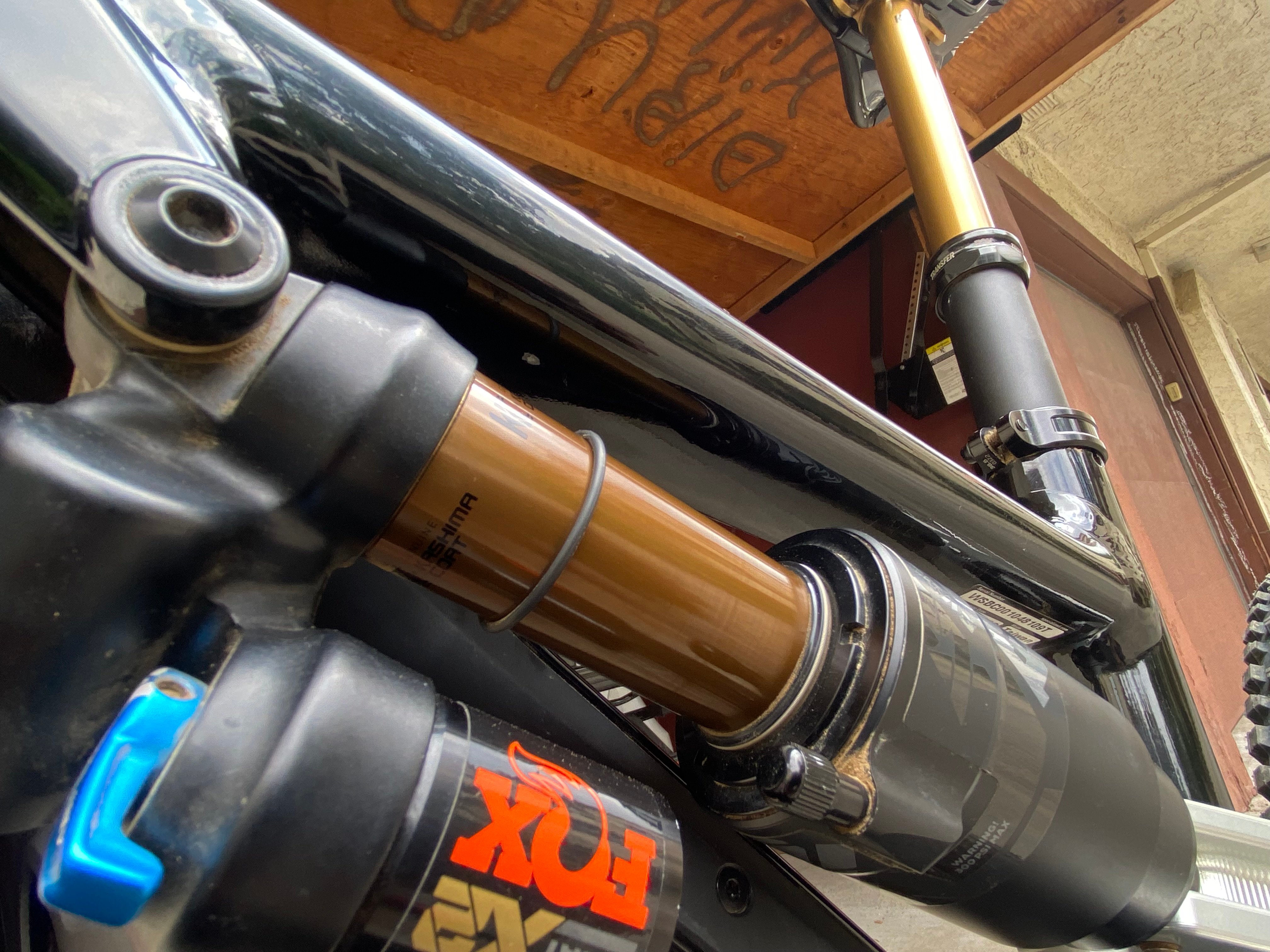

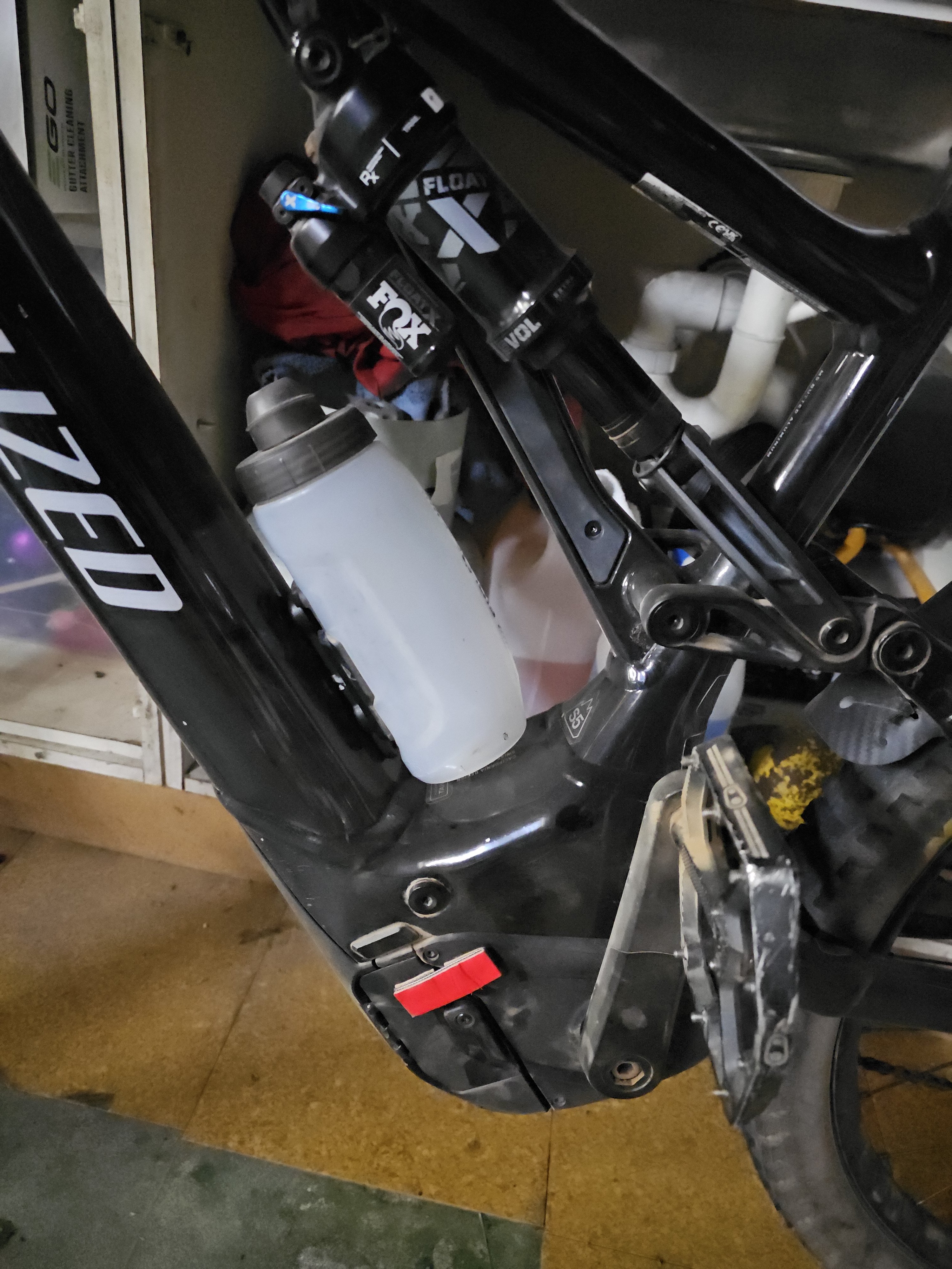

Just found this forum, thought I’ll share my experience with my 2023 Levo comp alloy with the cascade components long shock linkage.
I purchased my 2023 specialized levo about two months ago, and immediately upgraded to the long shock linkage upgrade from cascade components with a 2023 Fox X2 shock.
During the install of the X2, I noticed the air can would rub on the frame. I figured if I ran some more tokens and more psi, it will prevent it from bottoming out. I eventually took off the X2 due to the frame rub getting worse. Now I’m running the 2023 Rockshock deluxe coil. I’ve only ridden it once since installing but so far do love the feeling of it.
View attachment 126678 View attachment 126679 View attachment 126680 View attachment 126681
So where exactly was the frame rub?
