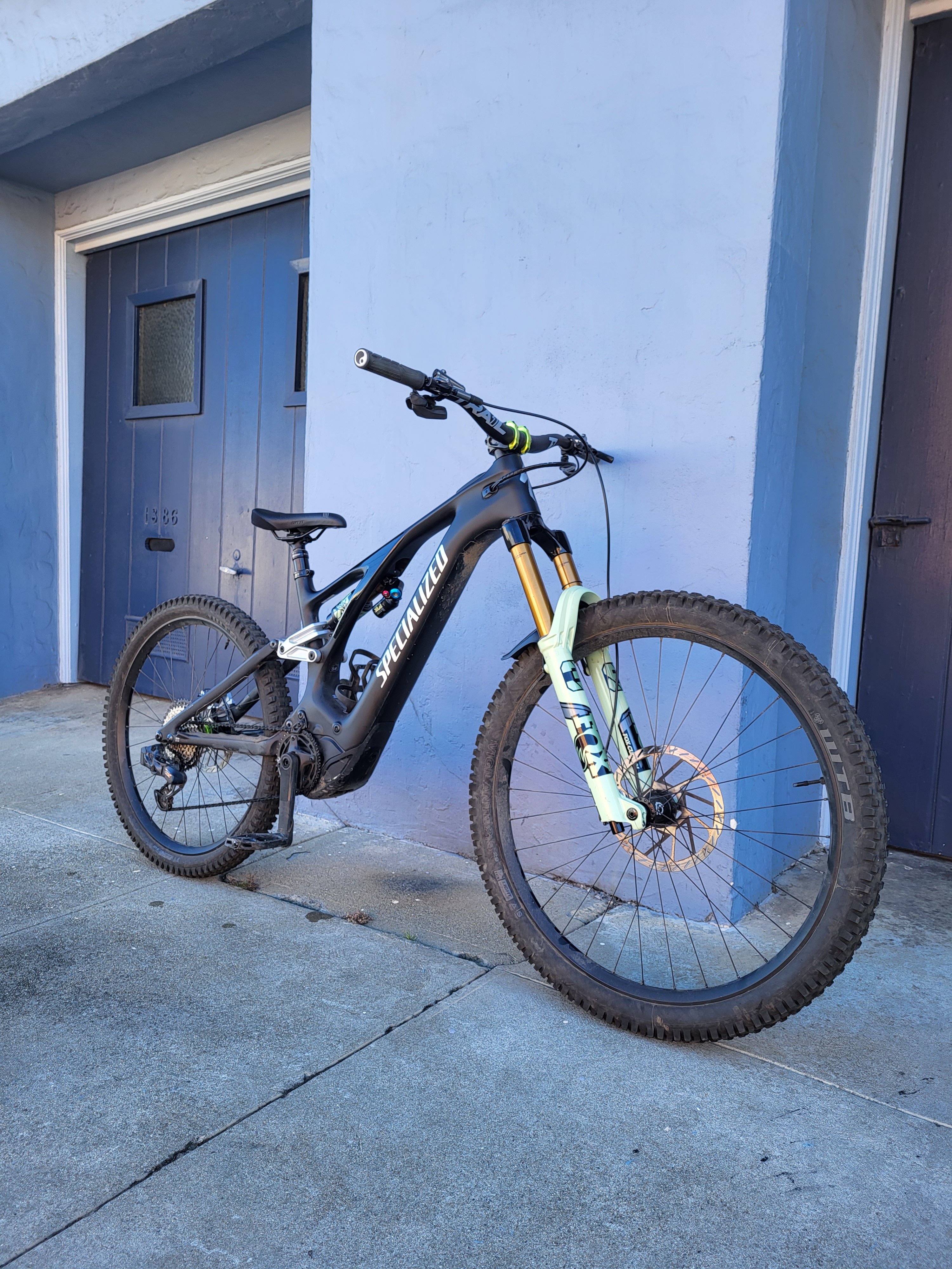

I have just swapped my dvo suspension on to my gen 3 running the new topaz 2 had it on my 21 levo before for a short stint
Love that bike, how is the DVO fork and shock? I have a JadeX on my rail that Jesse did for me, but im looking at doing that exact setup you have if I get a levo. Let me know if it ever pops up for sale

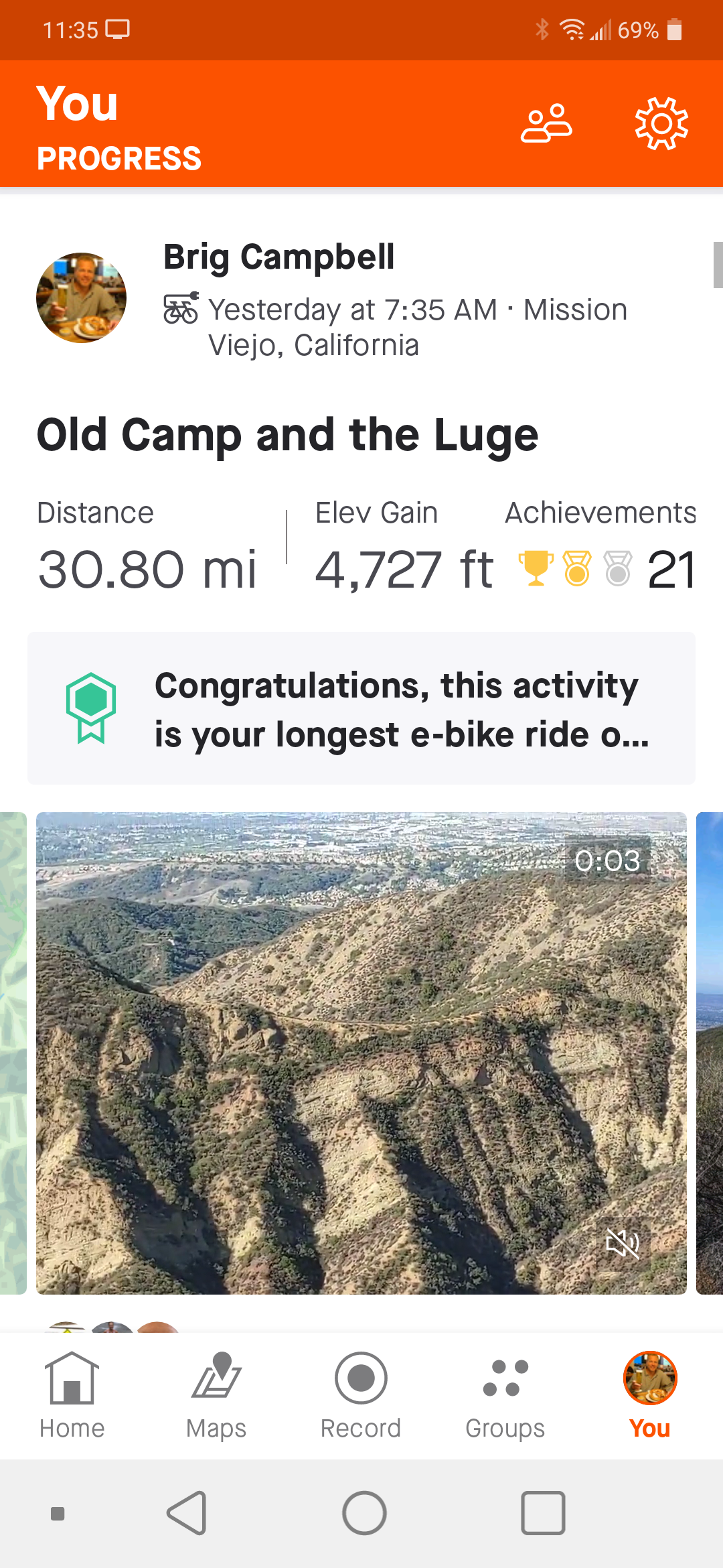

I'm surprised (in a good way) with range on my Levo, 2 days in a row I did about 1900m elevation (40km, 55km)
First day, most of a time I used Trail (40 support, peak power 80)
and on a second day, as I felt a bit more tired, most of the time I used turbo (which I set to 50% support, 100% power).
It's way more than on Bosch, but also I feel that power delivery is more 'gentle' (natural?).
Or should I set support a bit higher? :)
