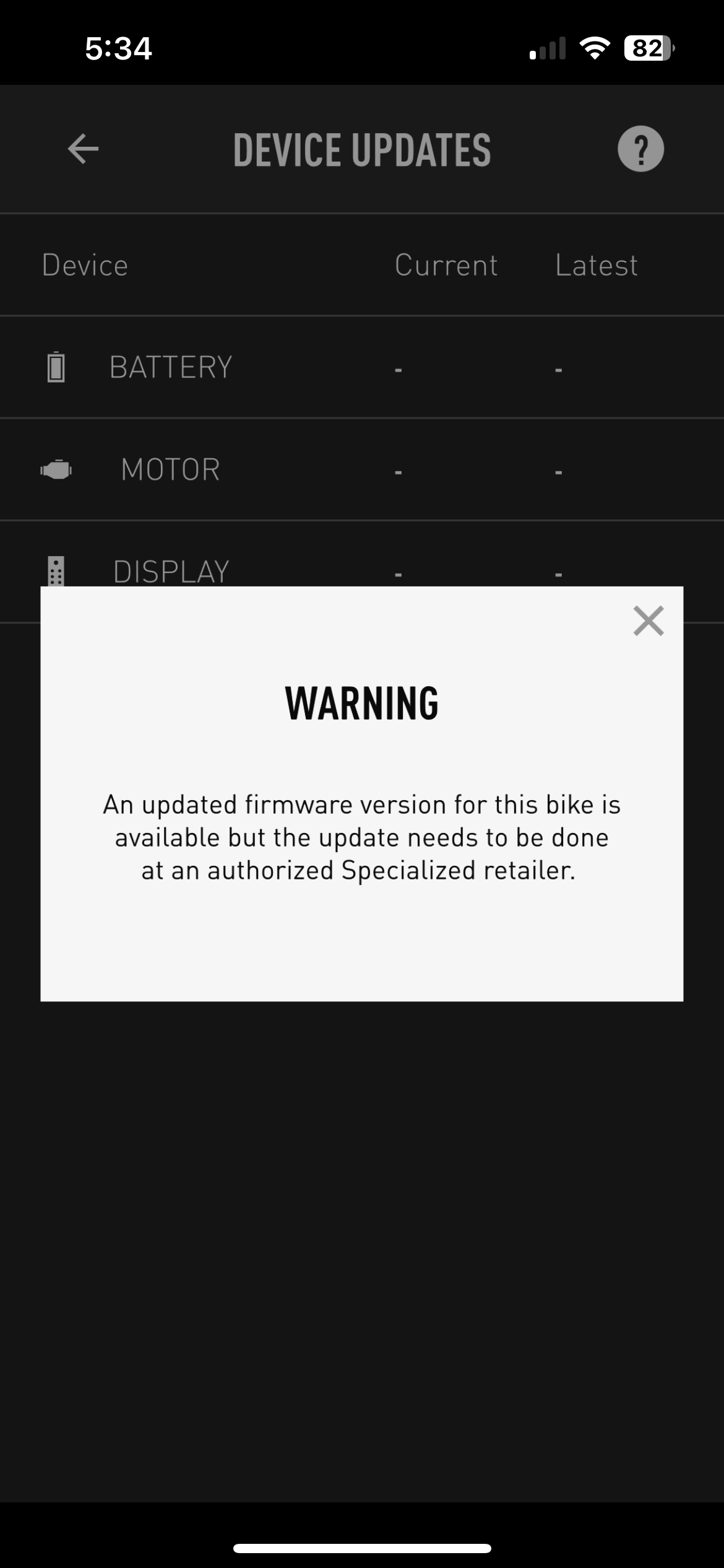

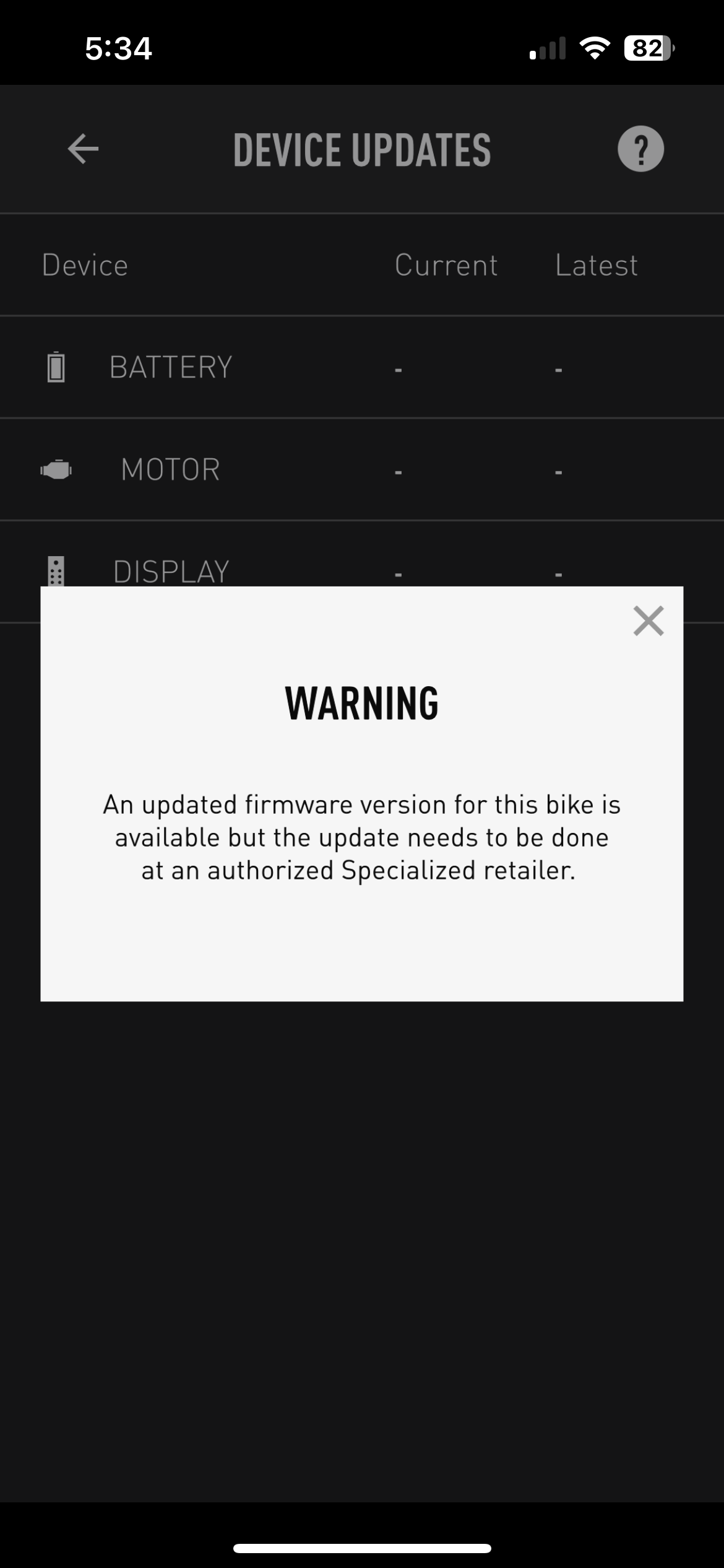

Anyone else seeing this in the MC app? Wondering if it’s related to my Magicshine install?

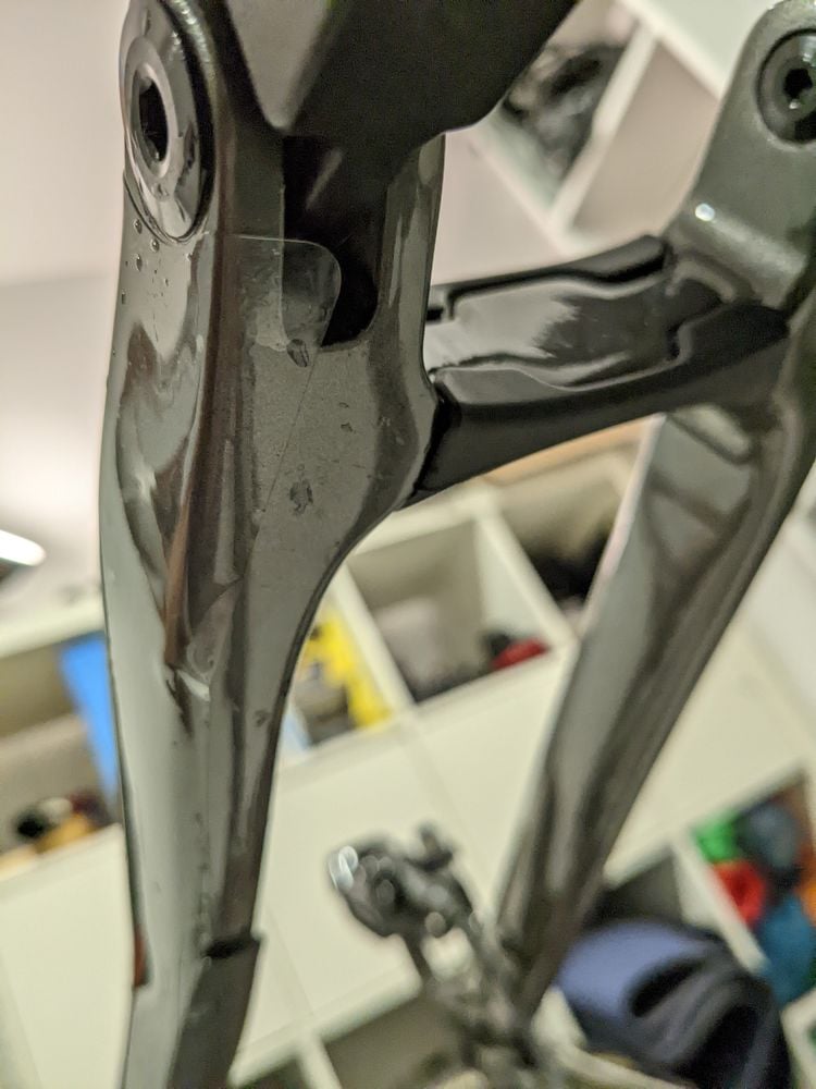

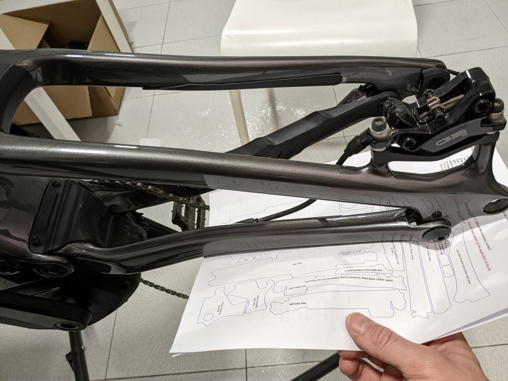

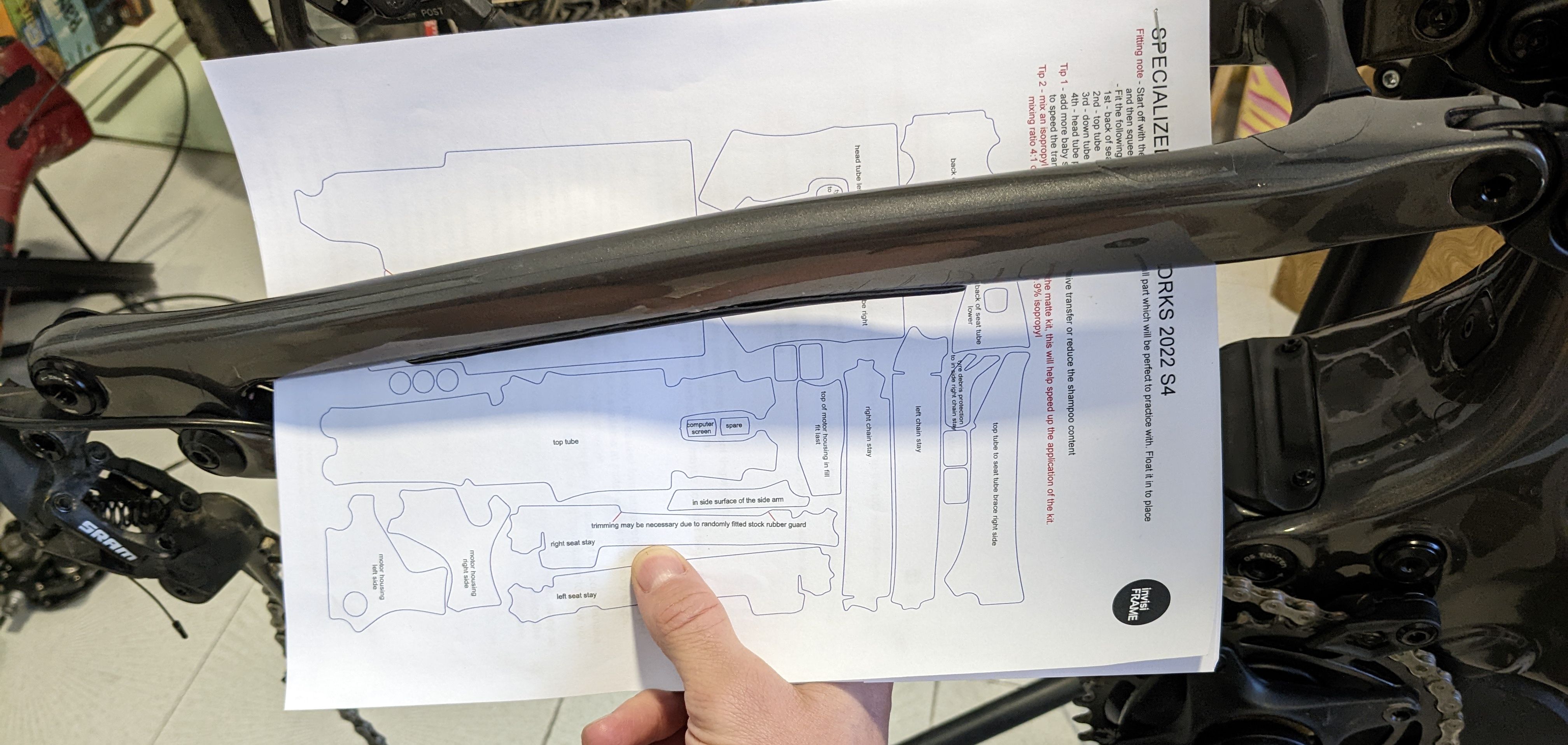

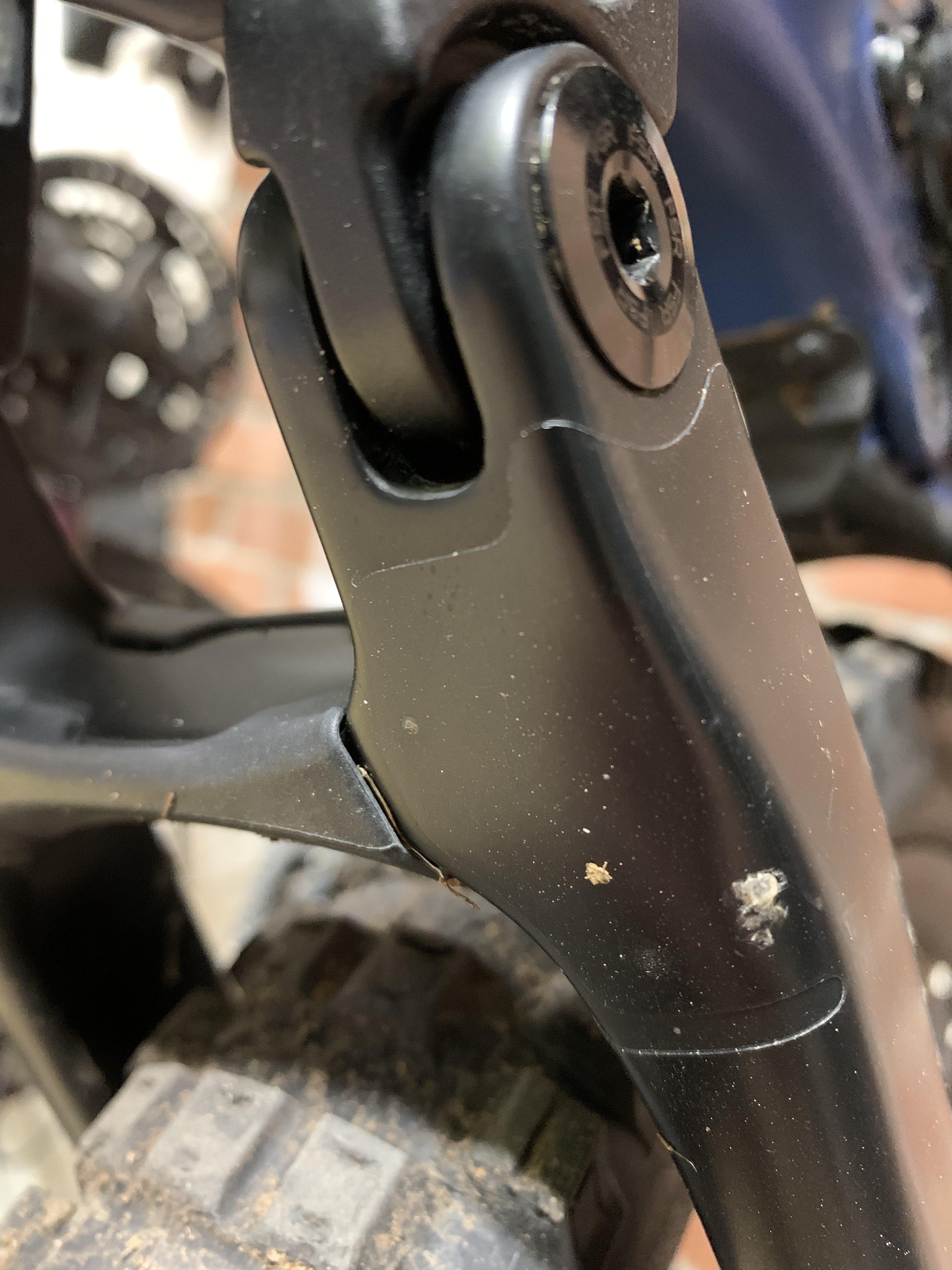

Anyone put Invisiframe ? I have some concerns.....
I had to use scissors in 4-5 places to fit that element... (right seatstay) ....

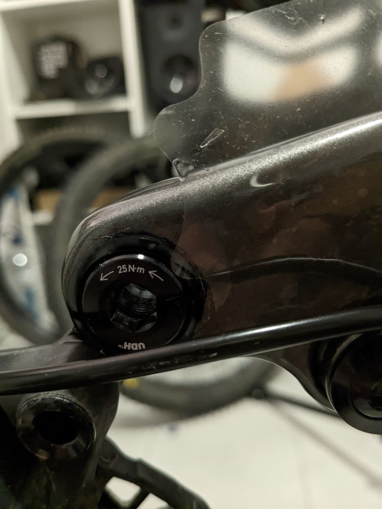

Left Seatstay - will it fit? no cutouts for brake mounts?
ok, so from that one deep cut, i see that maybe i should rotate that piece 180*

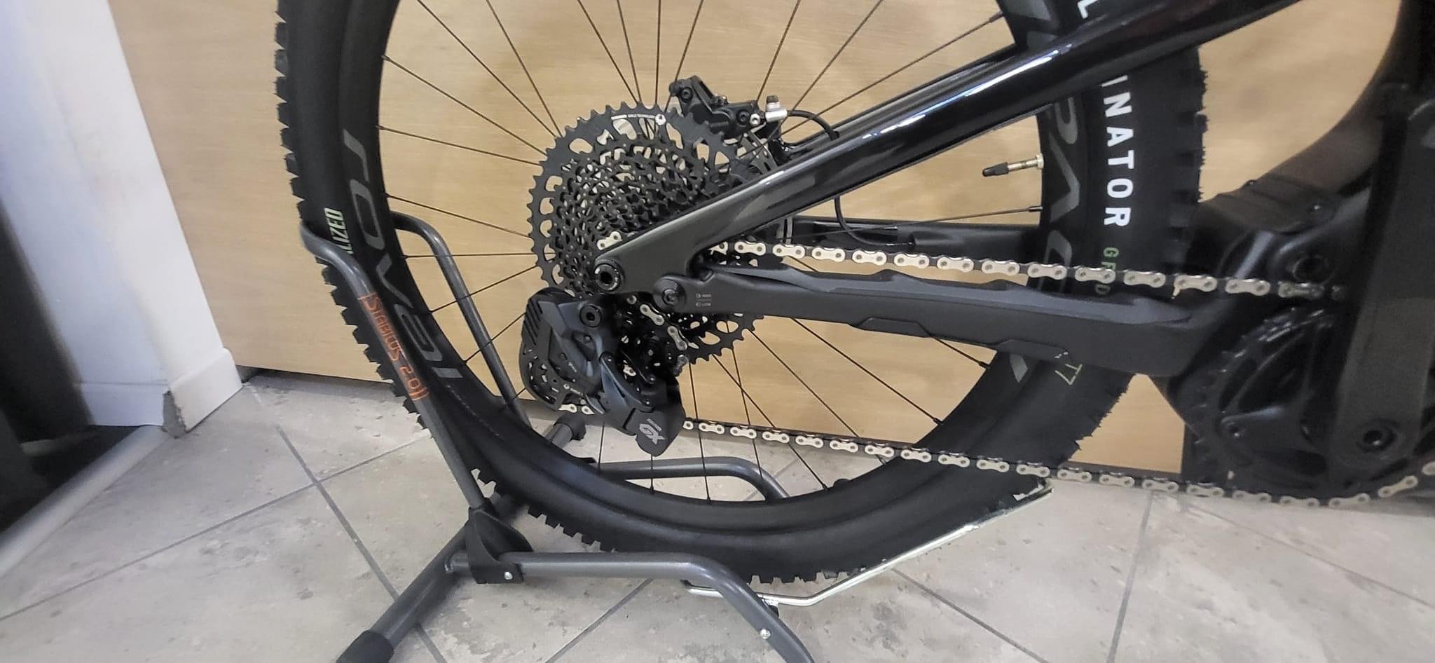

Does anyone know if i push my gear cable in at the top will it come out the chain stay is it all tubes in tubes or do you have to faff. I've got AXS but it's bent and pissing me off so going back to cable xo1

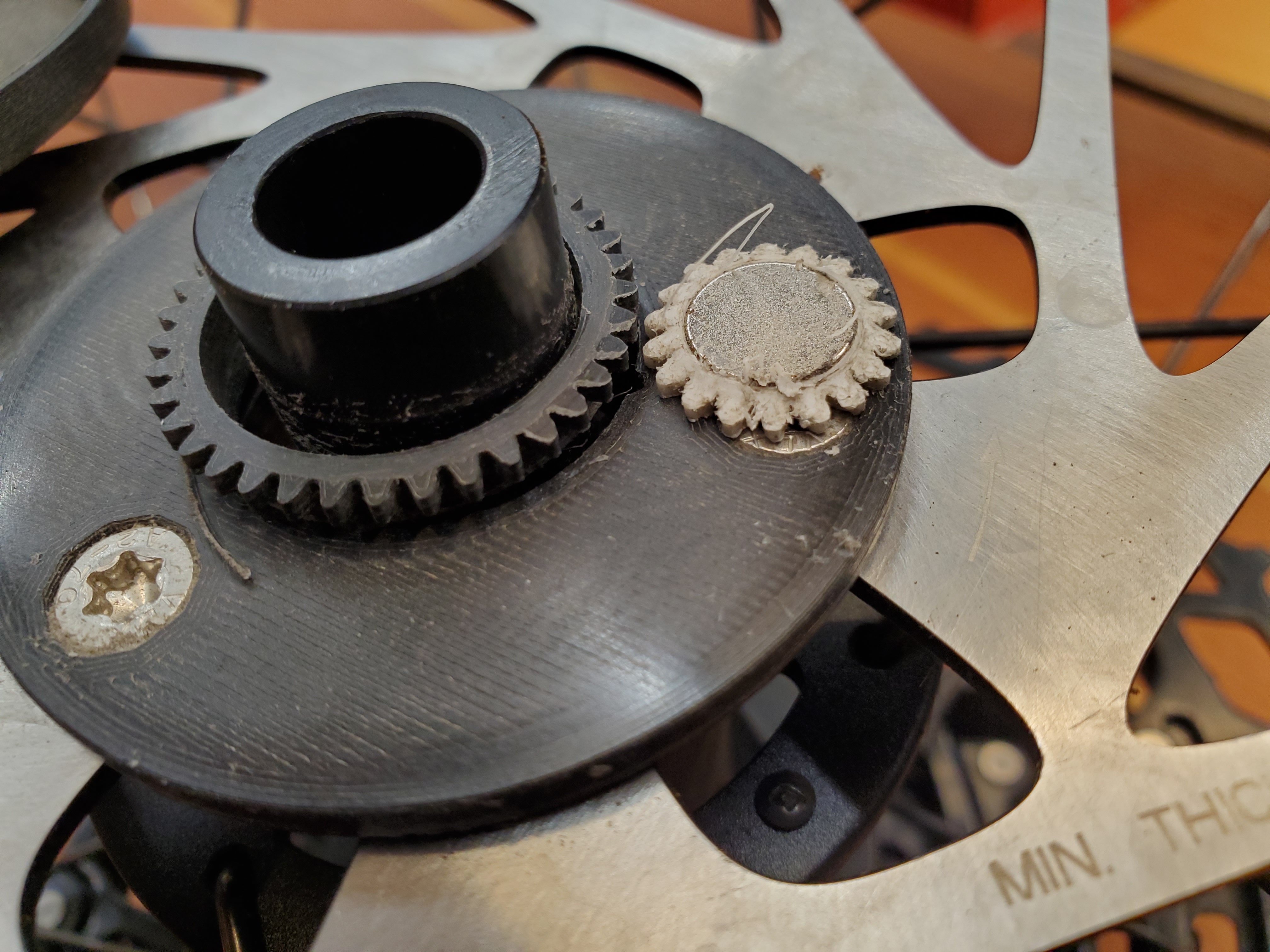

Guys, I rode some rock gardens today and after I came back down the hill the motor started cutting out. I have planet3 installed so initially I thought there was something wrong with the sensor, but then I realized that it feels different than when the motor cuts out due to the limiter - it felt more hesitant and kept going in and out. It didn't cut out at any particular speed, it just jittered on and off, although the bike remained on.
Any ideas why this might be? I haven't got a chance to check the sensor and the planet3 mechanism, plan to do that next, but just wondering if this rings any bells?
(22 Levo Alloy)
magnet too far away from sensor and intermttently being sensed...could have moved after the rock garden

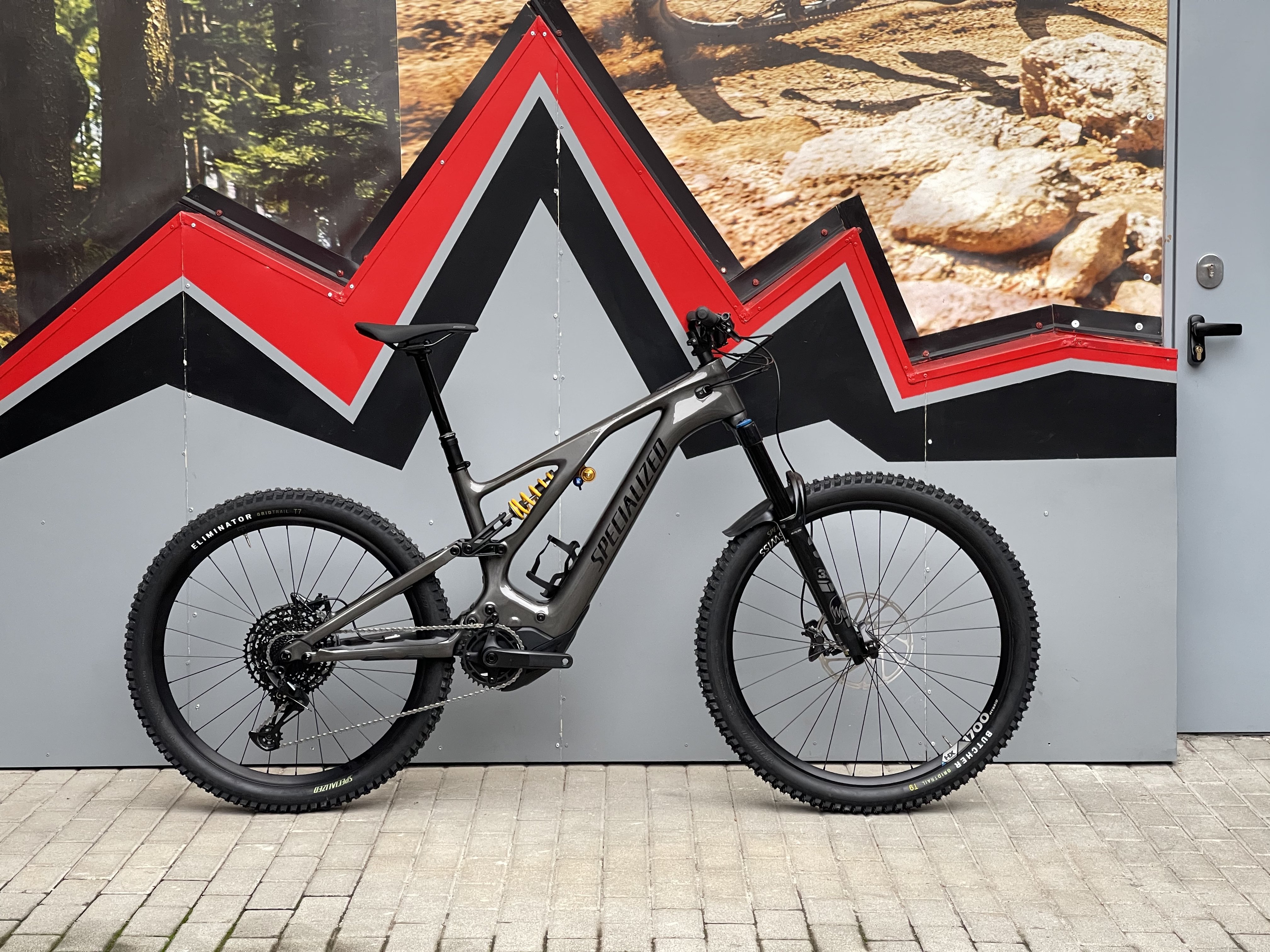

Sorry to bother you guys, but I'm a very happy man right now. Pulled the trigger on a new Levo Pro yesterday, gonna pick it up on Friday for its maiden ride.
Tested a brand new bike just out of the box, it was smooth, seamless, quiet and overall just great. Was in between full fat Levo or light Trek EXe, but the Levo is more what I wanted.

So just an upate, my planet3 mechanism actually disassembled itself, so much so that the center portion that sits on the axel separated from the rear portion of the housing and the teeth of the gear and the housing were a little shredded. I cleaned it up and reassembled and it seems okay for now.
