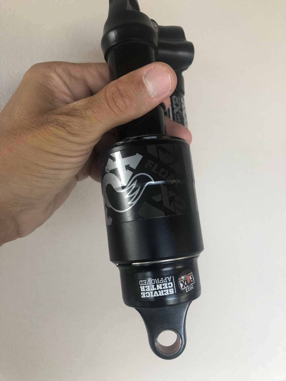

Salve a tutti! Chissà se è normale che la mia Fox X2 stia per entrare in servizio per la quarta volta! Non ne posso più! Ho avuto più problemi con questo shock che con qualsiasi altroView attachment 94605
There is some post regards this topic, i had the same problem in the past end change it with a coil shock
Of course you must ask for assistance and use warranty if you have

Well shucks, 2022 levo S Works was working beautifully until now, six months in use, but the X2 fox shock will no longer hold air. I have read of this happening to others. Didn't think it would happen to me weighing only 155 pounds fully kitted out, but I do ride aggressively. Still disappointed. Immediately ordered a cheap temporary shock so I can keep riding when it gets sent in for warranty work. How common is this? Others have said it is due to the design of the frame which flexes at the shock attachment points. Wondering if this is common knowledge?
I don’t think it’s the frame at all, it’s just the 2021+ Fox X2. I blew one up on my SB150 after about a month of riding, blew another one up on my new SB130 and the one on my Levo is already making a weird noise with 53 miles on it. I had the older version on a few other bikes without issues including my old SB130.
Yes, fairly common. Mine lasted 6 months. Swapped to a coil (11-6) and it’s so much better. No issues now.
