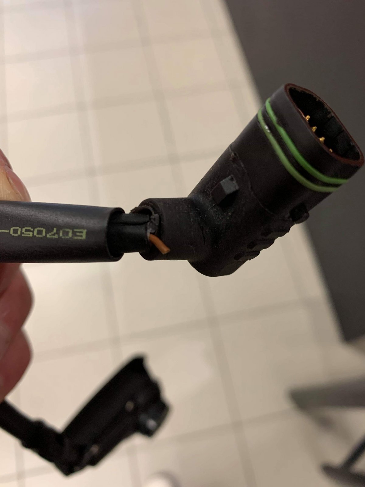

I had the same problem just as you describe it. The plug that came off the battery had an electrical cable damaged. Before this was found, I got a new engine and a new TCU which turned out to be unnecessary afterwards. Don’t look furthe. That’s your problem.

Thanks for the info. I'll take my motor housing off again and see if I can see the damage like your photo.

Got a new motor battery cable this afternoon and replaced it when I got home—everything seems back to normal! Turned the bike on and off a couple of times, flipped the battery door open/closed a couple of times, turned on every time.
I didn't see any visible damage on my old cable, but I could tell that the area under the heatshrink was much stiffer than the same area under the new cable. Maybe Specialized switched to a more flexible wire to prevent these issues.

Even before the motor end plug cracks as per the picture the bond between the cable casing and the plug comes unstuck and that leads to 2 potential problems. Firstly water ingress into the plug most especially from washing the bike, and secondly all the stress applied by the stiffness of the original cable acts directly on the point where the cable enters the plug. That can result in one or more of the wires breaking or shorting out against each other. Glad you sorted it.
