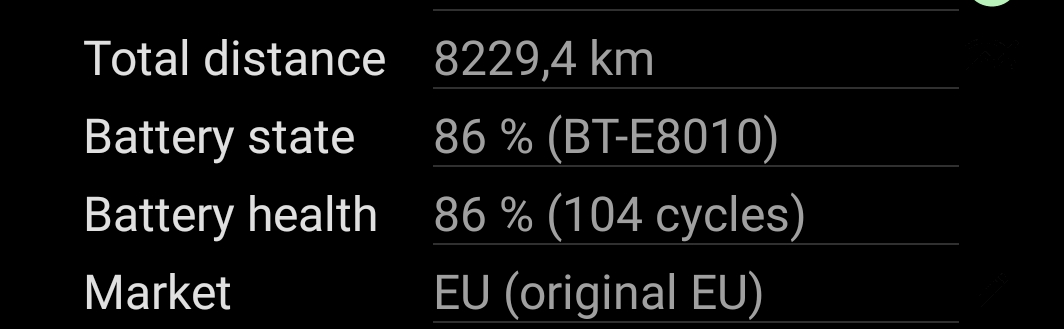

I have 9,856 km ( 6120 miles) on My BT -8020 and it holds at 86% , down 14% .
Degradation at this point has been about 1% /704 KM . or 1% per 437 miles
I never try to leave the battery fully charged ( L- ion batteries don't like being held at full charge ) over night but at 70 % and then charge it in the morning before the ride to full and then never try to completely discharge battery past 1 bar left.

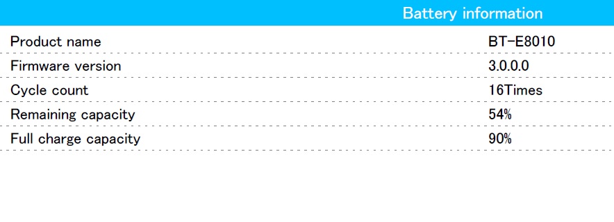

Just taken the bike in for a warranty job on the battery. Stunlocker was showing 86 cycles and 76%.
Their diagnostics show the battery is at 87% health, so no claim. Strangely, the battery happens to also have 87% charge in it. I questioned this coincidence, but they insisted it was definitely showing the degradation of the battery.
Shows up as 'remaining capacity' on the report if anyone has seen it before. No mention of state of charge on it.

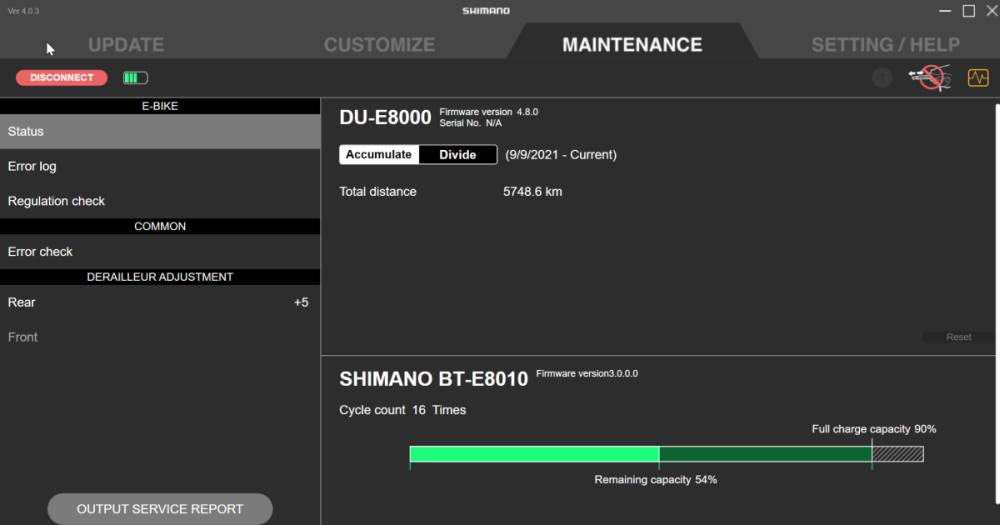

Look for a mate that has the box Shimano SM-PCE02, then use an older etube Version 4.0.3 that still has the Battery Health checking, print the report and send to Shimano together with the battery.

Thanks Spiff. I've just spoken to the bike shop, and they're going to have a play on some of the other bikes in the shop to see what the number means. I get the impression the shop isn't all that clued up on it all.

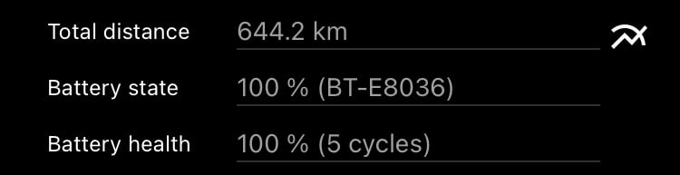

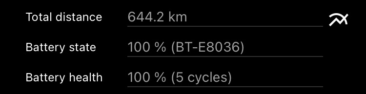

Delighted to report that I have 100% battery health after 5 cycles
I guess, it means that my average range is 128km per cycle, which should translate to full battery charge to empty.
