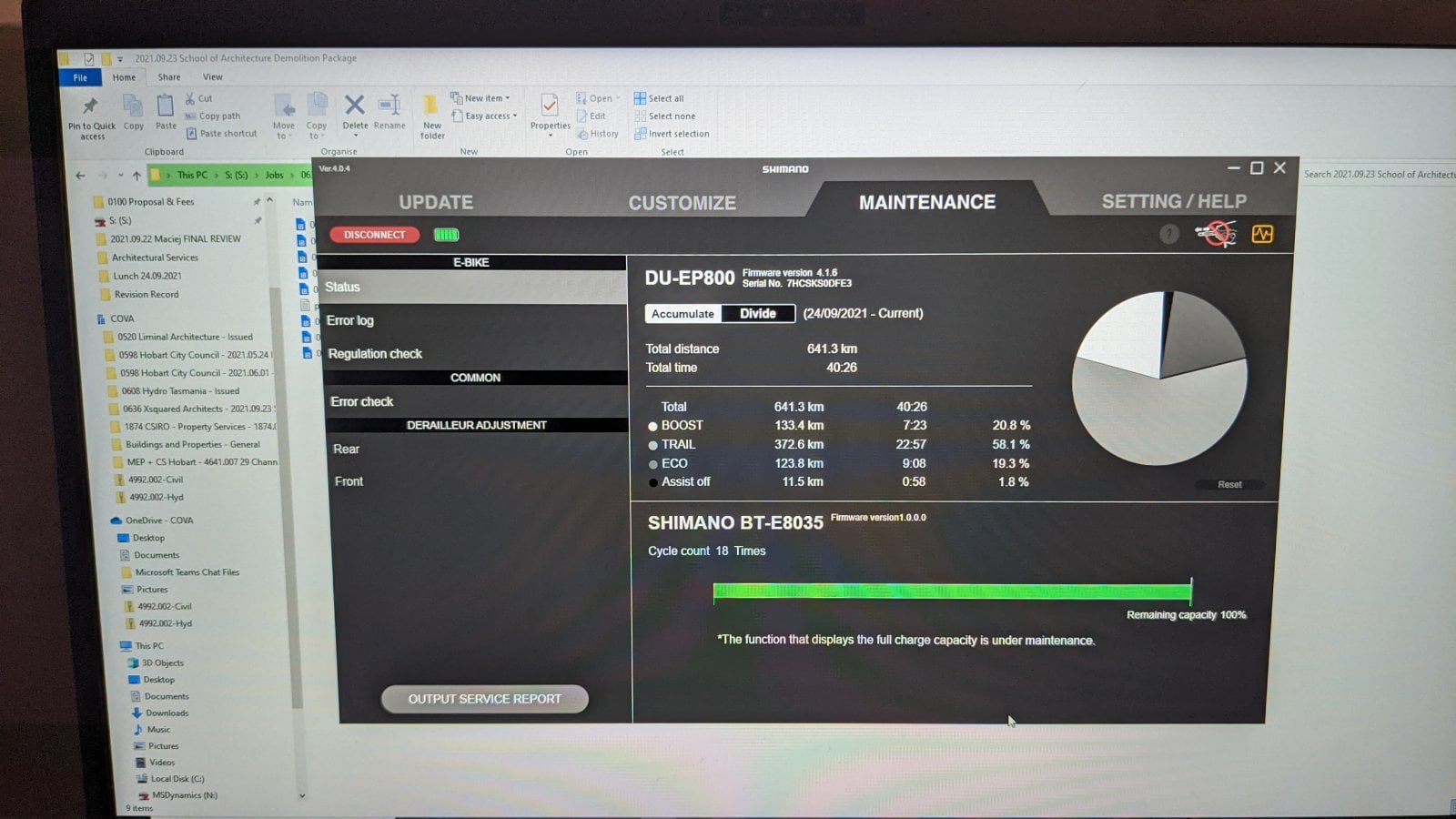

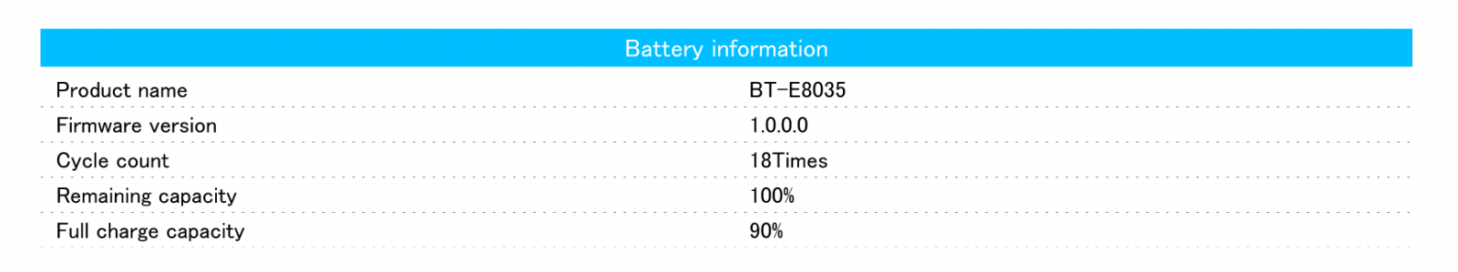

I tested my battery with Windows Etube versions 4.0.3 and 5.0.1, and:
** Etube V4.0.3 shows an image with FULL CHARGE CAPACITY = 90%
** Etube V5.0.1 DOES not show the FULL CHARGE CAPACITY
This is the "Mickey Mouse" fix from Shimano for their battery degradation issue: Instead of replacing in warranty the defective batteries that do not meet Shimano Specifications, they just remove the degradation test in the diagnostic. This is childish, I hope they do not get away with it.

Well what software is on your motor. My ep8 has the 4.1.6 and running v4 of the etube app I still can't see the battery degradation.

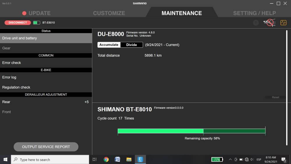

My motor is an E8000 at 4.8.0 (you can see it in the image), and the etube Windows is V4.0.3. I am using SM-PCE02
BUT your etube is V4.0.4, may be Shimano removed the degradation diagnosting starting your Version. Try to look for V4.0.3. Your etube V4.0.4 shows the message: "The function that displays the full charge capacity is under maintenance" , so for Shimano "Maintenance" means to remove it, ha ha

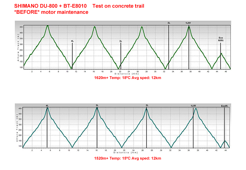

When my battery life went down to 81% life I bought a new one and made again the test on my range test circuit: a climb of 5.4Km (3.4mi), concrete al 7% rate , same bike, tyres, speed, gear, cadence, tyre pressure, same everything but the battery.
Range was increased only by 8% (total loss of range was 35% aprox) That was a BIG dissapointment for me, as i was convinced of the great degradation of the old battery.
The old battery at 81% life as stated by the Shimano App, only was giving me 8% less in range in comparison with a new battery.

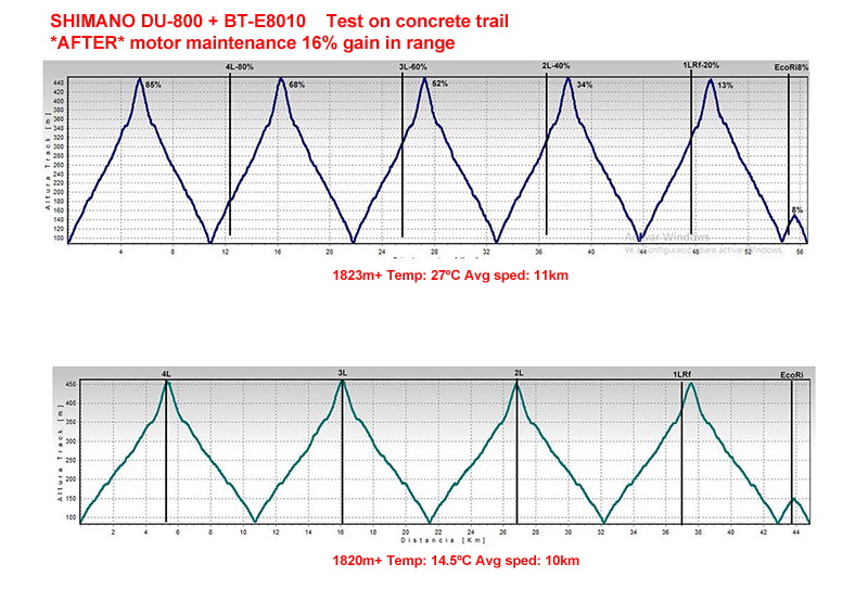

After much researching, the 2 main reasons for the loss in range were: motor degradation (16%), and activation of the light in firmware wich reserves energy for the light (12%) an detracts from the motor assit. In total 12+16+8 = 36%
The I focused on maitenance of the motor and disabled the light, ad yeahhh! the range was almost recovered, except for the 10% of the battery drop
Attached i have a test in range before and after motor maintenance with the same OLD battery at 83% life (¡yes the life has increased form 81% to 83%, who knows! that Shimano software for the life estimation is a piece of crap)
The ligh remains ON in this test, so expect another 12% in range increase with light disabled.
Mode ECO 60% assist, bike + biker = 105Kg
