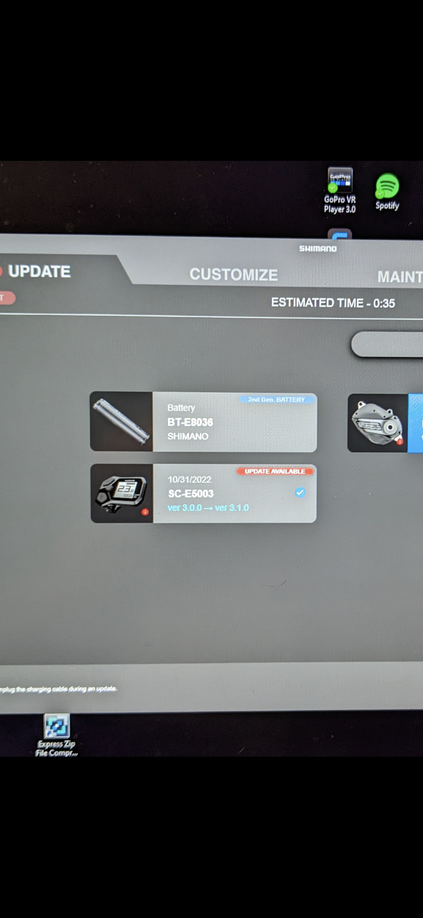

I'm sticking to the warning Stephane from commencal gave me a few years ago: don't ever upgrade the firmware if ya know what's good for ya!

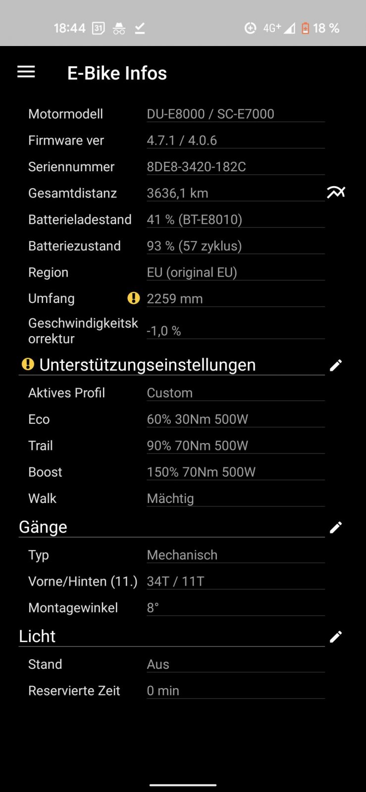

So now my battery from 2019 degraded to 93%. The mileage is actually a little more, maybe close to 4k km as I deactivated the motor on longer descents. I took this afte the first 5 rides of the season so idk when it jumped from 97% when I stored it in atumnd to 93% but its interesting that I didn't bother to drain the battery to 20-30% as I did in the last off-seasons. I think it sat aroung 55% or so from november till march. But I also hauled my sister again with the bike so this could also be the reason it degraded. Last time when it showed degradation it was when I hauled her.
