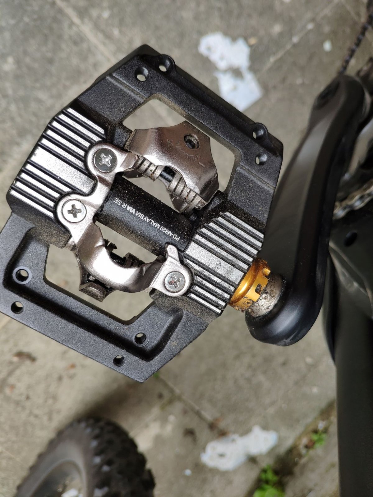

Little update: Shimano EH500 (Hybrid Semi) Click pedals and Shimano SH-XC300 shoes.
"You don't need that on a E-mtb" is true, but being fixed on the bike, I enjoy better manoeuvres, jumps,...
I always had size 43, but here size 43+ and 44+ were too small.
The size 45 fits good.
Don't forget one pedal has left tread !
I'm very satisfied with this combo
Shimano SAINT PD-M820
Shimano SH-AM9N
and you're absolutely right about shimano shoes sizing. Always +1 or +2.

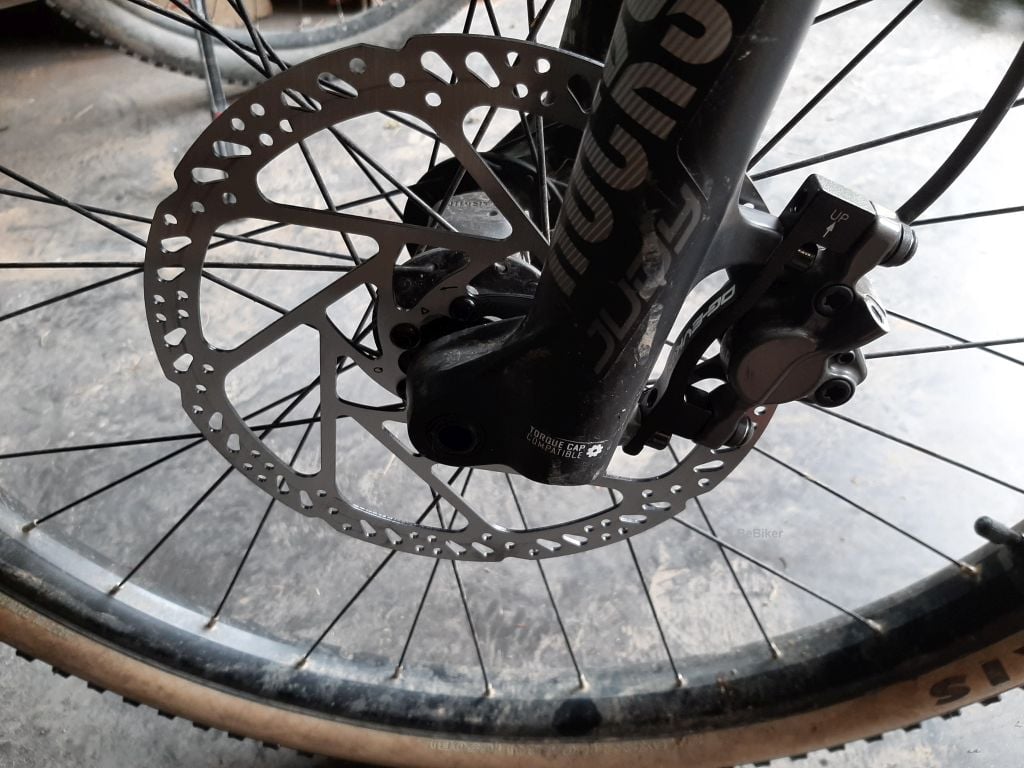

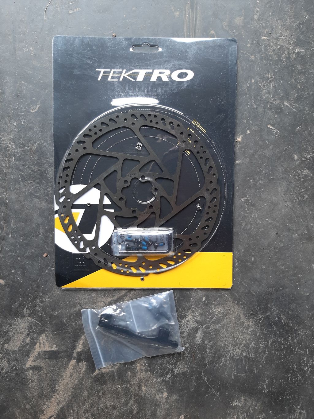

Another modification today: 203mm rotor + adaptor
BeBiker
Aug 26, 2020
663
404
Belgium

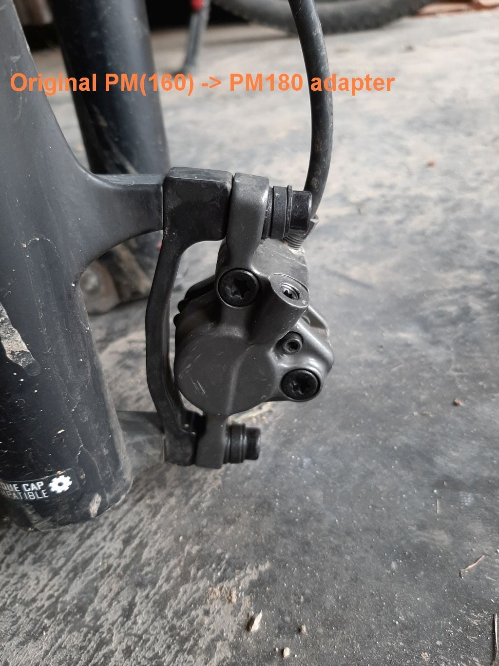

What I learnt is that there are 2 major brake caliper mounting systems: PM and IS.
It's the orientation of the holes to fix the caliper.
Our bikes have the Rockshox fork, with PM at the front. (bolts parallel to the wheel, tangential)
The back is IS (bolts going towards the wheel, axial)
Now our Rockshox fork has a PM mount for 160mm disks.
That's why there's already an adapter (160 to 180mm) between the fork and the caliper to fit our 180mm disks.
The names used are often PM160, PM180, PM203, where PM without number stands for PM160.

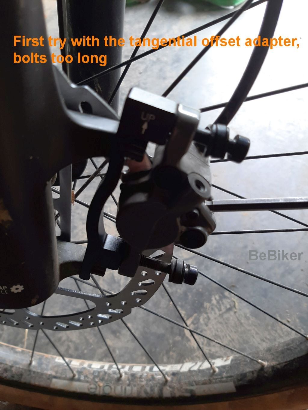

To fit the 203mm disk, you can choose to fit a second adapter (PM180 to PM203)
or to replace the original (PM160 to PM180) by a new one (PM160 to PM203)
The result is this one: PM-PM-F/R203 (product name AP002 here)
The adapter isn't very much higher as the original one, but has a bolts hole offset that moves the caliper tangential.
Fits perfectly!

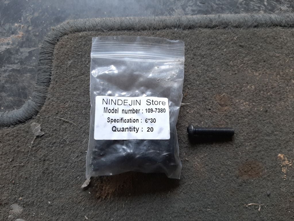

There are 2 bolts in the pack, but you need 2 extra M6 30mm bolts, our original ones are too long.

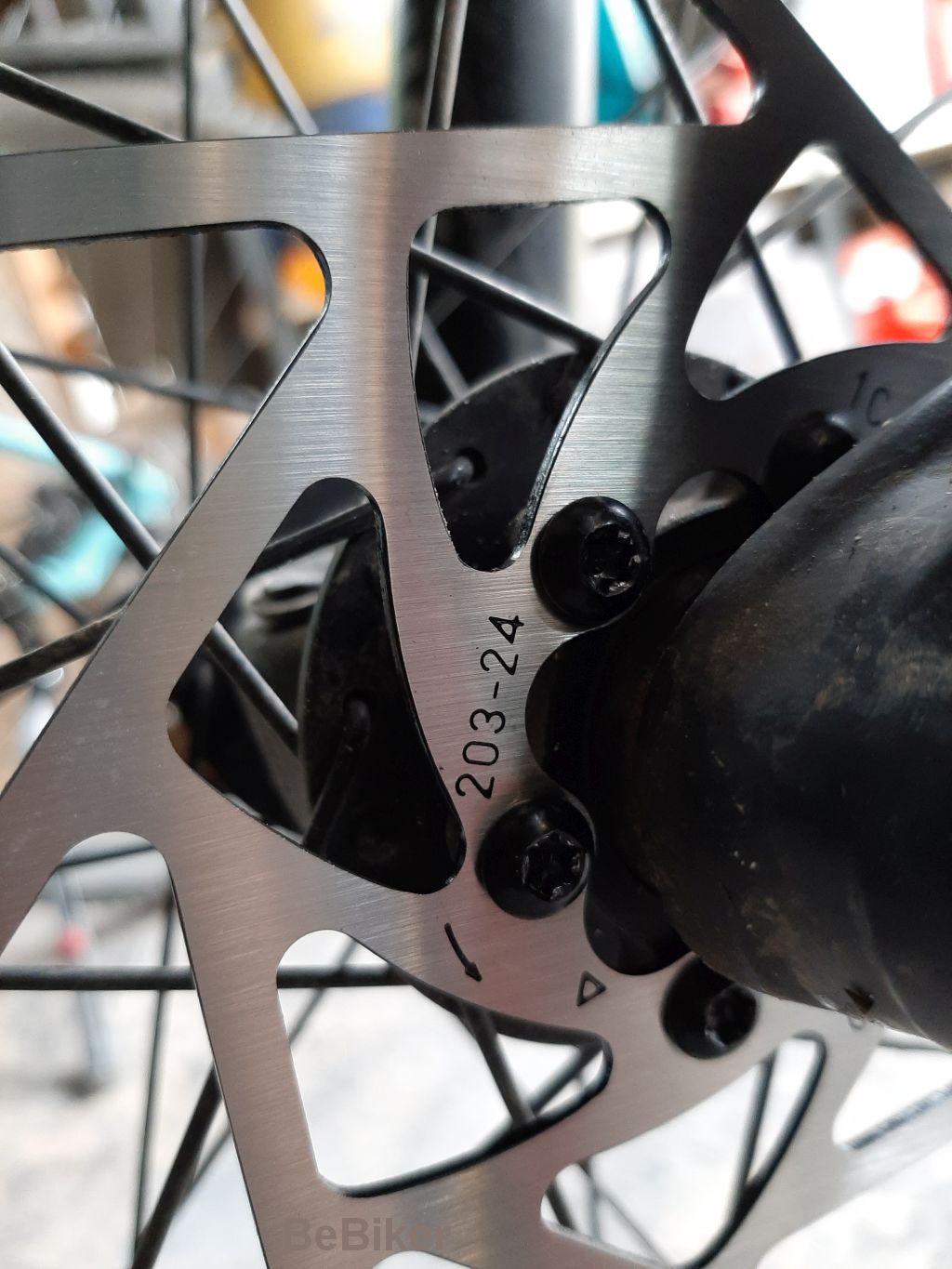

This is the disk. I chose Tektro because the original one has that name too, and works good.
The name of the product was tr203-8, but the picture was tr203-24.
What I received is tr203-24.
I don't know the performance difference, looks OK.

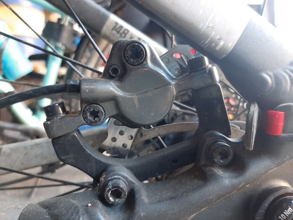

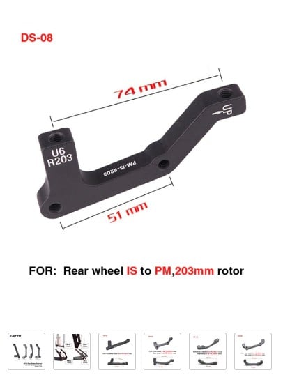

To be continued,... this is an image of our original IS to PM adapter at the back:
And this is an adapter that could fit: PM-IS-R203
Let's spend another 20euro
That's exactly what I did

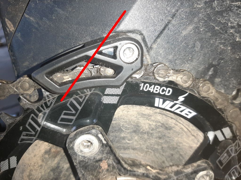

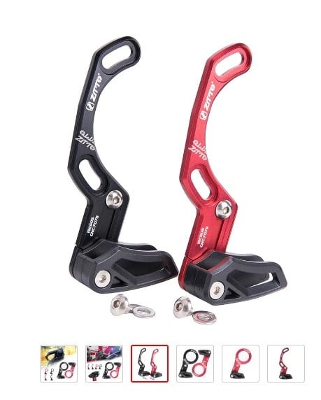

Some may remember Page1 where I was trying other chainrings.
The original 34t is definitively too short, 42t is the maximum but the chainguide doesn't fit, so I installed 38t.
Now I ordered this, and installed the 42t chainring again.

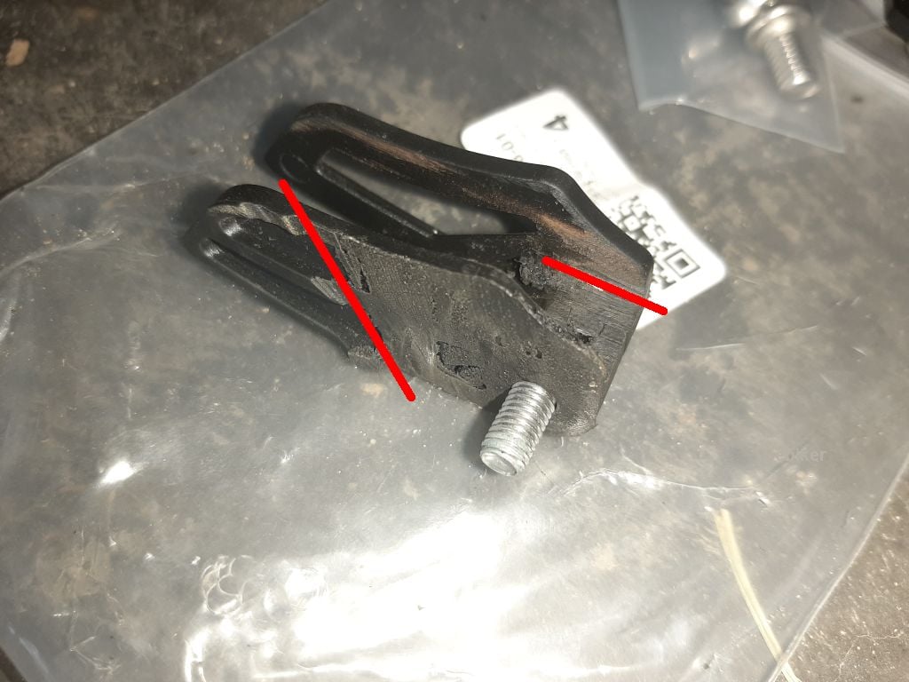

Forget about the metal parts, I took the plastic part and grinded some material away at an angle.
Fits on the 42t, +1mm air everywhere !
The bolt is the one in the box of the new chainguide, fits perfect.
Here you see why I grinded material away at an angle at the chainguide..
It's the angle of the bike's plastic housing, even with the bolt somewhat loose, it won't fall.

What I intend to do with the 42t isn't really increasing top speed, but lowering cadance at my current top speed.
10s is way too much for an Emtb, so I'll use the 11t as an overdrive :)
Future, compared to my current 38t setup:
(50/42) * (38/42) -1 = 7,7% shorter shortest gear ratio
(11/11) * (38/42) -1 = 9.5% longer longest gear ratio
...................................................\_--> more spread
Future, compared to the original 34t setup:
(50/42) * (34/42) -1 = 9,6% shorter shortest gear ratio
(11/11) * (34/42) -1 = 8.1% longer longest gear ratio
My current 38t compared to the original setup:
(42/42) * (34/38) -1 = 8.9% longer shortest gear ratio
(11/11) * (34/38) -1 = 8.9% longer longest gear ratio
...................................................\_--> only longer
With the 42t chainring, and the 11-42t cassette, the shortest gear ratio became a bit too long for steep climbs.

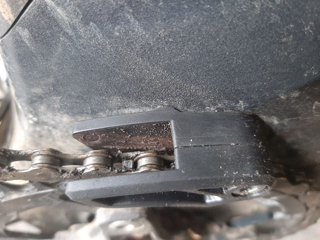

I also wanted to put a 42 chainring but I found then easier to modify the inner metal support of the chainguide and to grind a bit of plastic of the carter to increase the range of the original chainguide settings. Anyway. As always, you found the way to upgrade your bike and our mechanical experience. Thanks, once again.
By the way. Did you find your new longer chain already ?

...I found then easier to modify the inner metal support of the chainguide and to grind a bit of plastic of the carter to increase the range of the original chainguide settings...
I never opened that case.
Can you post some images, because the original chainguide looks a bit more stable than the Aliexpress part.

Here are some images of my bike
I want to increase the spread. Original Shimano it's 11-42t.
So going to 11-46t 11-50t or 11-51t are the possibilities.
Are there problems with the 50t ?
Not at all. I forgot that you have sometimes a trailer. an hanger. Is that the metal piece that it's fixed between the axle and the derailleur to increase his amplitude ? I read on aliexpress some negative comments about this.
I didn't put the 42t yet but when I put the 38t I
Oups ! I didn't put the 42t yet but when I put the 38t I noticed that there was a square metal plate inside the carter who "slide" in a certain range. If you grind the plastic stop and a bit of the carter then you can increase the range of the chainguide.
