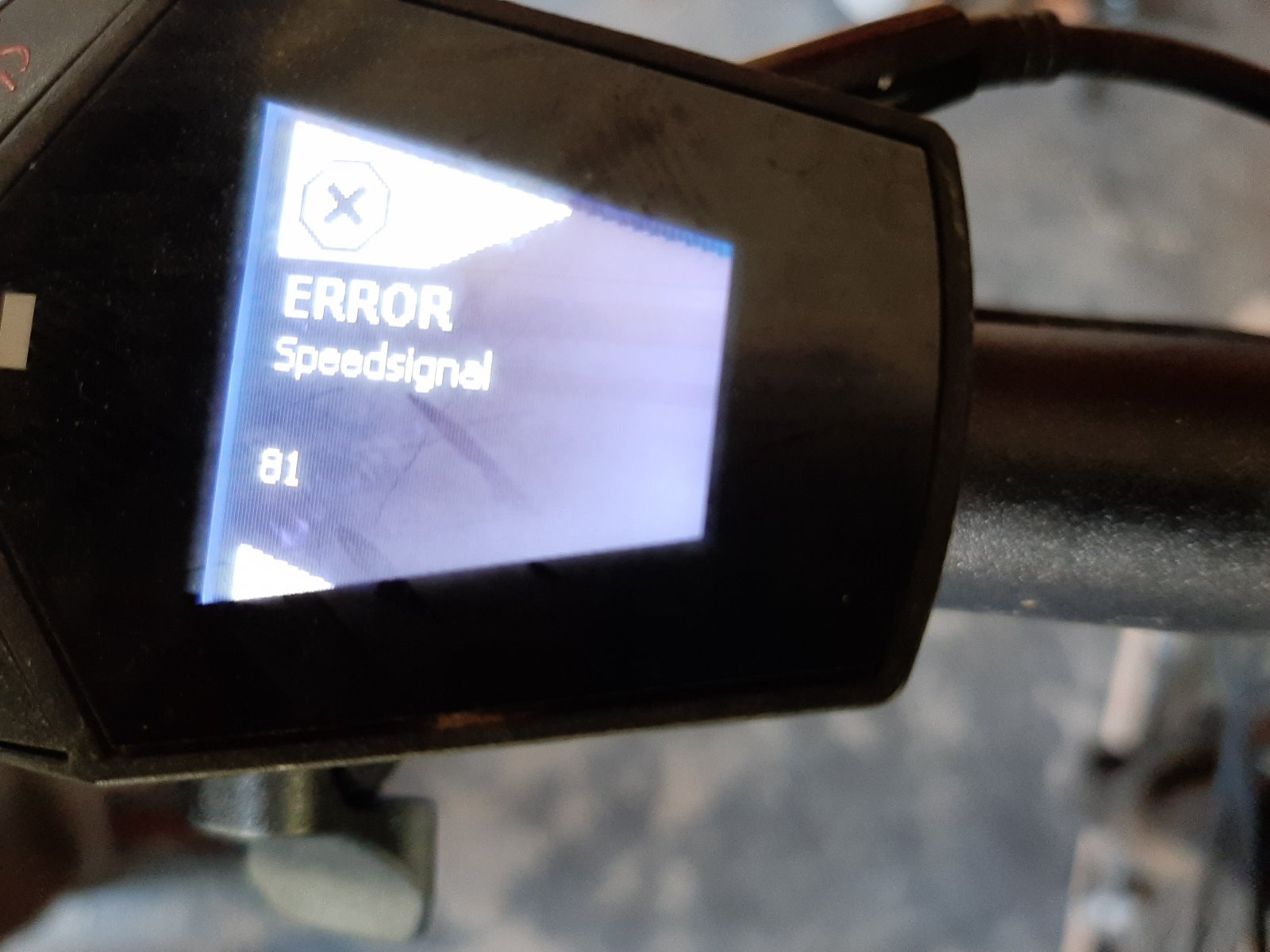

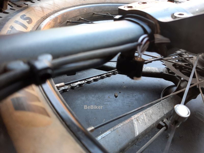

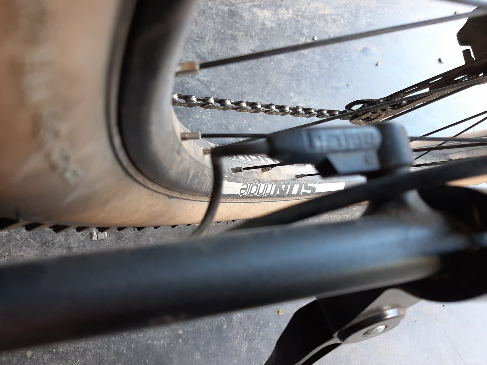

And then we got a branch between the wheel and the sensor -> sensor twisted down, propably breaking the sealed cable.

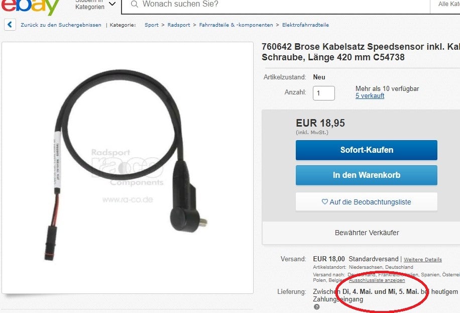

-Decathlon service: We will order it now, propably we receive it in 5 days and then you ...
-thank you sir I will get back to you ifI can't find it somewhere else.
The uk and ie sites have a lot of spareparts online, but they refuse to ship to Belgium !!!

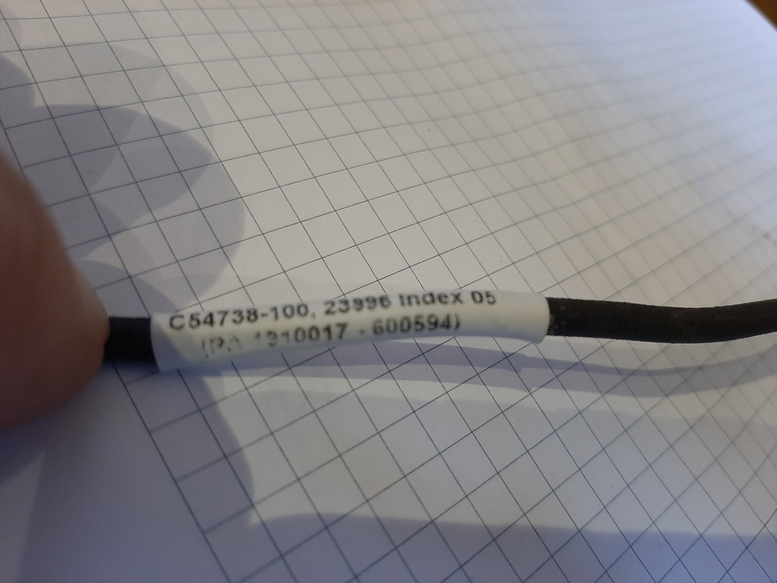

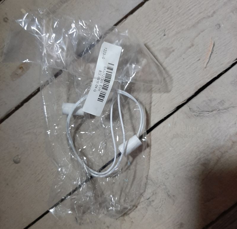

It wasn't the cable that was broken, but the inside of the sensor block that doesn't work anymore.
Instead of waiting 5 days (which always means +10days), let's do what McGyver would do:
Some cheapo Home-alarm magnet switch:

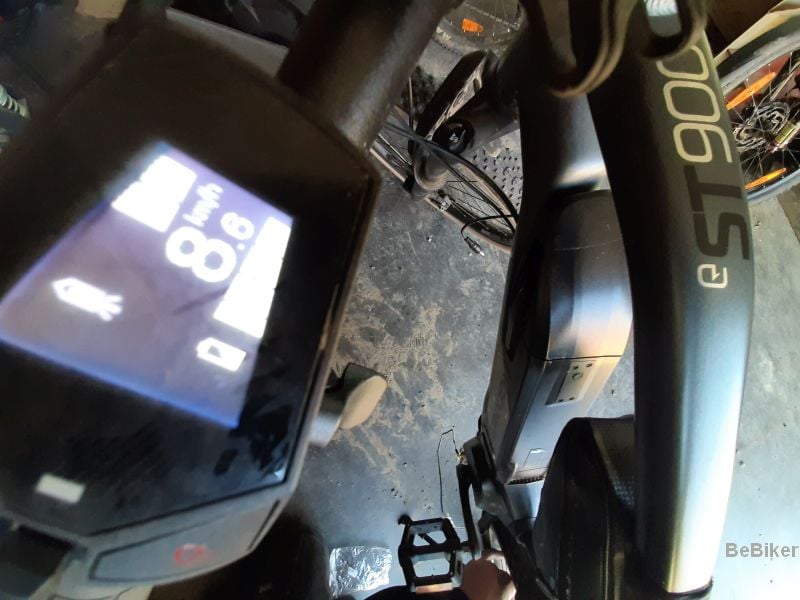

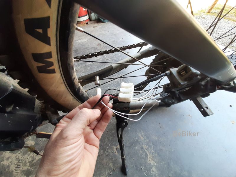

A little fast test:

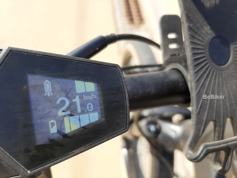

works !

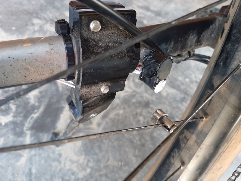

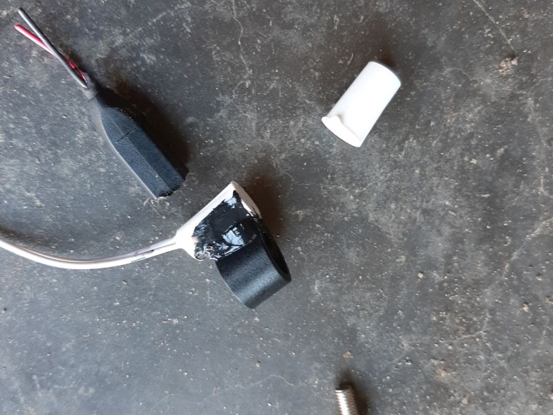

Lets "integrate" the "solution"
Under:
Above:
Test on the road !
The test was 2.73km, so the "door" opened 1200 times,
not sure if this solution will last very long :)

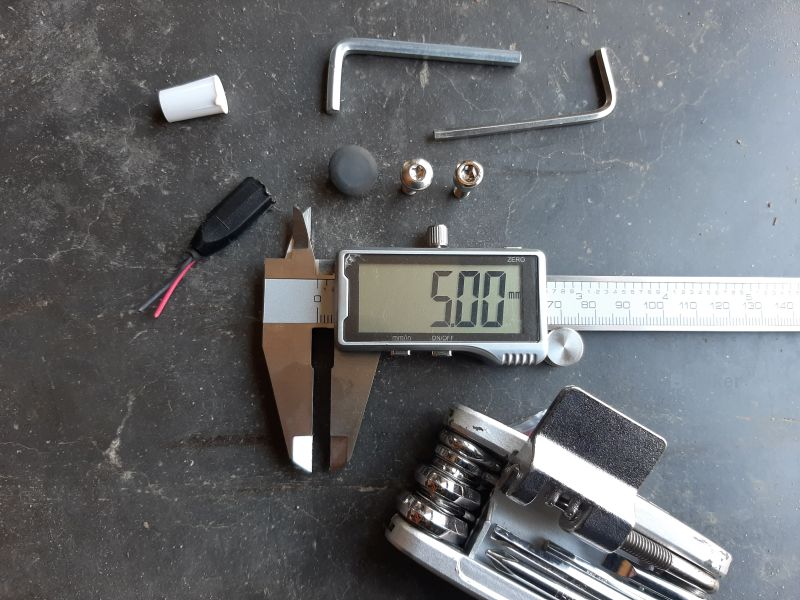

An advise for other E-st900 riders: Remove the Torx that holds the sensor, and replace it with a normal (bottleholder) allen key M5
@BeBiker Thanks again for your tips and I confirm that Mc Gyver is not dead ! It may not look very nice but I had already thought of protecting by taping the sensor and the wire with the frame together. By the way, my Bikespeed RS is working fine now. A simple loose connection. A huge difference !
Strange, it's the only torx I found till now on the bike, Allen Key everywhere...

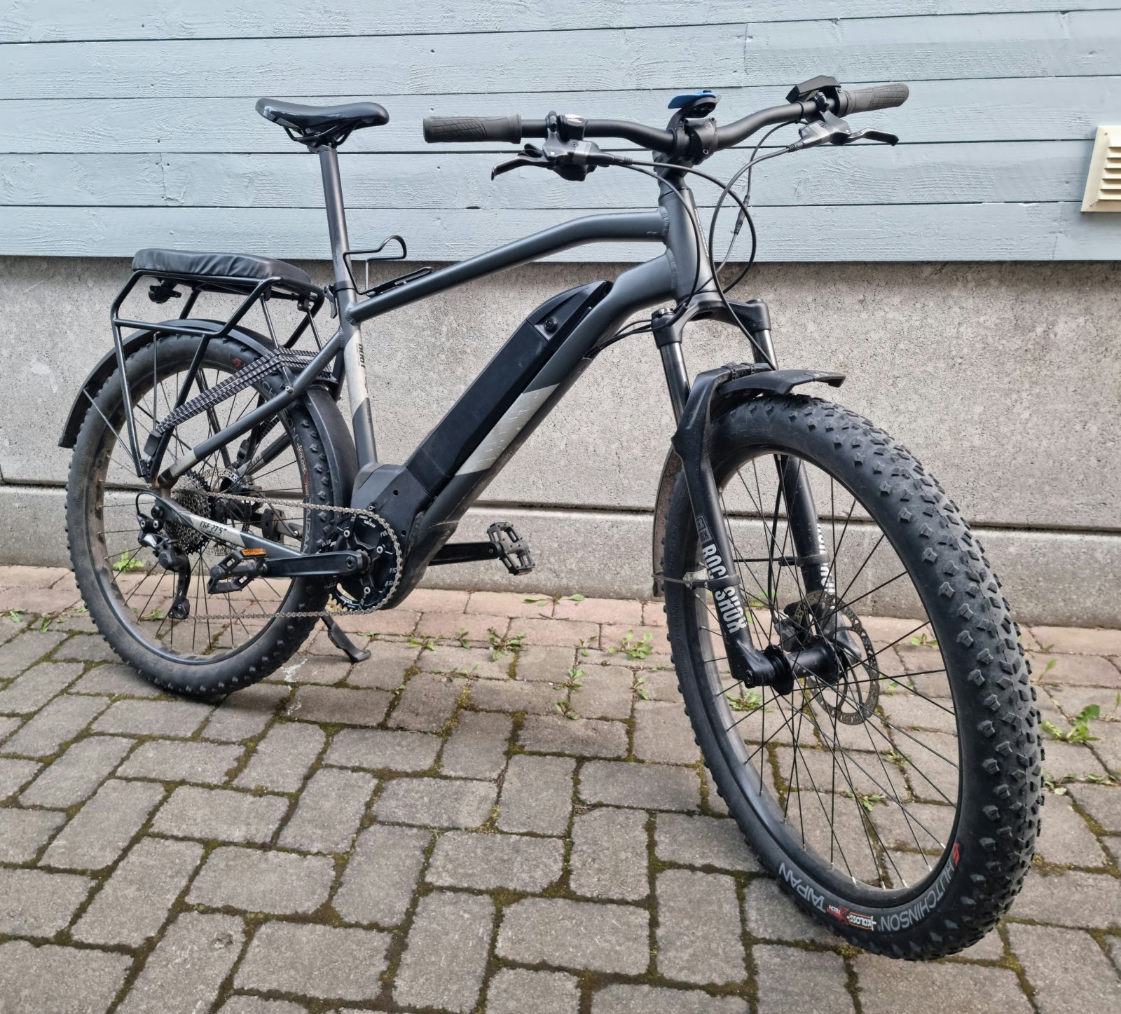

Great work postning your progress Bebiker! Had major problems with the casette skipping on both the 11t and 13t replaced that and the chain ring with the 42t you tried yourself and it feels like a new bike. I use mine mainly as a commuter so also got some wide SKS mud guards and the fat rack for the kids.

The rack and the mudguards make it completely trekking style, all it needs is an additional rack at the front.
I guess this is your spare battery, I don't see any stickers on it.
Great job. I suppose as BeBiker suggested that you put a longer chain because of 42t chainring. I hope you 're a tall man or at least that you have long legs because of your bottle mount position ?

Cheers to that Gary :) I actually didn't replace the chain I was able to tweak it and utilise all the gears with the original chain +42t chain ring! Works a charm!
I do wish the bottle could be mounted somewhere else though!
