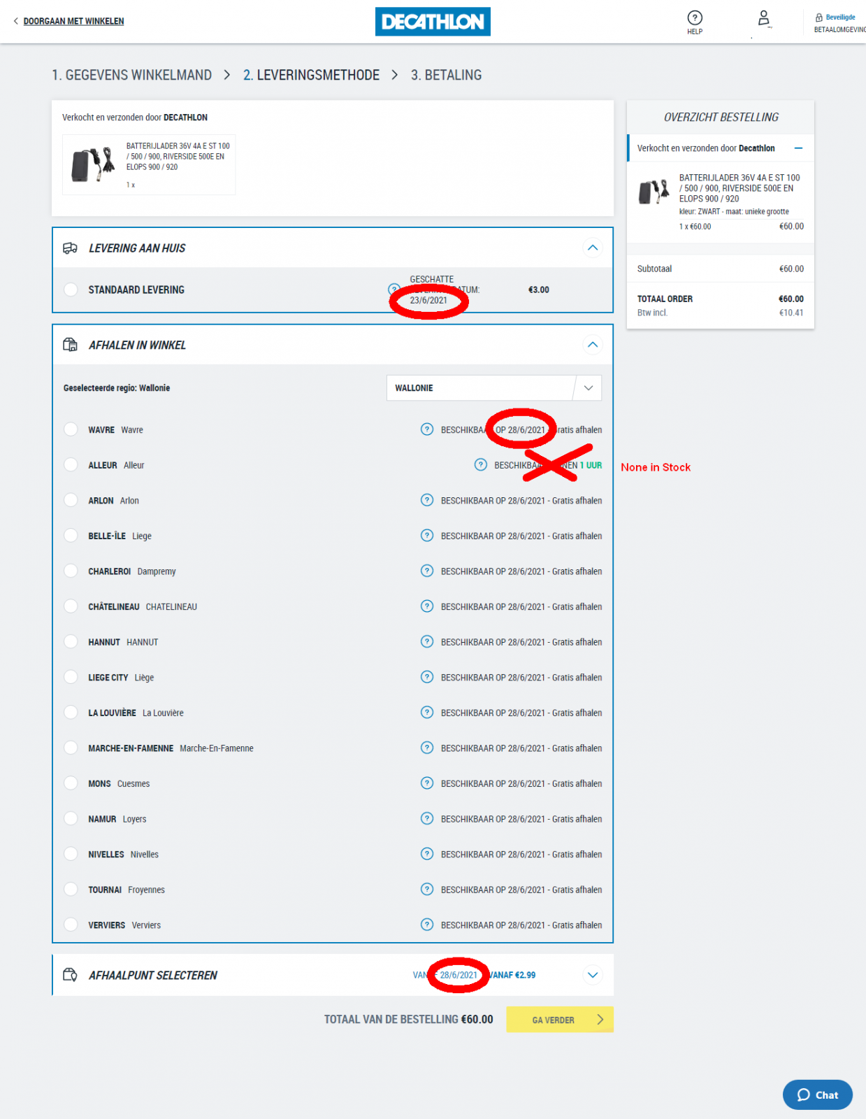

Battery not charged in the morning ???
Suddenly the charger doesn't work anymore !!!
The Led indicator on the charger also doesn't lit anymore.
The "charging" bargraph on the battery does nothing.
On the 2nd battery: same effect.
Their "solution": Bring the bike + battery + charger, we have a delay for the warranty diagnostic of +1 week, then we will order a new charger.
So I just want to buy and pay a second charger. ---> no stock, delay 2 weeks.
I think my Decathlon Rockrider E-st900 story ends here.
Let's see how their "Free Payback till 365 days" works.

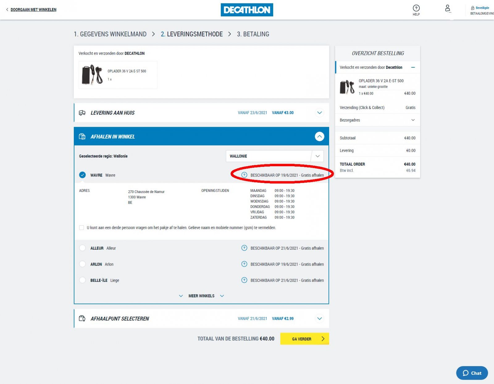

Well there seems to exist a weaker charger, 36V 2A, for the more "budget" E-st500 (8527799)
My 36V 4A charger (8555706) is marketed as compatible with the E-ST 100 / 500 / 900 Elops 900/920 so my double-reverse logic says the weaker charger wil not cause problems on my bike.
They even market my 504Wh battery for the E-st100 (380Wh) st500 (420Wh) without advising my stronger 4A charger, so...
As always, the online shop stock is wrong, available nowhere.
Except this one can be ordered online, DELIVERY 19/06/2021 !!!

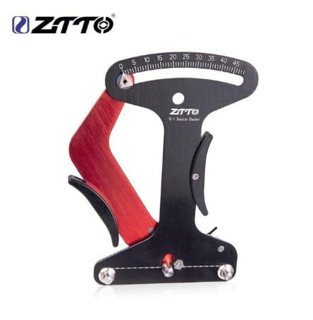

Today i took the bike for a proper ride. Im impressed but confused. I started to hear spokes rattling when stopping. Louder from the rear tire, and less from the front. Is this normal?
Yes, never did it before. Watched a Youtube video and GO !
The main trick is:
1) first tighten them all to some minimum tension.
2) then make corrections to pull your wheel straight.
3) then tighten the others to some higher tension.
4) go to 2) til it's ok.
I think I did 4 iterations.
I didn't use the tension checker at every spoke.
After a while I got it "in my fingers" and used the tool sometimes on some spokes to re-calibrate my fingers :-)

So I got the weaker 2A charger, works fine, full charge is approx. 5 hours.
The weight is considerably less than the 4A, so much better in the backpack.

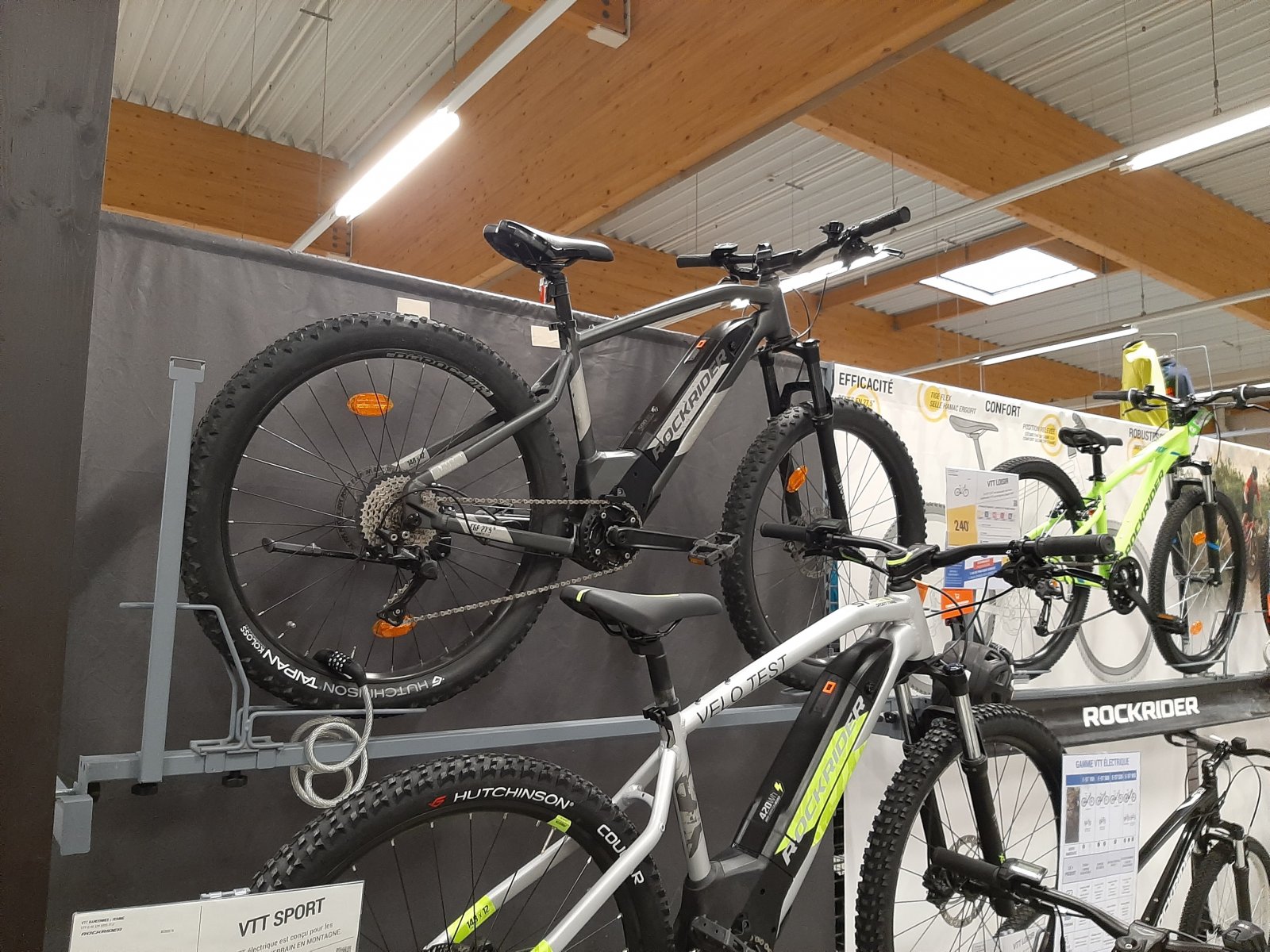

I regulary visit that Decathlon shop, first time in a year I see the E-st900 there.
Could it be a returned bike?
There's plenty of grease on the chainring, has the old HMI, has a bike stand bolted on,...
